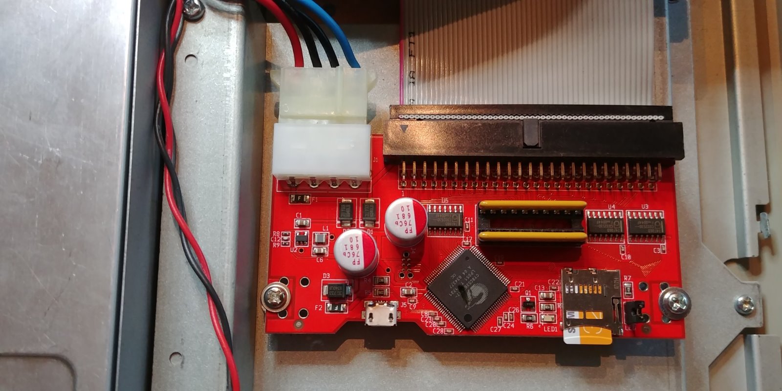

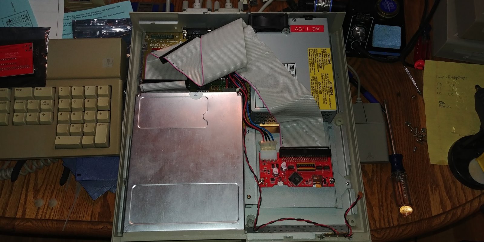

Second HD in a Mega File 44

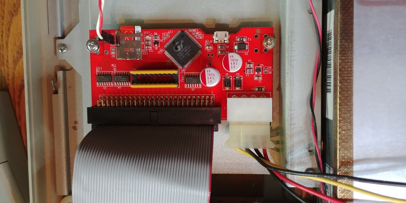

As you may or may not know, it is possible to add a second hard drive to a MF 44. I had made the modification previously on the units I am upgrading today. It had a 320 MB hard drive installed. I never liked that I could not mount the HD to the bracket provided by the MF44 properly. I tried a couple of things like a 90 degree power extension. I also tried to solder the power directly to the HD (that HD no longer works, LOL).

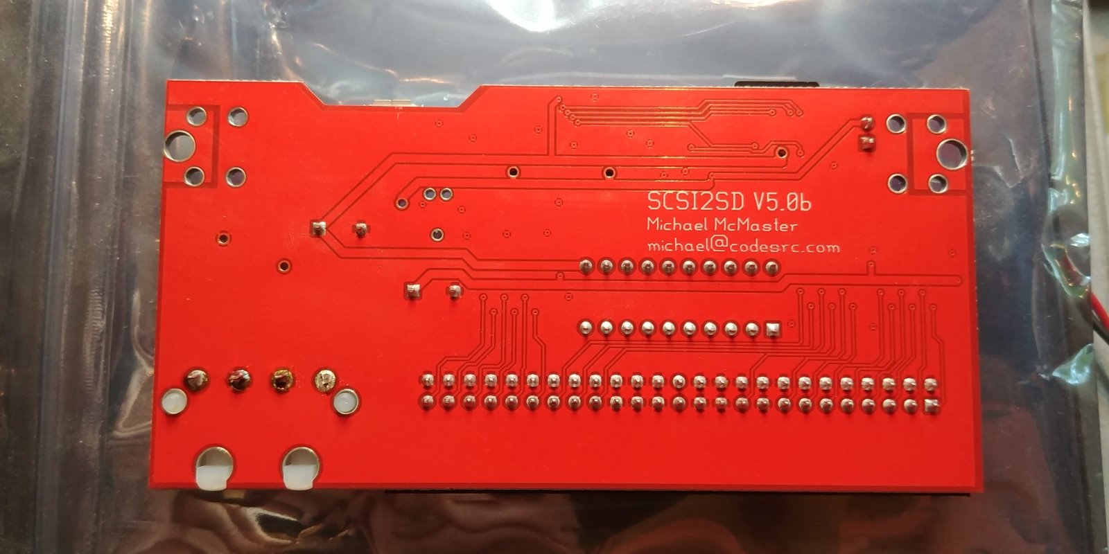

So last week I was rummaging through all the upgrades that I wanted to do and found 2 SCSI to Micro SD adapters. I added the adapter to the MF 44 this morning. When formatted I ended up with only 1 gig available out of 32 gig. I believe that is the limit on the ACSI port, oh well.
I have had these for so long there are newer versions made and they can be purcashed from 4 different places.

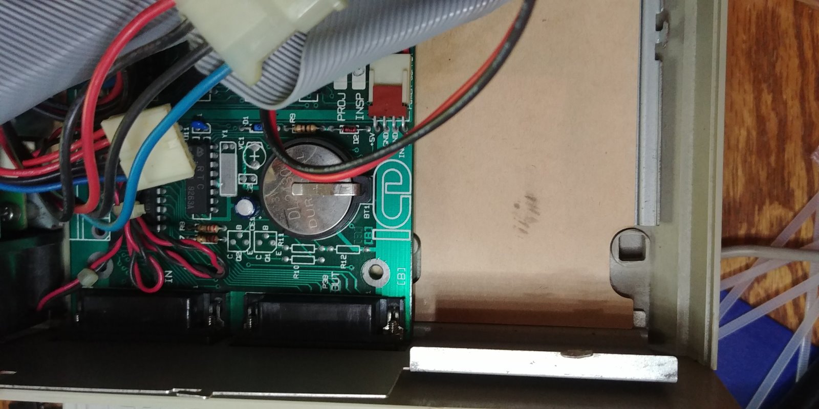

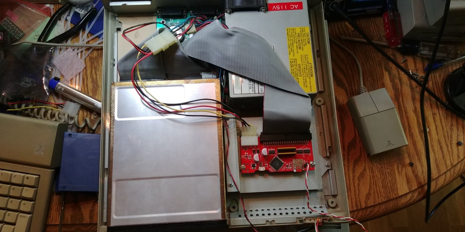

Second Hard Drive for Mega File 44: Set #2.
Even though this one worked when I got it, it was really done badly. It already had a second drive upgrade in it, a 200 MB Conner. I got it very cheap along with a Mega 4 that didn't work, which was really a Mega 2 board upgraded to 4MB and put in a Mega 4 case. I think I paid under $200 for both.
1. first thing was the Atari motherboard was removed and an ICD AdSCSI was installed. No big deal there except it was being held in by 1 screw on the DB19 and no place else, so it moved. I am not sure what they are called, but I took some PC video card screws (the ones used to screw in a cable to the VGA connector) and added three of them to the AdSCSI to secure it down. When I did this it was touching the PS metal screw down tab. I bent that tab up and out of the way. The PS would still be held by one inside screw and two outside screws so no big deal.
2. The power lead to the HD had the Molex plastic removed so the wires were individual but would still plug onto the male posts of the HD. Electrical tape was used to keep them separated. The HD was mounted to the bracket though. I found another Molex and took the plastic off of it and fitted those wires back into that plastic to make like the original again.
3. The SyQuest drive looked a little dodgy so I replaced it with a NOS one I bought recently.
4. Soldered on an lead to attach to the SCSItoSD So I could see HD activity on the MF44 LED.
The rest is the same as Set #1

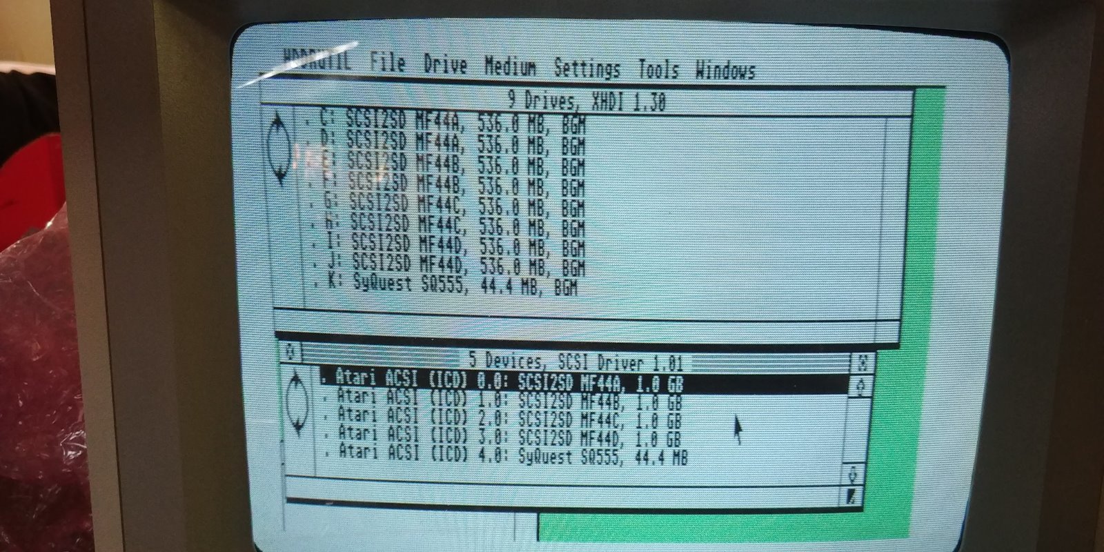

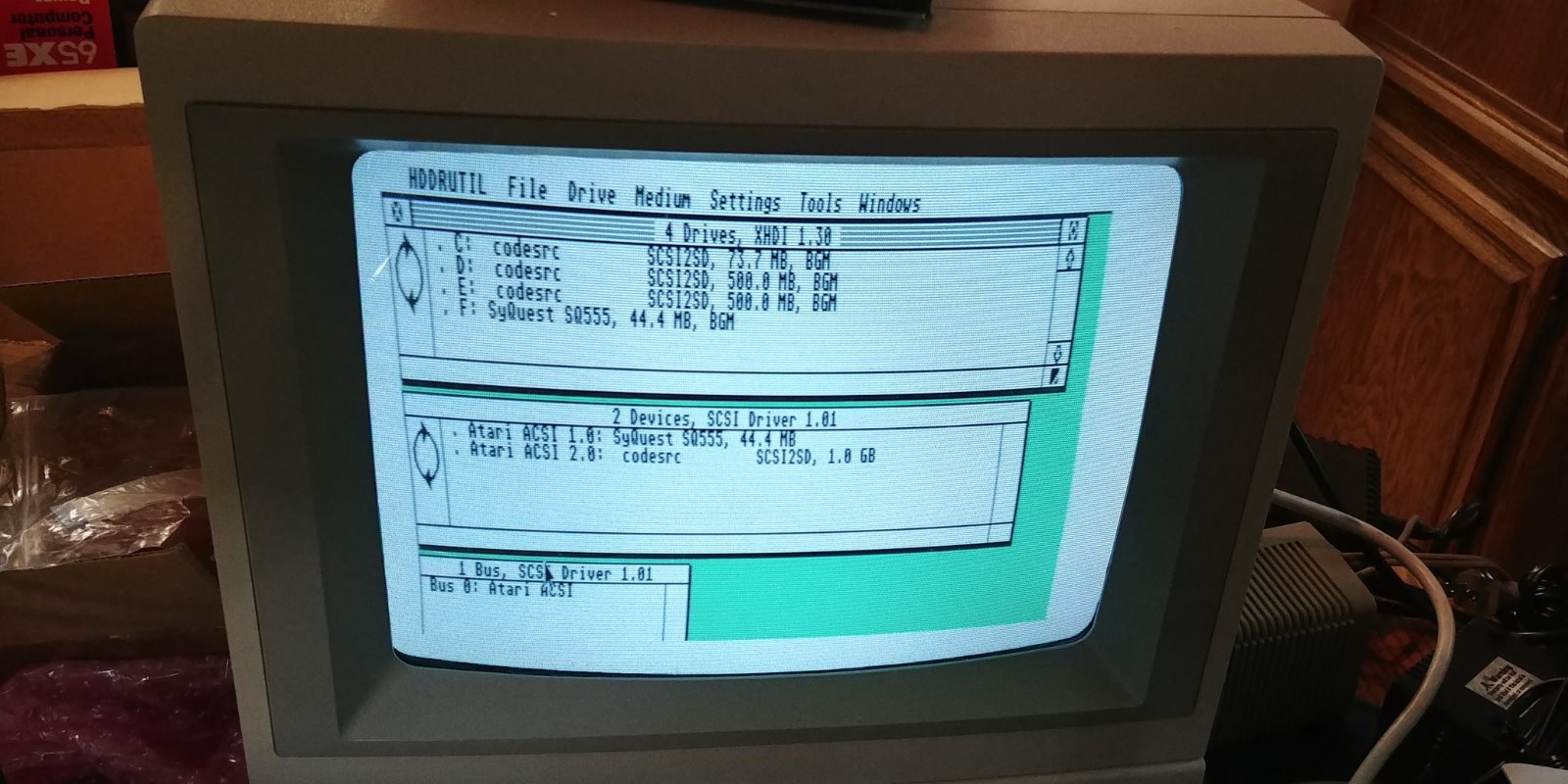

While I was working on MF44 #2, I learned that I can have 4 drives set up on the SCSI-To-SD each with their own LUN. That gave me 4 drives of 1 gig each. You can see the extra drives in pics. Also, I found that I can change the device name and product which you can also see in the pics.
Now I have to make those changes to MF44 #1.

I learned a big lesson today. You can only have one device per SCSI port in a MF44 when the motherboard is Atari's, thankful that it has two ports. The AdSCSI was able to get 5 devices on it's one port.
