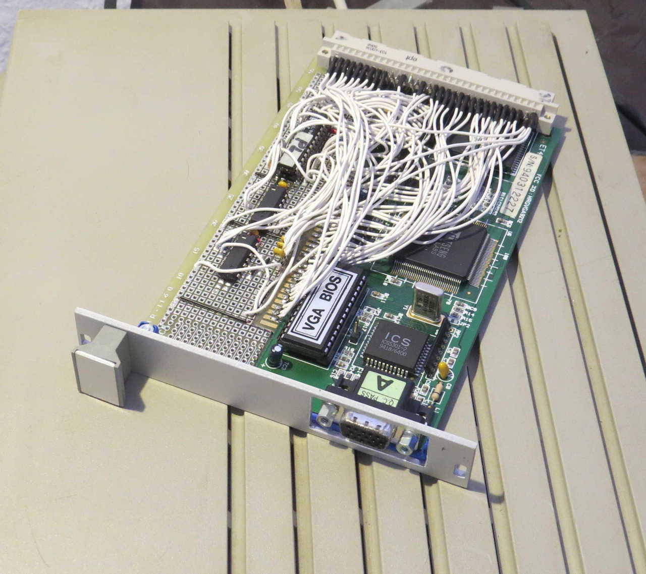

Like this ...
The ATI cards are to big. may be cut the ISA Slot pins the put the card up site down on a adapter board into the VME bus slot ?
