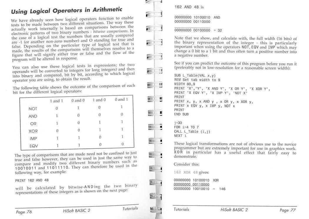

In case that Hisoft Basic doesn't support logical operations (AND, XOR), that could be pretty tricky. :) If it does, then it's easy:
<input> XOR 01000000 <--- flips the 6th bit
<input> AND 01000000 <--- clears the 6th bit
<input> OR 01000000 <--- sets the 6th bit

It should have been: <input> AND 10111111 <--- clears the 6th bit

Re: change a bit in a variable ?
Awesome thanks. I think logic operations are in hisoft, will check it out when I get home later.

Unfortunately Spectrum BASIC doesn't have bitwise operators, it only has logical ones :( I'm unsure if in HiSoft BASIC it is any different.
