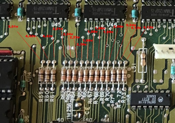

Hi,
Thank you everybody for all your nice answers. Following your words, I tested all what I could on the RAM.
First of all the board is composed of 2 banks of TMM41256P-15 chips (I included a datashit here).
I made some measurments (with a voltmeter, i do not have a scope)
1) Without power : All electric continuity (GRN and 5V) seems ok on every pin of each chip.
2) With power : here is the voltage I measured on each pins of each chips
A8 : 2,22 volts
DIN : between 2,89 and 3,15 volts
WRITE : 5,04 volts
RAS : 3,50 volts on BANK 1 / 4,12 volts on BANK 2 (strange isn't it ?)
A0 : 2,36 volts
A2 : 1,98 volts
A1 : 1,99 volts
VCC : 5,04 volts
VSS : 0 volts
CAS : 4,42 on BANK 1 / 5,04 on BANK 2 (strange again ...)
DOUT : from 2,43 volts to 3,19 volts
A6 : 2,24 volts
A3 : 1,98 volts
A4 : 1,99 volts
A5 : 2,27 volts
A7 : 2,25 volts
3) I also measured the voltage on the following resistors I know have to deal with the memory.
Unfortunately, I'm not good enough in electronics to find out the trouble. What I noticed is the strange voltages differencies happening on RAS and CAS pins between the 2 banks. Not sure if I can conclude that BANK 2 is out of order ... can you ?
Another idea, but not sure at all : I used to change my TOS from 1.0 to 1.4 ... Do you think this could have to deal with ?
Any help appreciated
Best

Re: Help bringing my 1040STf back to life
You can't measure these signals with a simple voltage meter. You need a scope. but it doesn't prove anything either way.
Your options are, to get the diagnostic cart and serial link to a PC to see if it gives any clues. Or unsolder the problem bank, put sockets in, and get some new DRAM chips and just replace the whole bank.
Perhaps i'm wrong but the measures I get would say that there is no cut tracks on the board. So in your opinion does it worth a try to your 4MB upgrade (STFM 4MB RAM EXPANSION) ...
