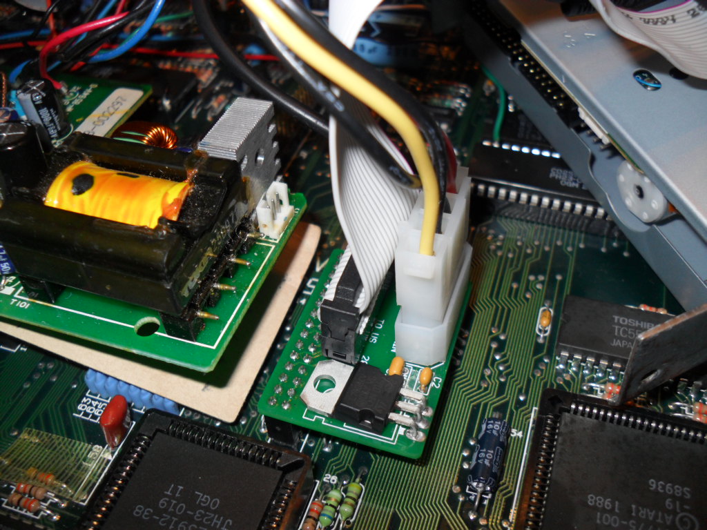

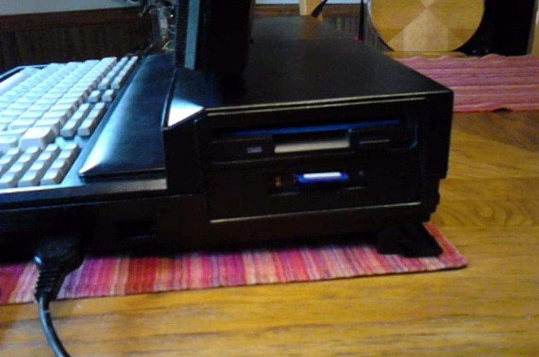

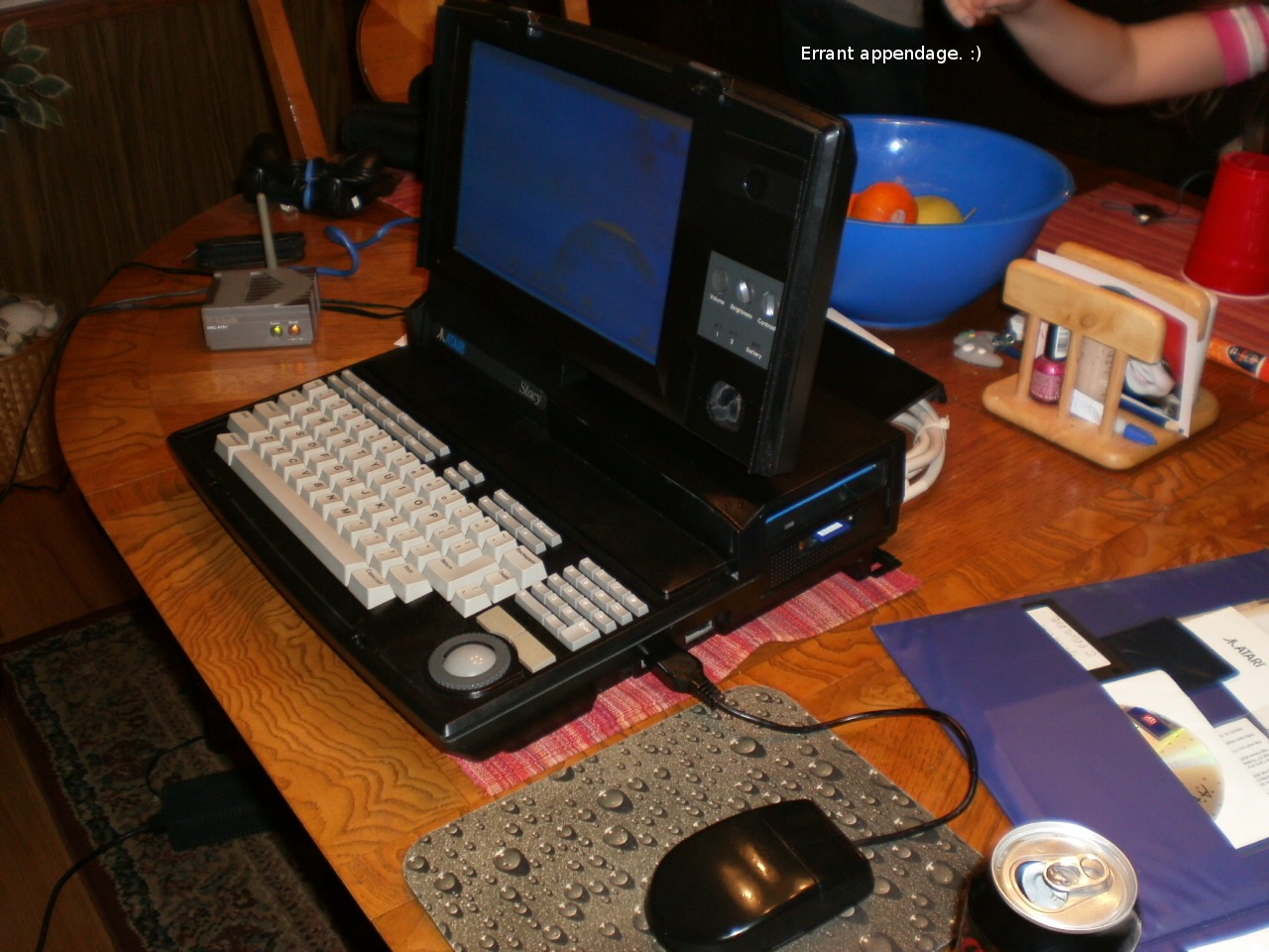

The Ultrasatan works great with the STacy!
I put one in mine internally, using Alah H.'s internal Mega STe/STacy adapter.
Here are some pics:
