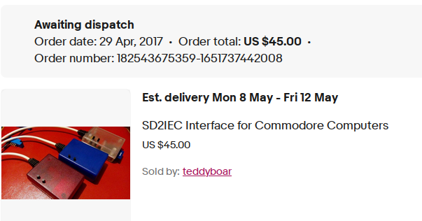

As for the SD2IEC variant...that info has flown. :(
The most I could find on Ebay was a small clip of the original listing:
The seller was based in Hungary and looks like is not active any more.
