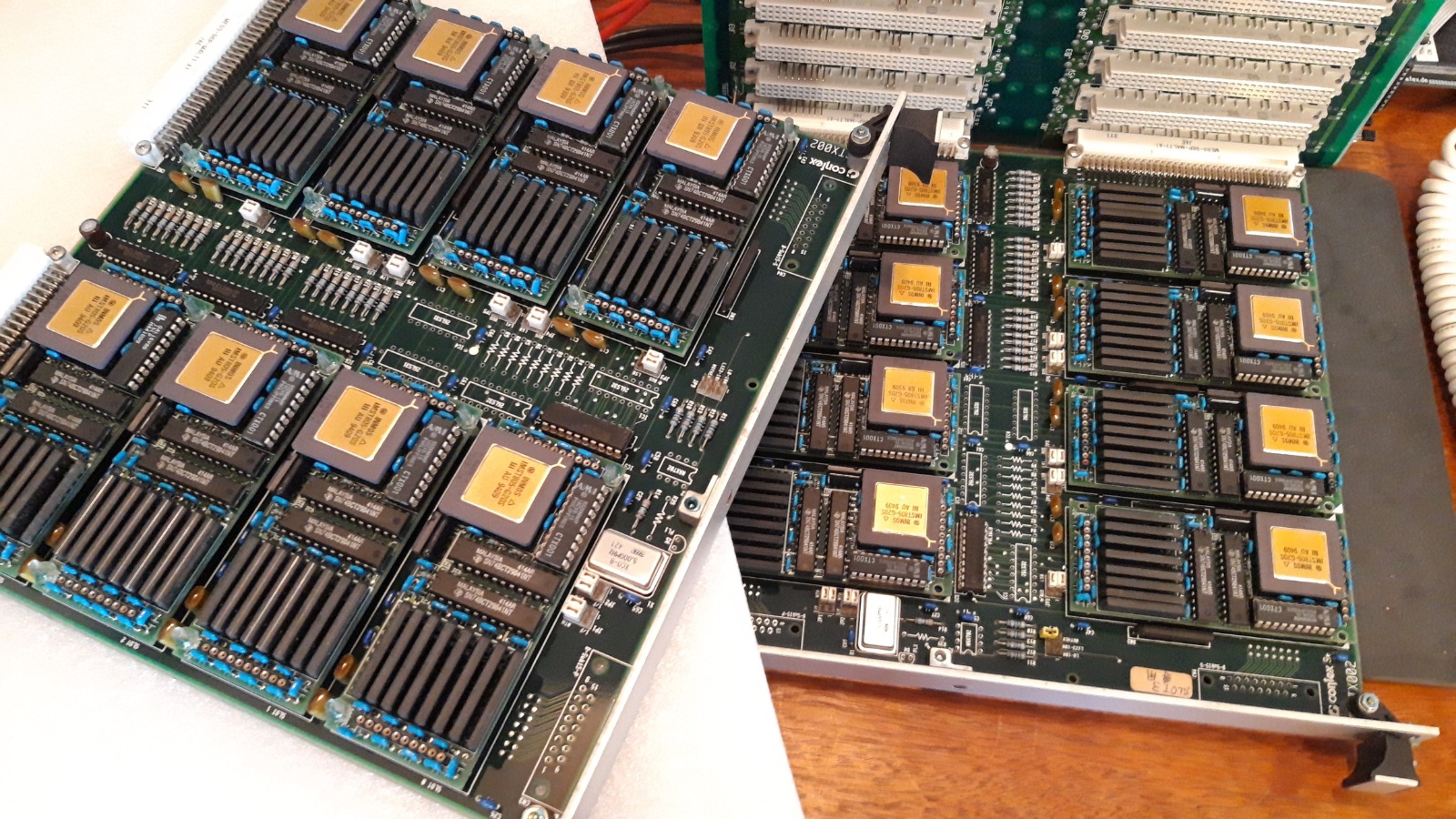

I think we completed bullet 1 on plan list 2:
next part should be:
- make code run on it <----- we are here
- escalate things in all directions
- render some Babylon 5 on it
That means we unlock the escalate-things step! Now there's two of them.
I need to figure out from my notes which tie points will get them talking. Time for some wire-wrapping....

rubber_jonnie wrote: Sun Sep 27, 2026 2:00 pm You'll be running your own AI on it soon enough!
It seems like we're not in short supply right now :-)
A contributor on the ATW800 channel has actually done this (running a very very tiny model, on the root Transputer) as an experiment.
