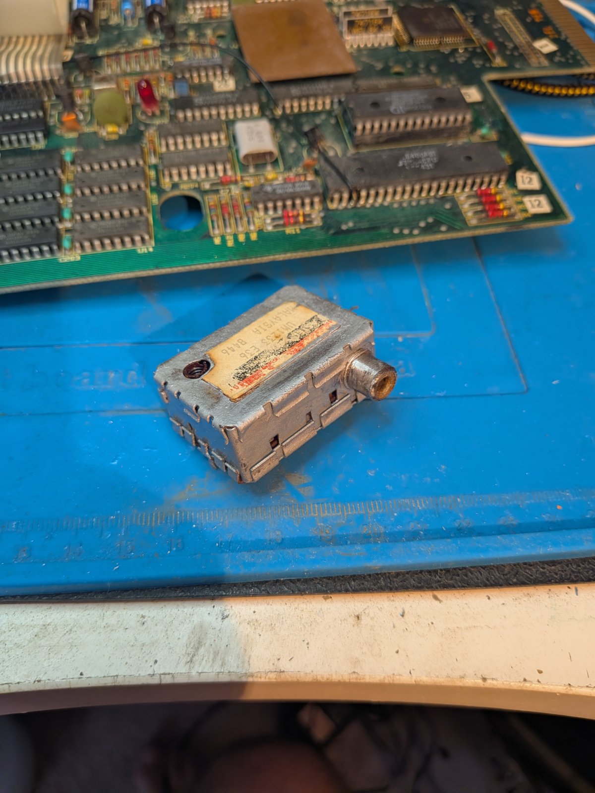

Modulator cleanup started:
Before:
And after:
Before:
And after:
- Posts: 15537
Modulator all cleaned up and reinstalled:

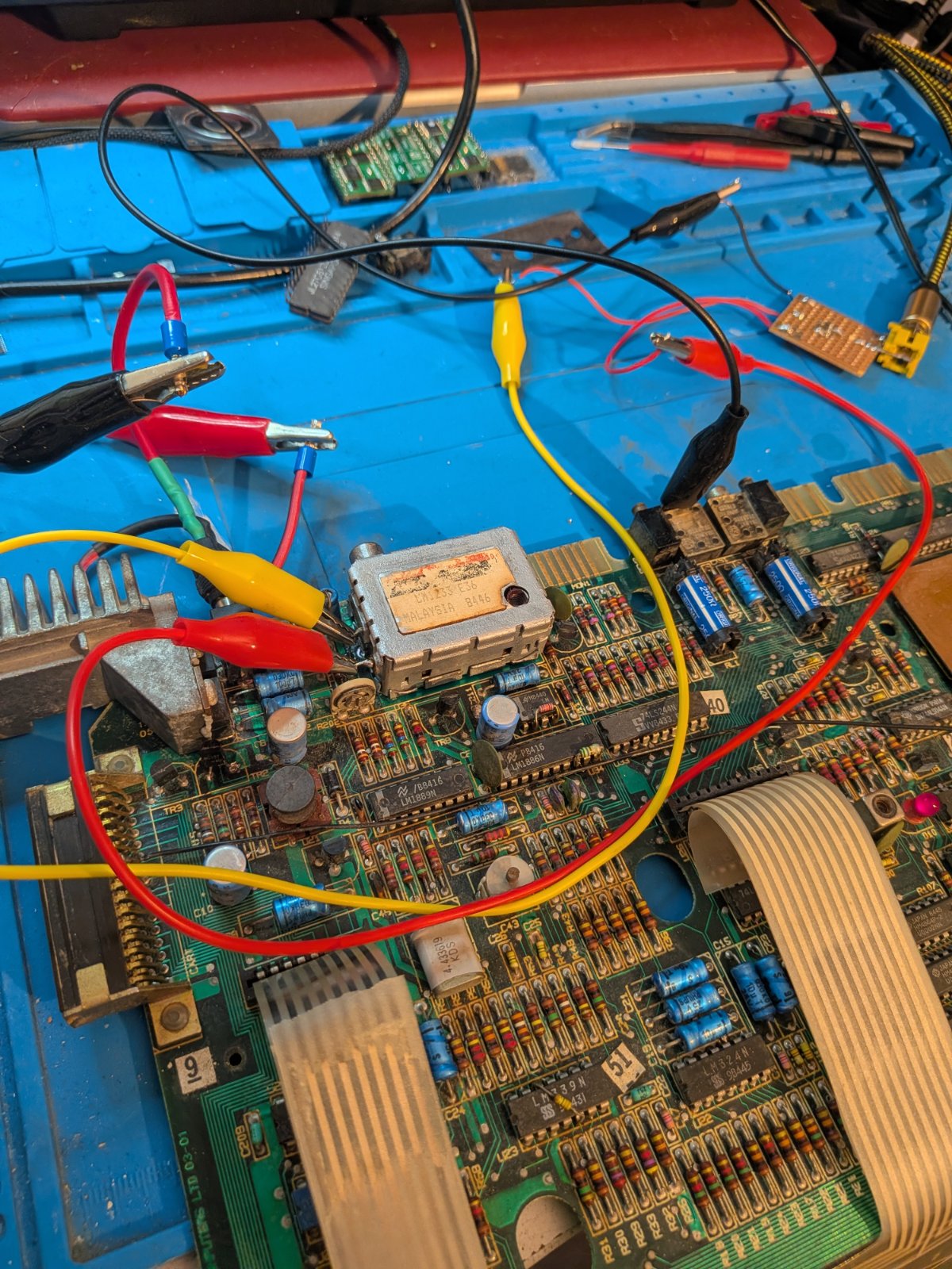

So back to picking up composite from the modulator input with croc clips

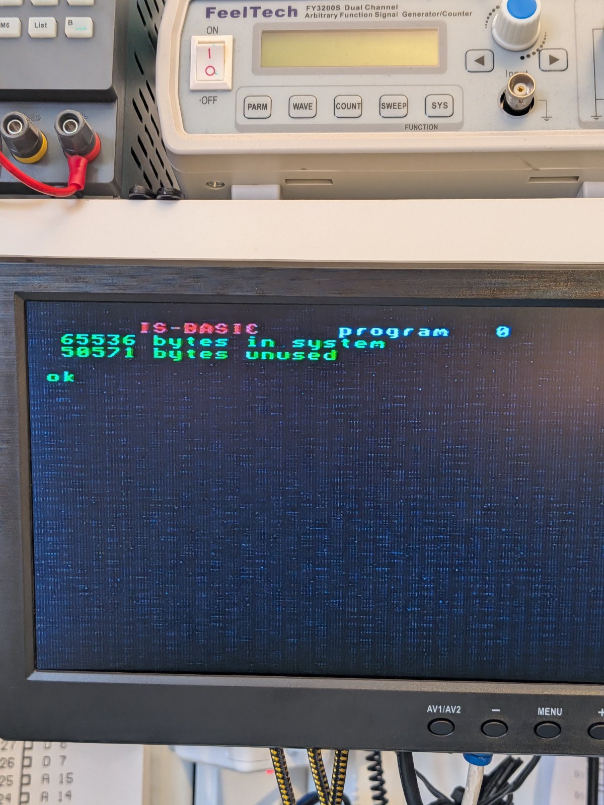

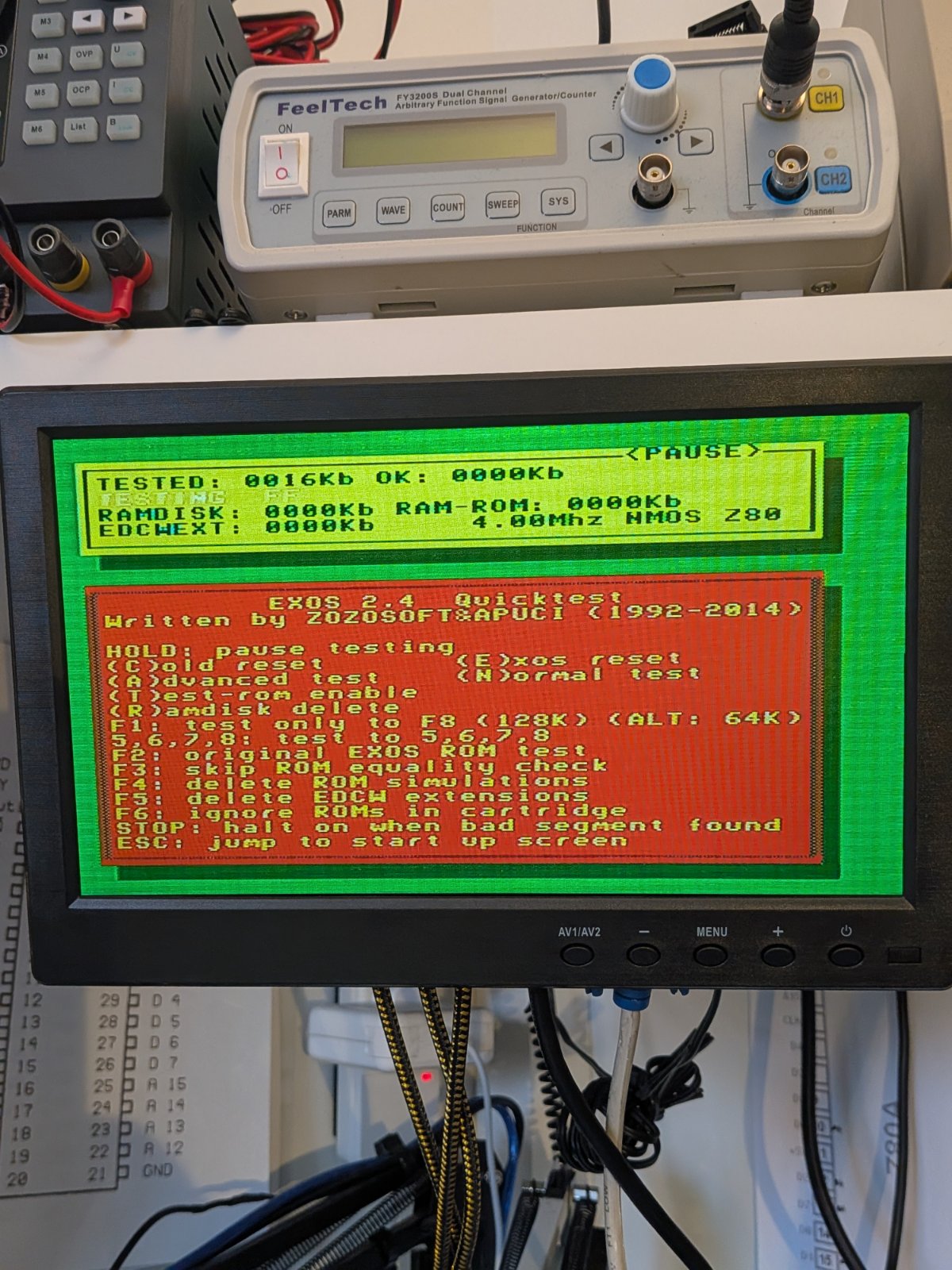

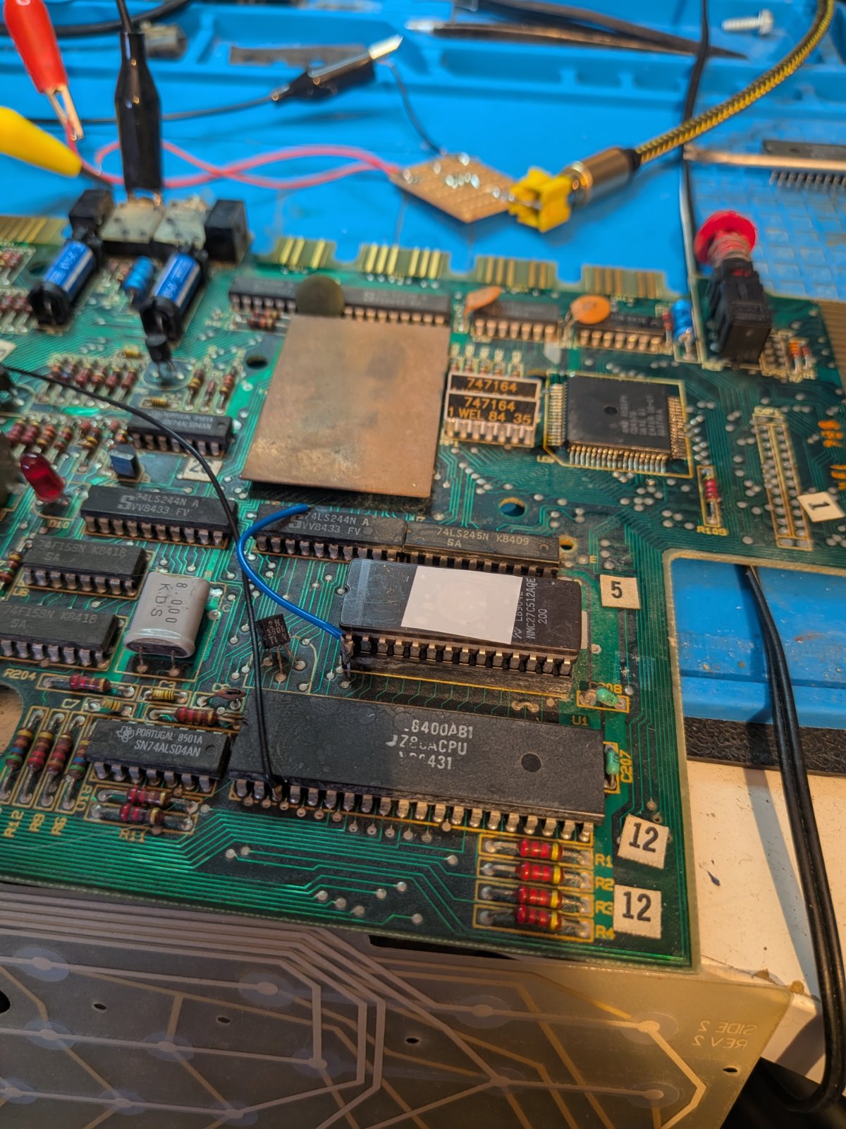

Upgrade no 1 done:
New ROM with EXOS 2.4 installed, so including BASIC:
Just need that keyboard membrane to turn up now.

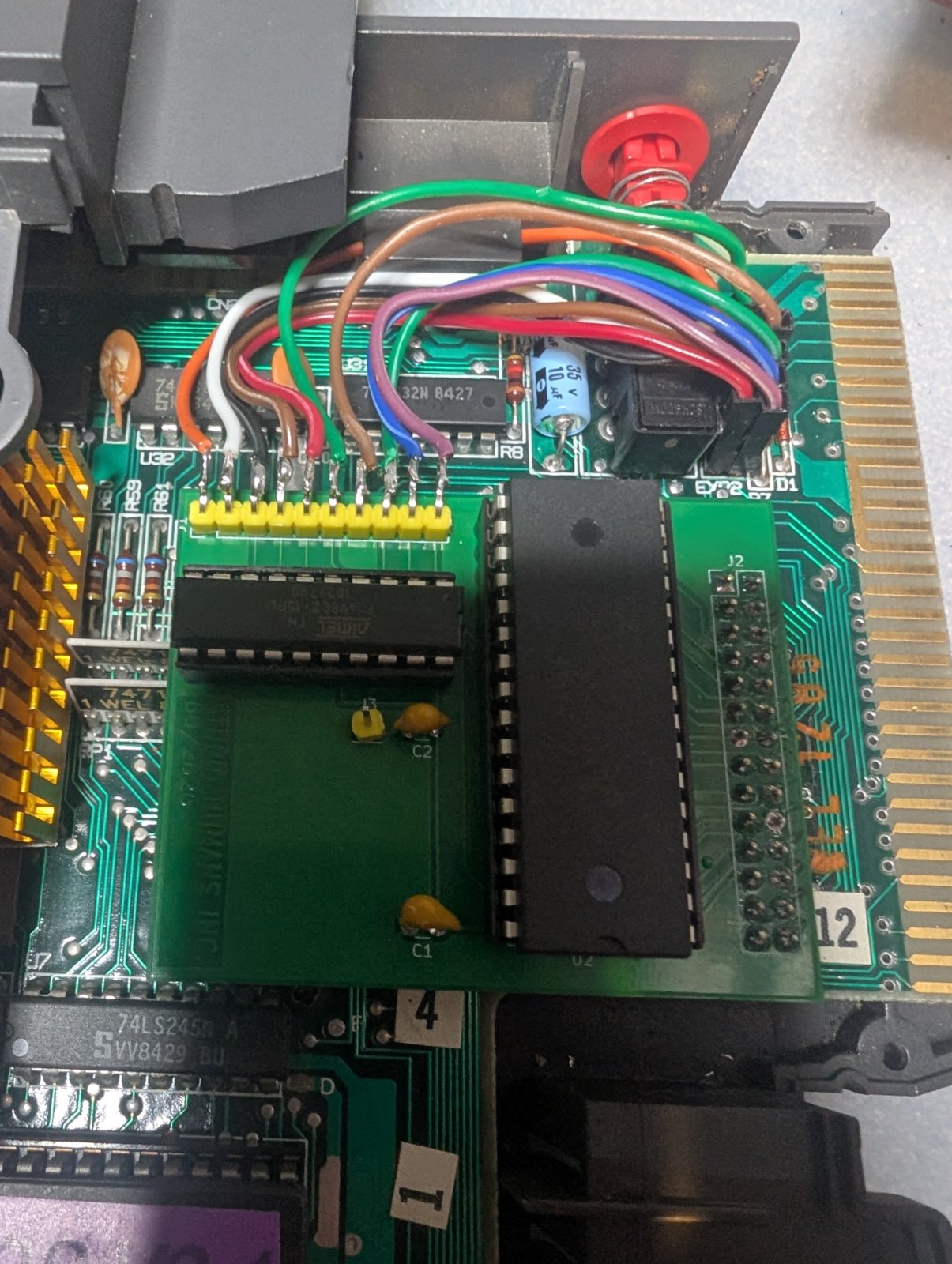

@rubber_jonnie why not pop another heatsink on top of that copper sheet whilst you've hit the case open?
And you'll need to get EXP1 & 2 ready for the ram expansion
- Posts: 15537
Funnily enough I was thinking about both those things earlier today, need to find my small heatsinks, and I'll pop one on the other custom IC while I'm there.PhilC wrote: Fri Aug 07, 2026 2:53 pm @rubber_jonnie why not pop another heatsink on top of that copper sheet whilst you've hit the case open?
And you'll need to get EXP1 & 2 ready for the ram expansion![]()
@rubber_jonnie the second heatsink would be in the way of the ram upgrade
- Posts: 15537
Okey dokey, thanks.PhilC wrote: Fri Aug 07, 2026 3:07 pm @rubber_jonnie the second heatsink would be in the way of the ram upgrade
