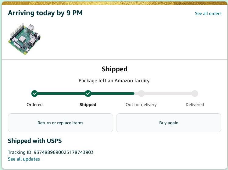

No show on the Pi3a+ today. Amazon is still showing it for delivery by 9pm but it's being shipped by USPS and the mail has already run today. Typically, that means it will show up the next day (tomorrow - Wednesday). I'm not surprised. The universe hates me.
Re: My (attempted) PiSTorm STacy installation
Delayed again...maybe Thursday (14th) now...

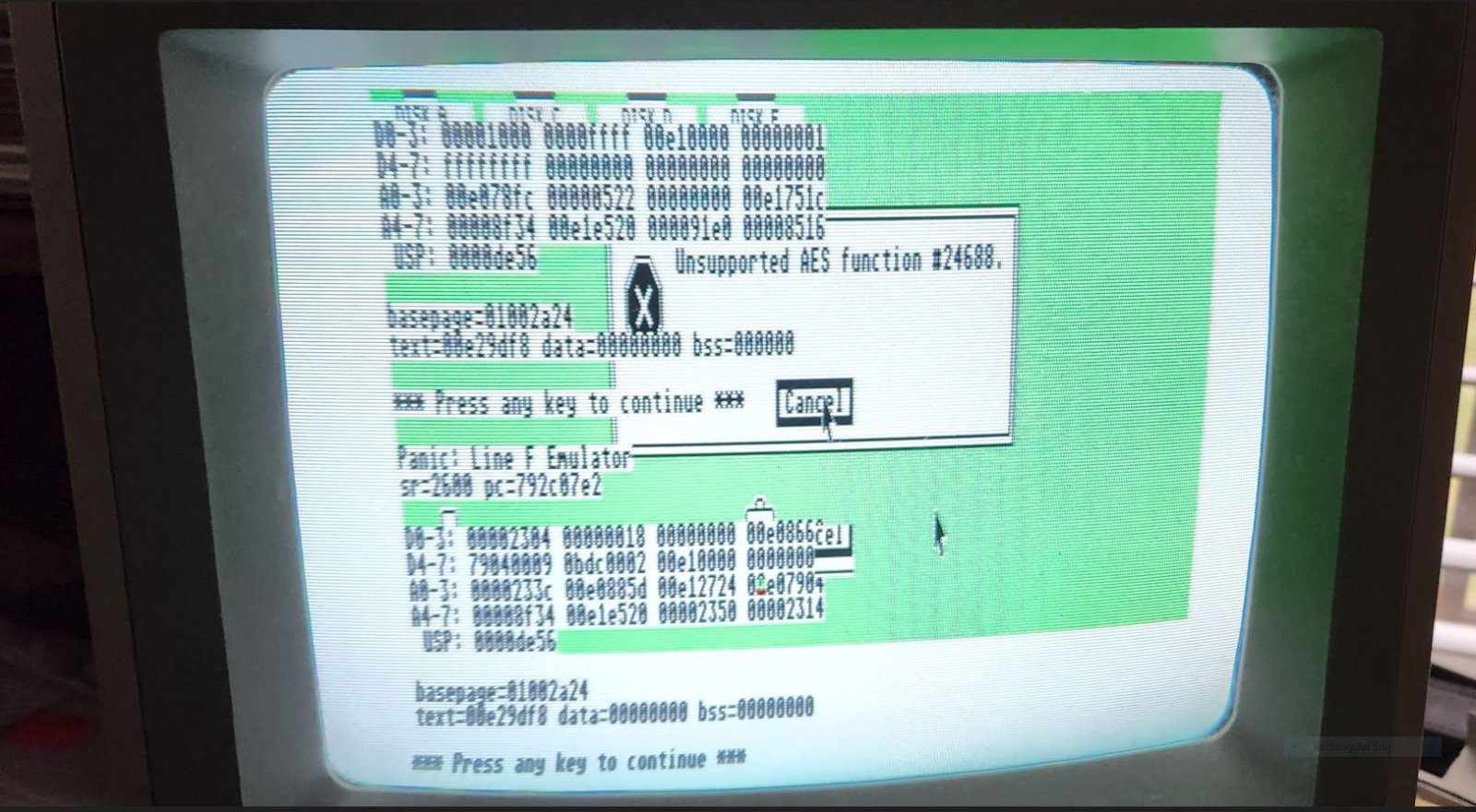

you. I'd upload all the saved screenshots of crashes we went
through but I don't want Exxos warning me about taking up
too much space.

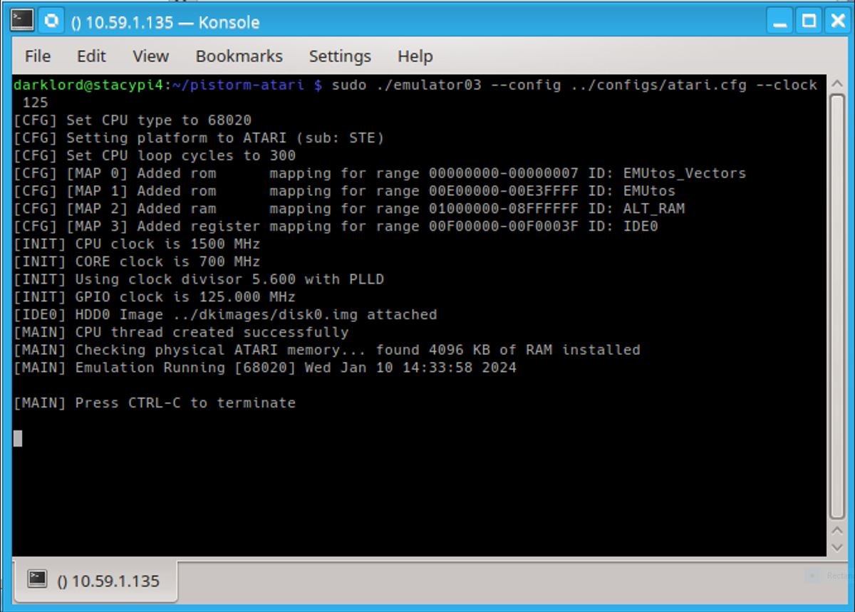

So I'll simply show you the console screen from my Kubuntu
Linux laptop first, where I'm ssh'ed into the PiSTorm setup and
launching the emulator software:

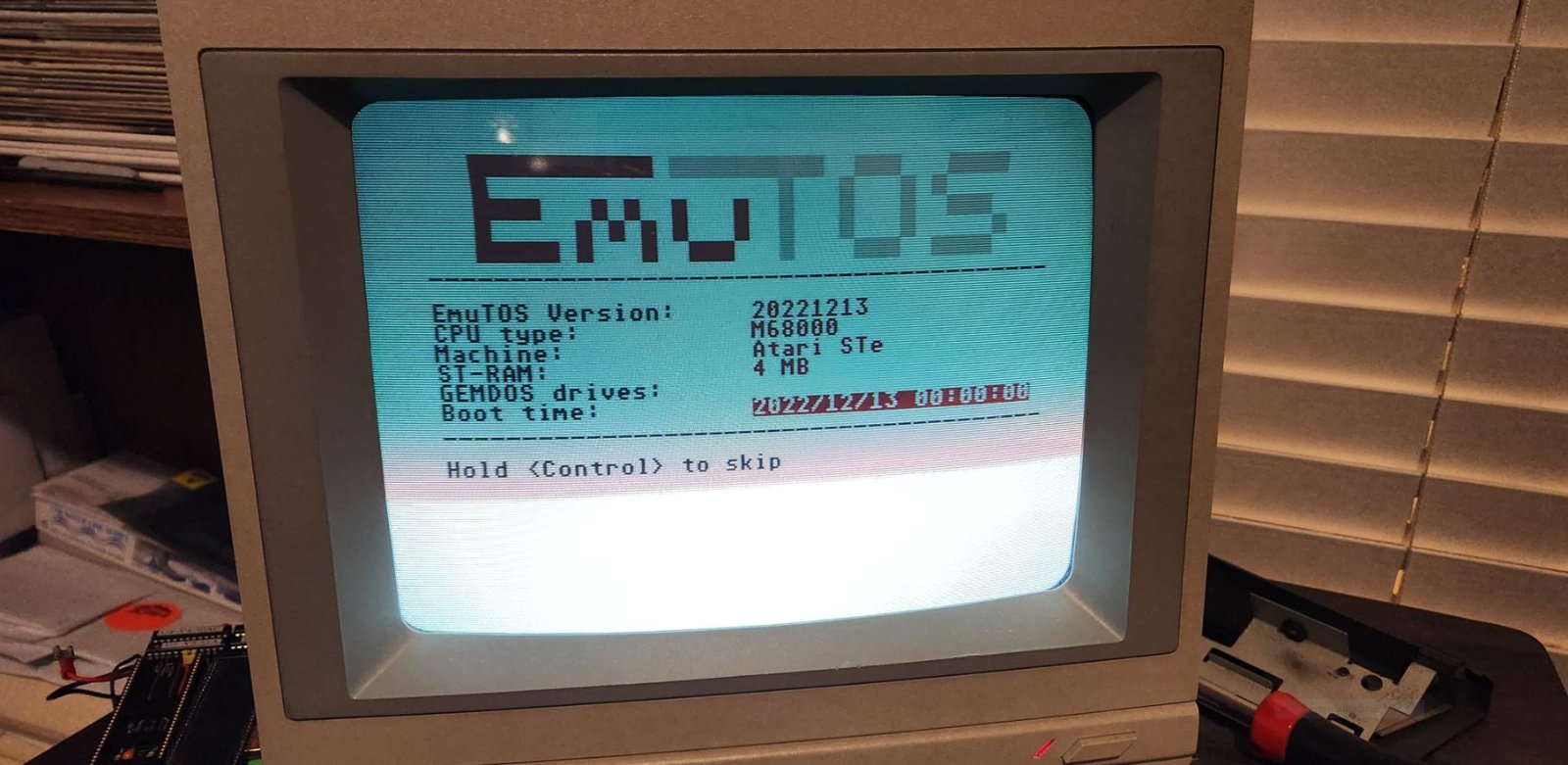

Now here's the initial EmuTOS screen via an external SC1224
monitor, hooked up to my STacy:
too much space.

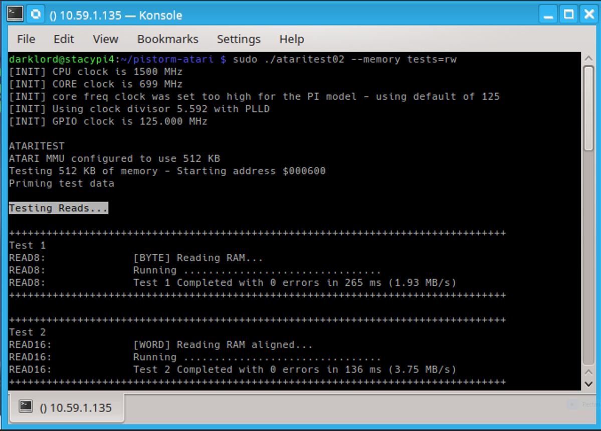

I'm ssh'ed into the PiSTorm/Pi4b setup from my Kubuntu Linux laptop and running the memory test,
it passes:
Now launching the PiSTorm emulator software:
it passes:
