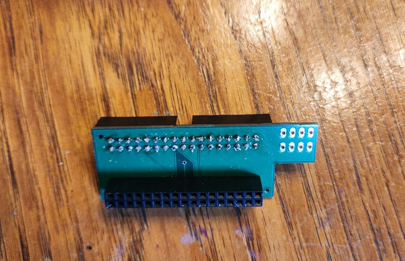

Unfortunately, one side of the STacy's floppy drive/hard drive bay (cage/cradle) bracket
was sitting on the module when I tried to fit it so I had to "adjust" it a bit with a metal
snipper:
Posts: 29733
Re: 1.44 floppy mod Assembly guide?
Definitely some bad joints going on there with the flip kit...
Hard to tell but there looks to be shorted pins on the kit headers as well..

Finally, hooked up the rest of the "flip-flop" cable and put everything together:

Posts: 15551
I'd agree with @exxos the soldering on the flippy adapter has some noticeable cold joints when viewed up close, and there may possibly be solder whiskers on some.
I'd suggest that there are a few of issues here.
  1. I don't think your iron is hot enough. I use 350C to 370C (660F to 700F) in most scenarios and that works for me, but each iron is a little different, hence why I usually suggest a range.
  2. I don't think you're dwelling long enough on the joints as the solder in some spots doesn't look like it's melted properly. Header pins take a bit more heat than chip legs.
  3. For heavy joints like those pin headers, you may find a little extra flux over and above what's in the solder will help the solder flow around the pins.
I'd suggest a drop of flux and a reflow of all the pins until you get a nice joint for each one, and that you inspect under a magnifying glass or microscope to ensure there are no shorts between pins either.
Be sure to heat the pins and PCB at the same time or the solder won't flow properly into the via.
