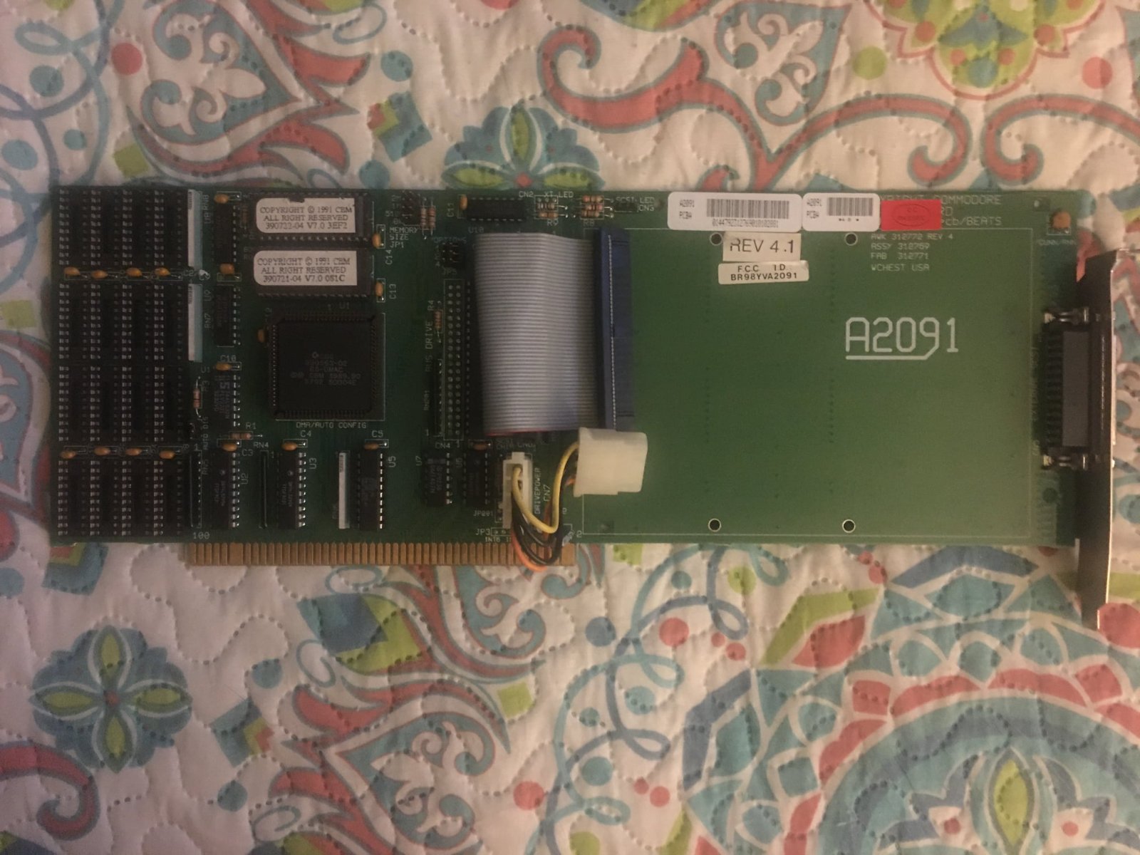

Hi everyone, I'm recent to the A2000 / 2091 / TF536 Club. I purchased a card that's untested so of course we have that, but all signs indicate the unit. Taking it from the top:
A2000 / TF536
A2091 ver 7 roms / Rev 4.1
It seems like the A2000 sees the card and says its working. I've included a series of pictures that hopefully display well.
I configured the HD tools to look for DEVICE=2nd.scsi.device and it tries to scan it. the screenshot you see is from a slow-mo video and it scans all of the channels of the first scsi device (which is where the CF card HDD is read from the TF536) and my understanding is the 2nd.scsi.device will allow the amiga to check the scsi card.
I also have a scsi zip drive (disk not formatted for amiga) to test with as well. so far i've always tried to have the scsi internal HDD since that's pretty important, though i could live with an external scsi interface too with zip and external cdroms around to use.
I've been testing with "termination enabled" for the internal card.. but i did start with termination disabled and it wasn't working then either.. but that might have been before i did device=2nd.scsi.device. i think i'll go try that for good measure.. ugh. remove card / hdd again.. heh. :)
I have a few days to start a refund if this thing is likely looking like a lemon. I've been waiting for other key parts to get in and get working before i threw scsi into the mix which is why it's say for a few weeks now.
the HDD I inserted is a quantum HDD that came from a Quadra 650. I can't tell it's size unfortunately. if anyone knows how i could determine from reading various information I'm all ears on how to determine that. thank you in advance for any advice you might have!

Take the TF536 out and try setting up the hard drive on the original CPU to test the scsi card? HDToolbox will read the size of the Quadra hard drive.

Hey yes sorry all signs indicate it's working.. as in system sees it.. etc.. BUT in reality i did further test it as bare bones as i could:
1. i already removed the 68000 so the TF536 is the only CPU.. but I did remove the CF Card so it would have no conflicting SCSI device
2. I booted from 3.0 wb disk (i have 3.1 roms) but even booting from the install disk the system would not see either the attached HDD or setting it up to be only an external zip drive (terminated)
3. it still failed to see anything.
I'm pretty sure that this is just not working for me. I've contacted the seller and he's going to do a refund minus the shipping. it was worth a shot. I will see if I can find another scsi card that i believe my be sold locally.
