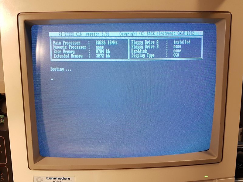

Did no one notice i run Dual Core? Its in the last seconds of the video clip...
Out of interest i threw my SACK C-16 AT Speed card into one of the expansion sockets.
works like expected, though i never tested it before (in any machine)
Now i need HDD storage...
16MHz before you guys ;-)

:bravo: :cheer: :cheer: :cheer: :cheer: :cheer:

:lol: :lol: I have one of those cards too, glad to see it works.
Good luck with the 16mhz
DoG

PhilC wrote: 10 Dec 2019 15:14 :lol: :lol: I have one of those cards too, glad to see it works.
haha. I also have one of those AT-speed cards. Never tried it. Got a FPU on mine.
Nice to see another Mongrel board up and running!
