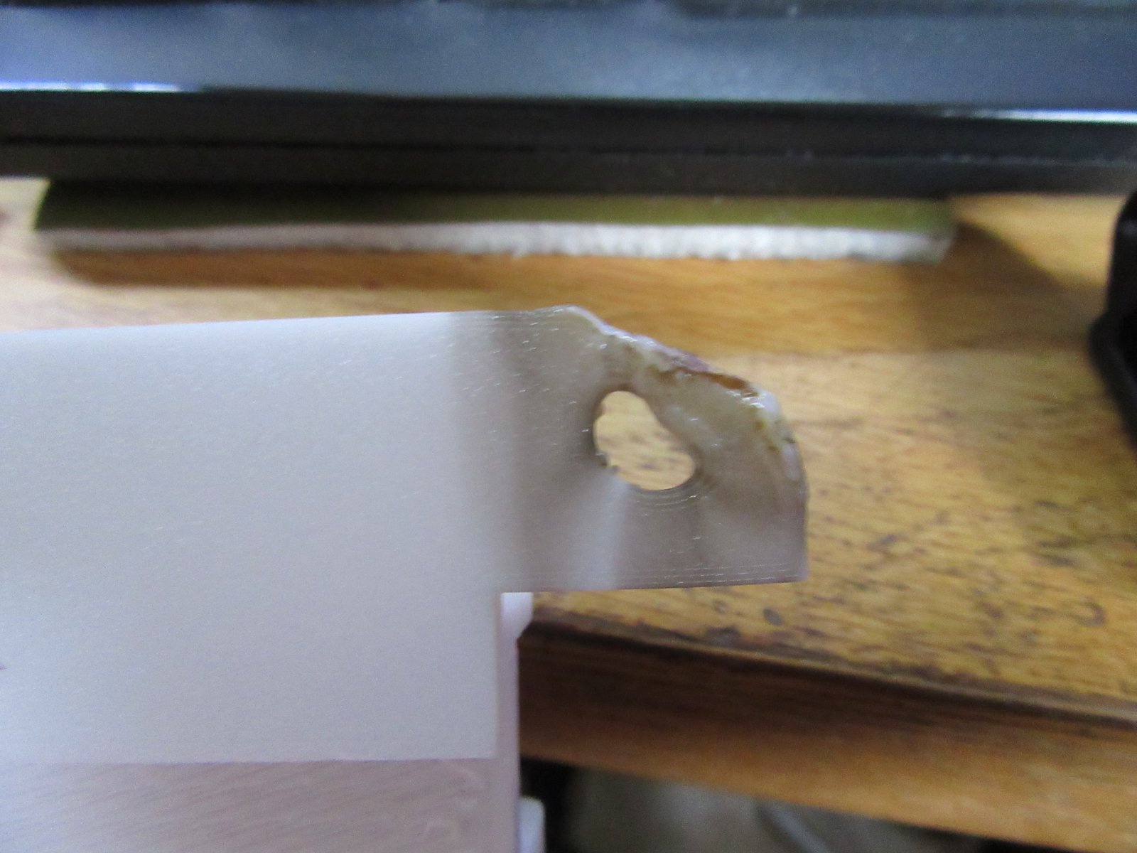

Tried setting fire to the thing, wasn't able to do much past melting the thing.

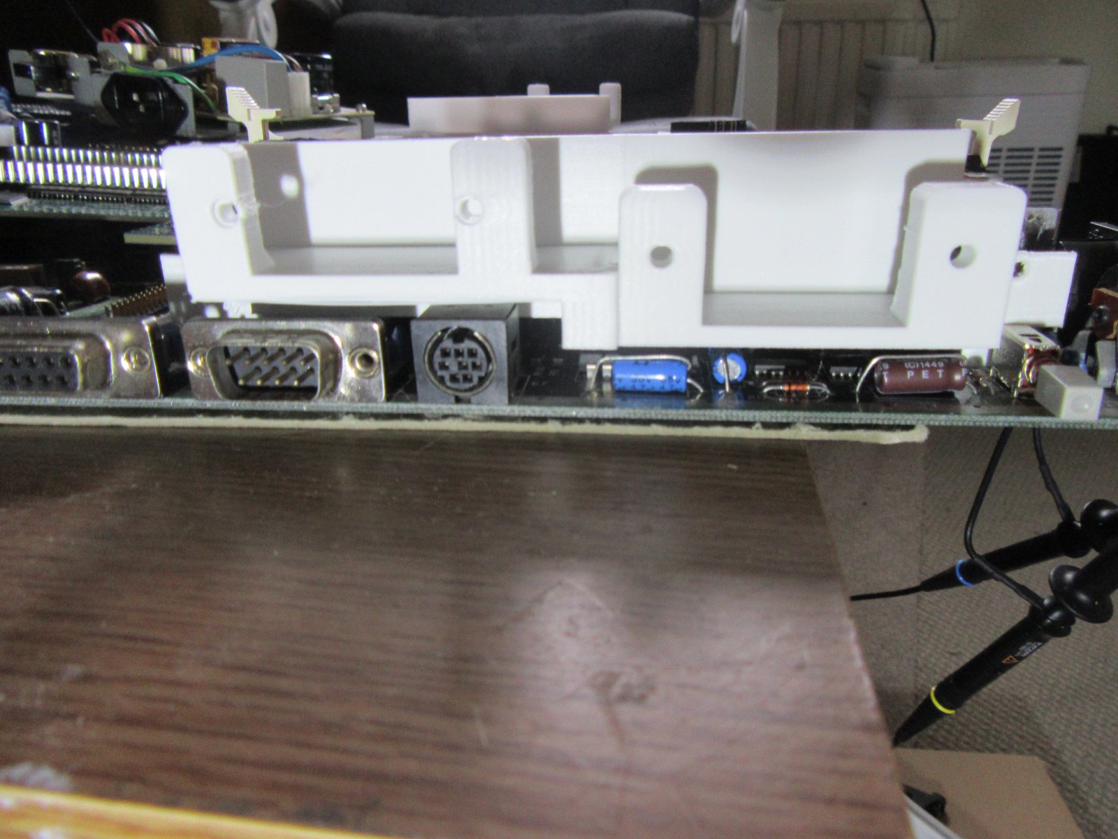

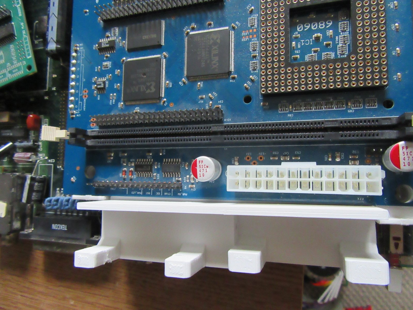

Right , think I am finally done screwing around with this rear bracket..
The support posts needs to be made out of metal. Cost about £5 each from China.
I need to work on the PSU PCB mount next..

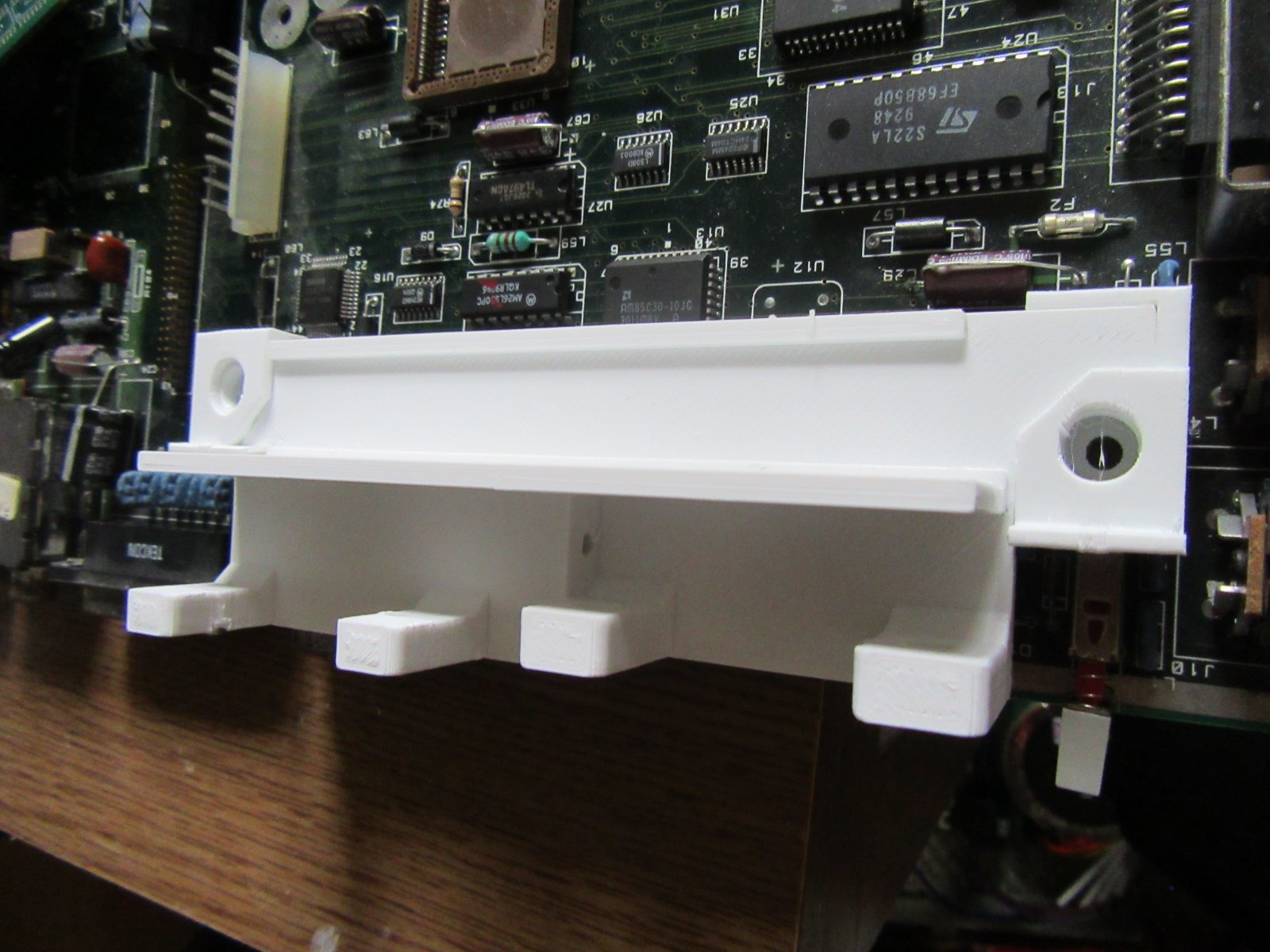

First bracket test now printing.. :ball:

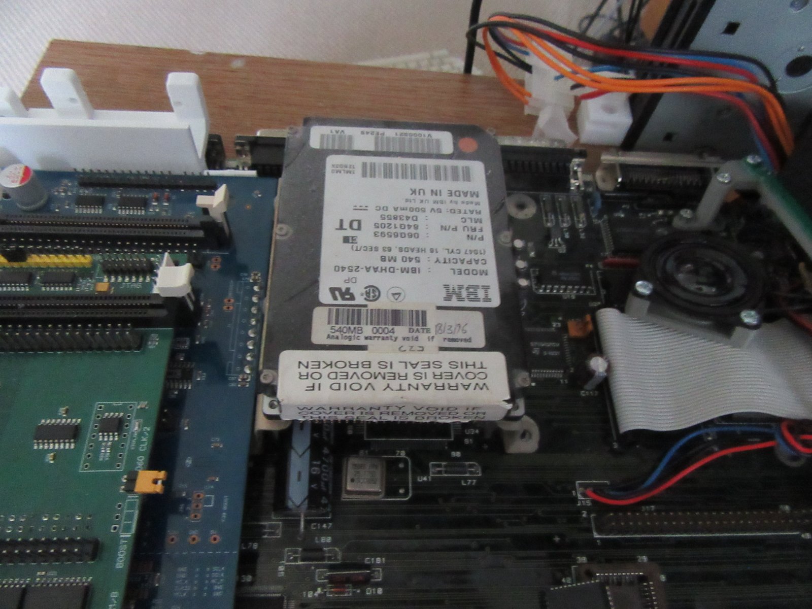

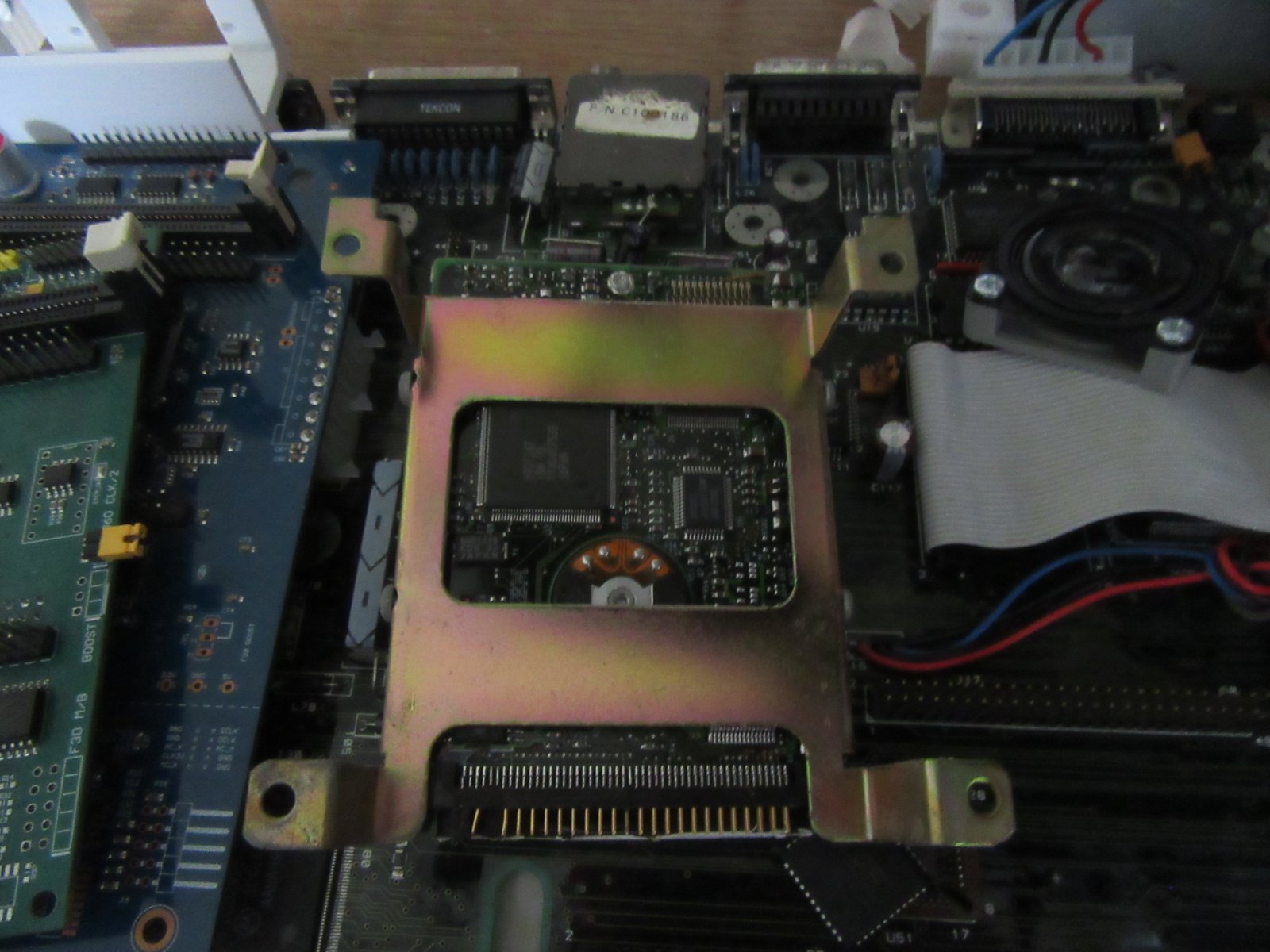

Amazing I found my original Falcon drive and bracket !

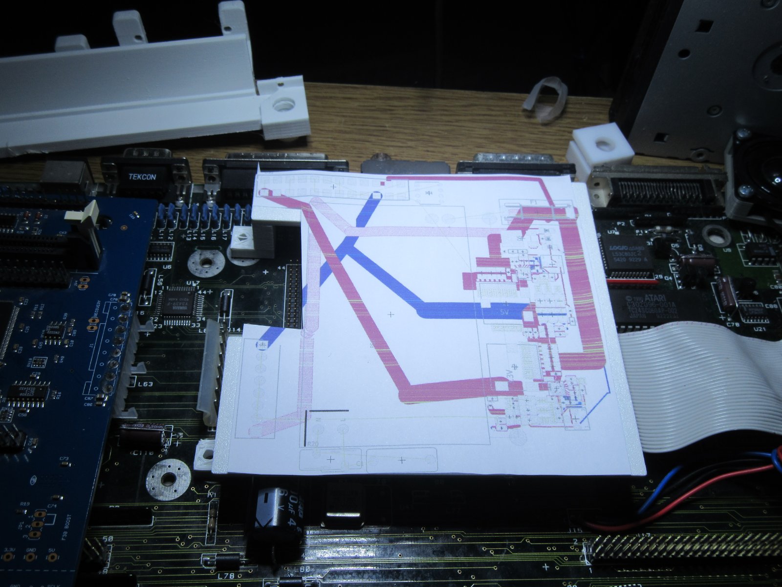

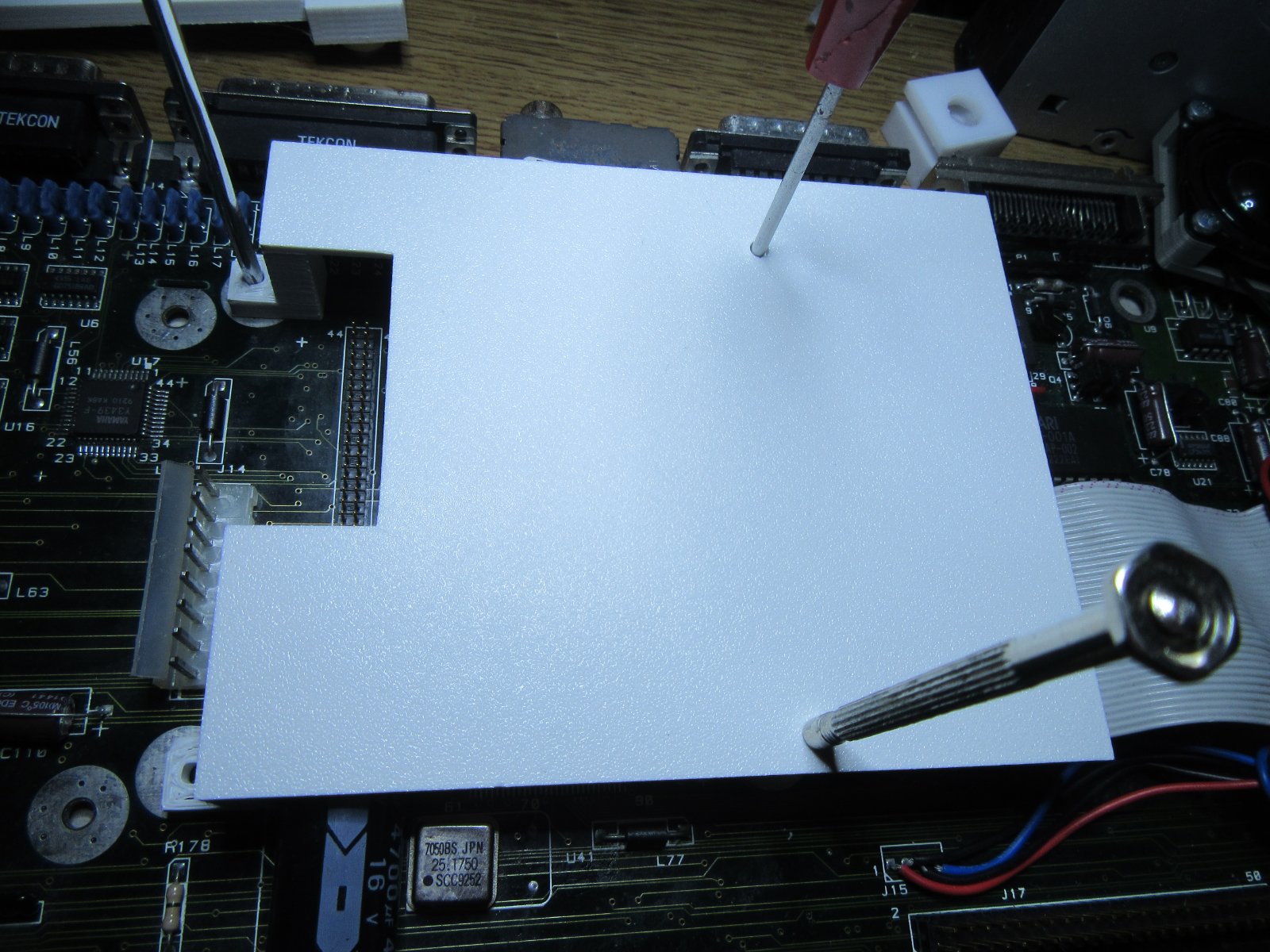

Well, 3 out of 4 ain't bad I guesss ! :lol: :roll:
The big fat cap could be a problem. Plus I need to make sure my big fat cap replacement kit fits as well...

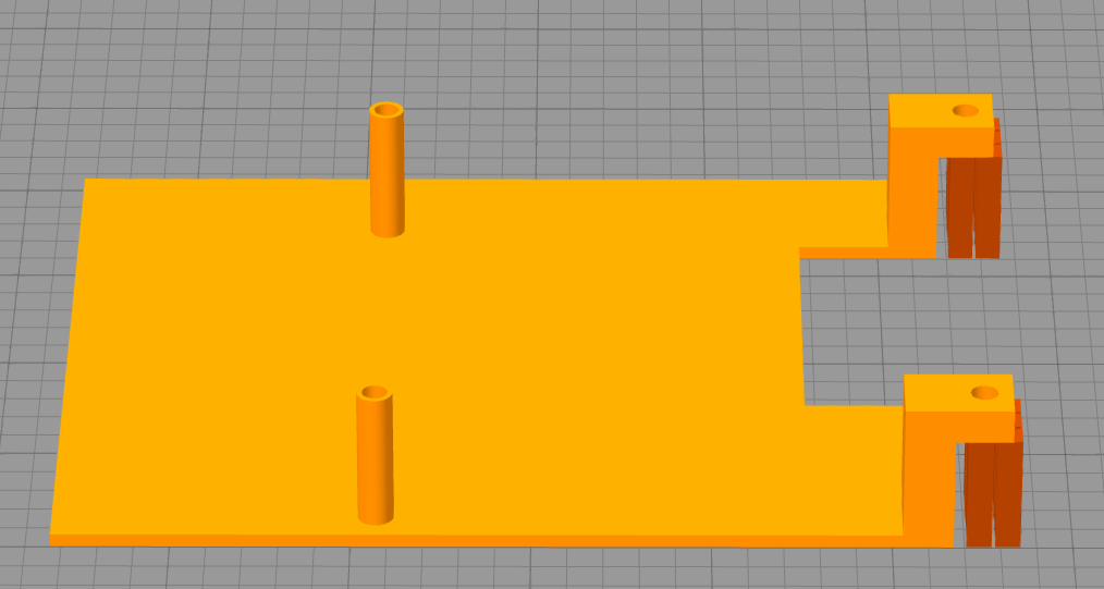

Bracket and PCB layout tweaked to make a bit more compact. I'm a bit stuck until the IDE adapter comes now as I need to figure that mounting area out to know how much PCB room there is..

exxos wrote: Thu Oct 15, 2026 4:25 pm Amazing I found my original Falcon drive and bracket !
Ah, the splayed pins of a 2.5" laptop drive. It's like a coming of age rite for the 1990s computer tinkerer.
