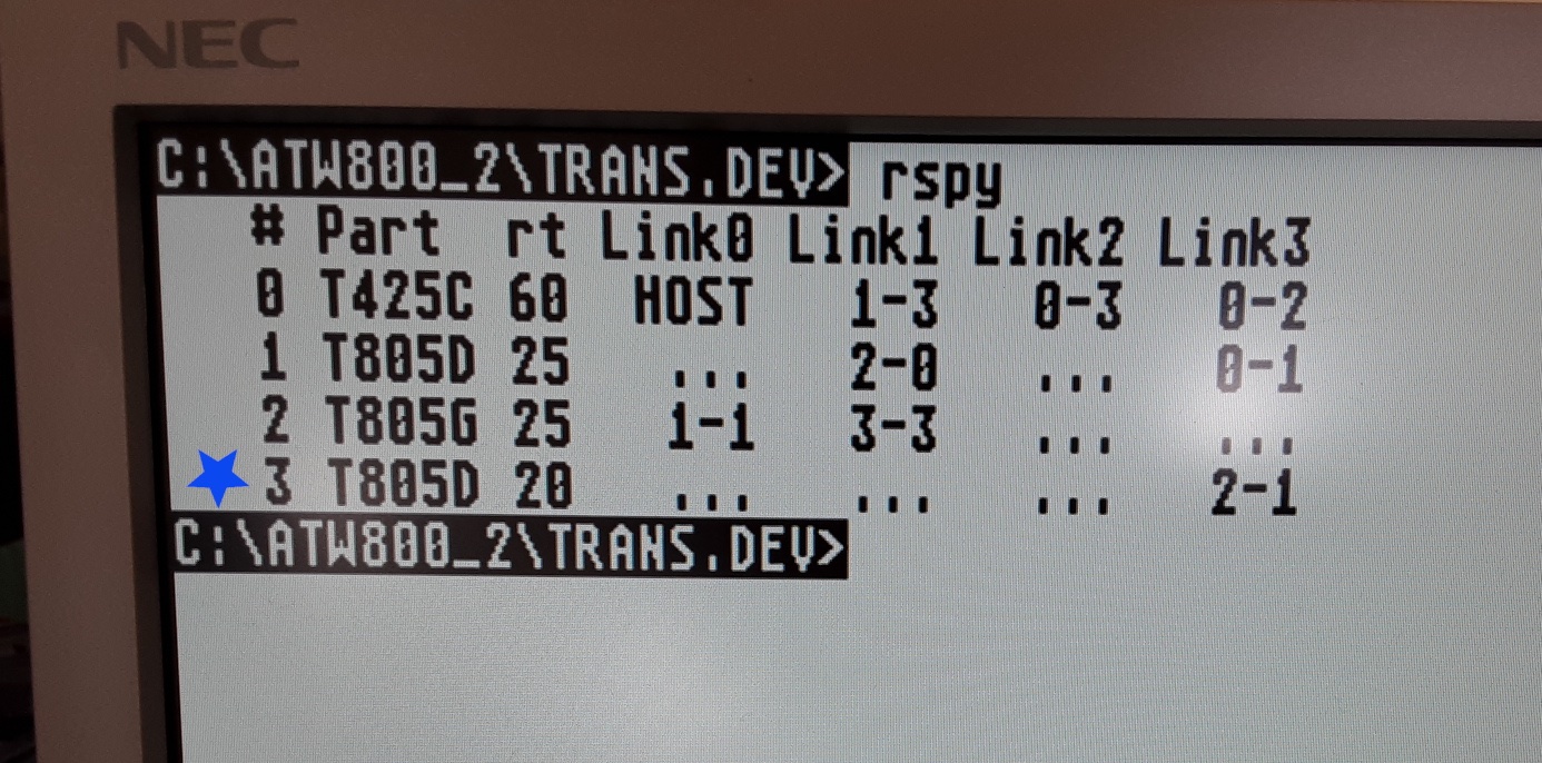

I then started MUPFEL and ran rspy. I did not have success with this - it only detected the 3 Transputers usually present. However I noticed that power cycling the carrier caused the green LED on the ATW TRAM (the one it is linked through) to flicker for a few seconds.
I switched things around and moved the Transputer to the slot on the side near the ATW, fed the signals directly into the TRAM pins (these ones have small sockets on top) and tried again.
Powering the carrier again caused flickering on the ATW TRAM LED.
This time running rspy though...
:D
So it has been seen by the Atari, across the external link.

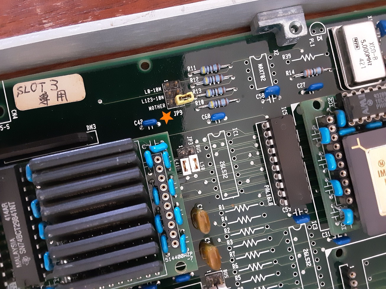

Tracking down the RESET issue led me to FOUR new problems.
1. The RESET input from the ATW800/2 was tied to the VME pin for the relevant PAL signal. However the termination resistor arrays on the CN1 connector carrying that signal are much lower value than on the CN2 connector where most of the data is. So trying to drive that signal directly was having almost no effect, It was only moving by 0.1v on the carrier board. That was just an oversight.
2. The RESET signal was also inverted. It is active-high on the Transputer side but active-low on the bus side, inverted by the PAL. I fixed this problem by adding a transistor to invert the ATW's reset and pull down the VME pin. This was also fairly easy to realise/figure out.
3. The RESET sent from the ATW side was apparently being ignored unless the MOTHER setting on JP9 of the carrier board was open. This appears to tell the PAL if to carry control signals through the bus or only within the board itself. So the jumper needs to be open to talk to host (I confirmed this by triggering RESET manually with the jumper open/closed, after a session of being quite confused...)
4. ...but the TRAM is only getting detected when the MOTHER setting on JP9 is closed. :)
So I can have a working external reset, or I can have a detected TRAM - but not both at once. Great!
dml
Posts: 914
Re: Supercomputing adventures with a MegaST/4
Post by dml »
The problem with the JP9 setting and the TRAM's weird detect behaviour had a simple explanation.
At some point I realised that of the 3 control signals going through the PAL logic on the carrier, ERROR is the only one that was NOT inverted.
Both RESET and ANALYSE are being inverted. ANALYSE I mostly ignored because it is only supposed to be useful in relation to debugging, after an error is raised and is not expected to happen in normal operation.
When JP9 is closed, RESET doesn't work - but ANALYSE does not get in the way because the PAL disables it. With JP9 open, RESET and ANALYSE are imported from the ATW800/2 - but ANALYSE is low on that side, being flipped -> high to the TRAM, causing it to halt.
Inverting both signals with Transistors fixed this.
After the fix, the TRAM is detected on every query with rspy.

Now things get interesting - the Atari is now talking to the carrier properly through the bussed links.
At this point it is possible to start adding TRAMs - starting off with slots which have already been figured out as linked downstream from the first TRAM (slot #4, link #0 was picked as the entry point) in the topology shown earlier.
Slot 4 is linked to slot 0 (hardwired) and slot 5 (jumpered) so either/both should be seen from slot 4.

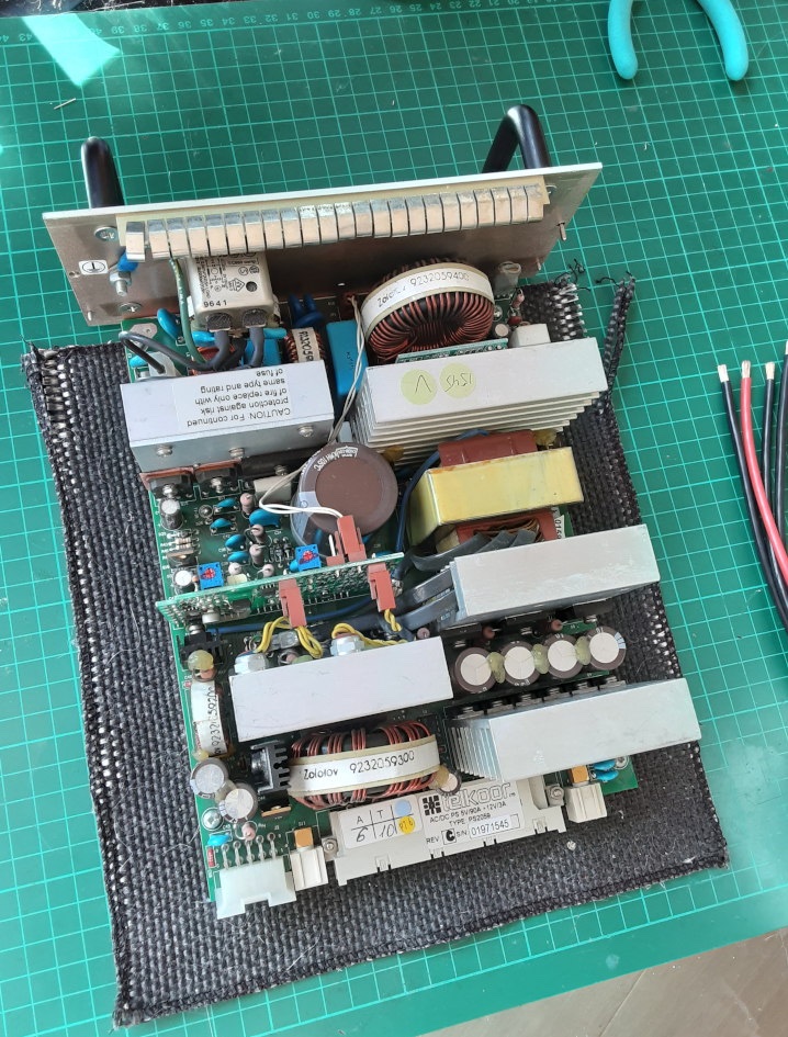

I don't think an ATX is going to cover it and my other power supplies are not really a good fit either.
So I'm going to use this:
90 Amps should leave a comfortable margin :coffee: half of that should do.
This was recommended to me by GeekDot as being 'sufficient' to power his cube so I think it will be fine here too.
