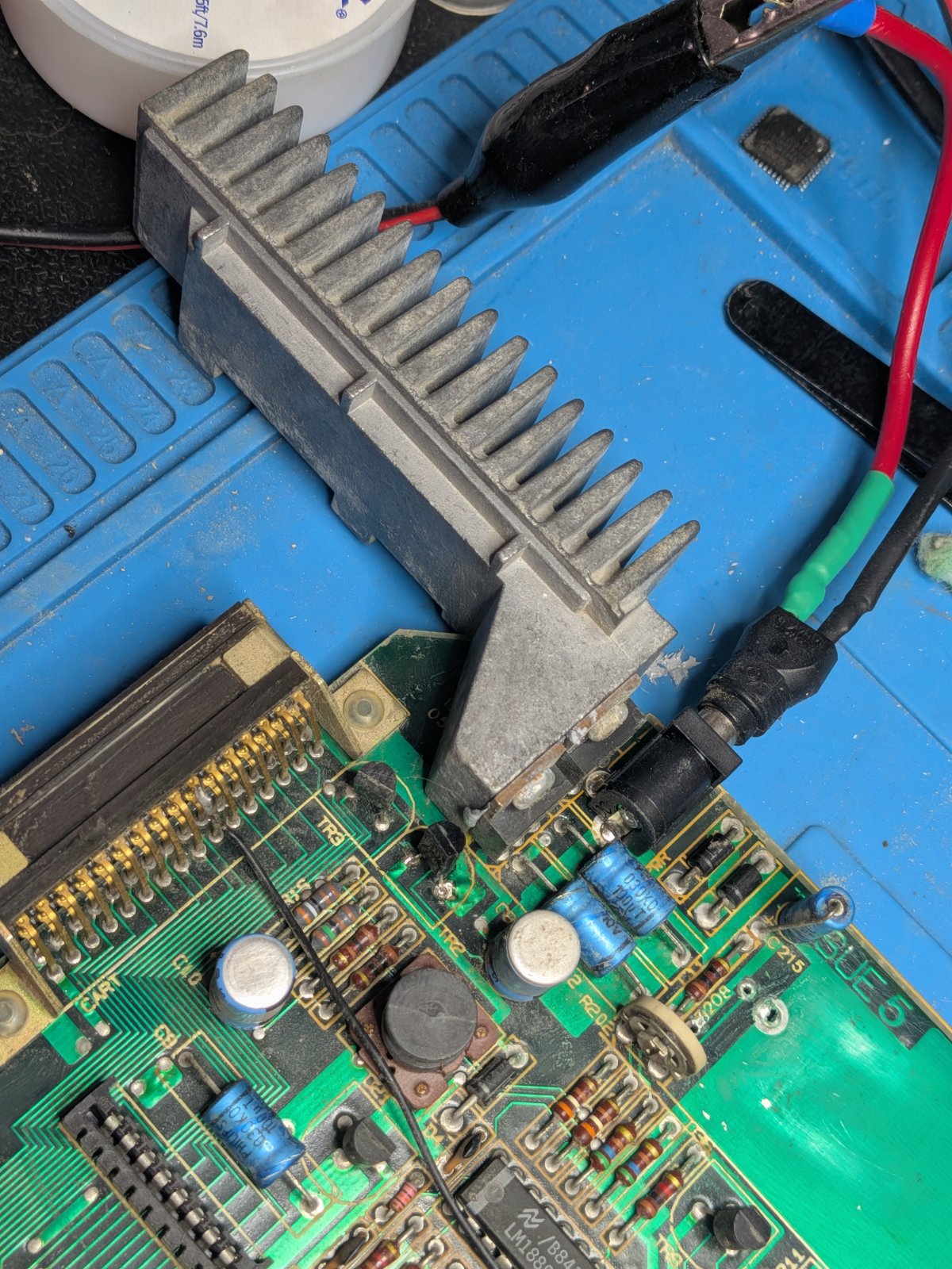

So a bit more tinkering and the membrane is mostly working, but ultimately shot, so I have ordered a replacement.
A few more bits done:
Heatsink removed and cleaned and a new power socket fitted since the old one was a bit erratic.
I also reassembled the heatsink with a little heatsink compound. No more crud in the fins either, so better all round.
You can also see the modulator is off so I can clean the can and also get any crud from beneath it. I'm considering, depending on how well the can cleans up, converting it to composite. Will see how that goes.
Mainboard is in need of more cleaning, but I'm wary of going too mad since it works!!!

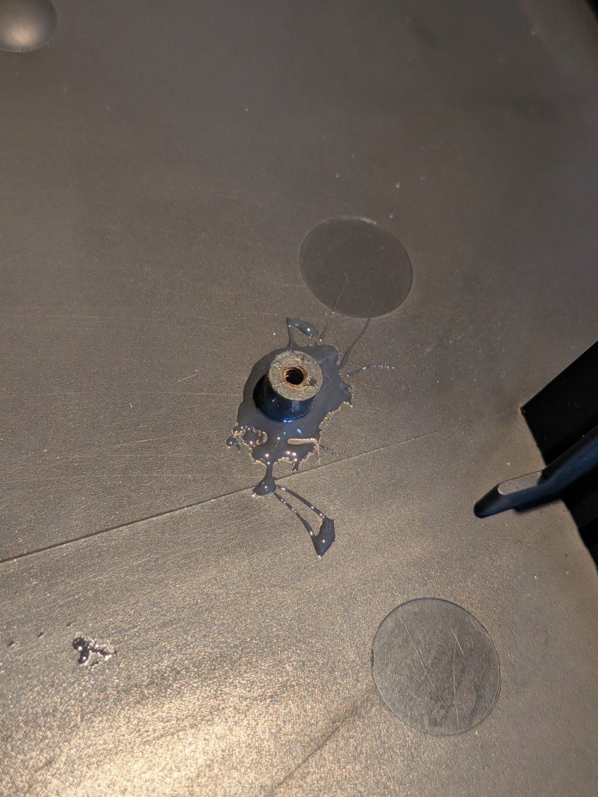

Also fixed the broken off PCB standoff:
- Posts: 7680
Why composite video when there's good ol' analogue RGB and stereo audio (needs a bit of amplification) on the monitor edge connector?
- Posts: 15537
That's just for now as its convenient for me, I will likely do something regarding RGB and audio later, but for now Composite is all I need.stephen_usher wrote: Thu Aug 06, 2026 3:34 pm Why composite video when there's good ol' analogue RGB and stereo audio (needs a bit of amplification) on the monitor edge connector?
I want to get the machine up and running and tidy first, then will do more
