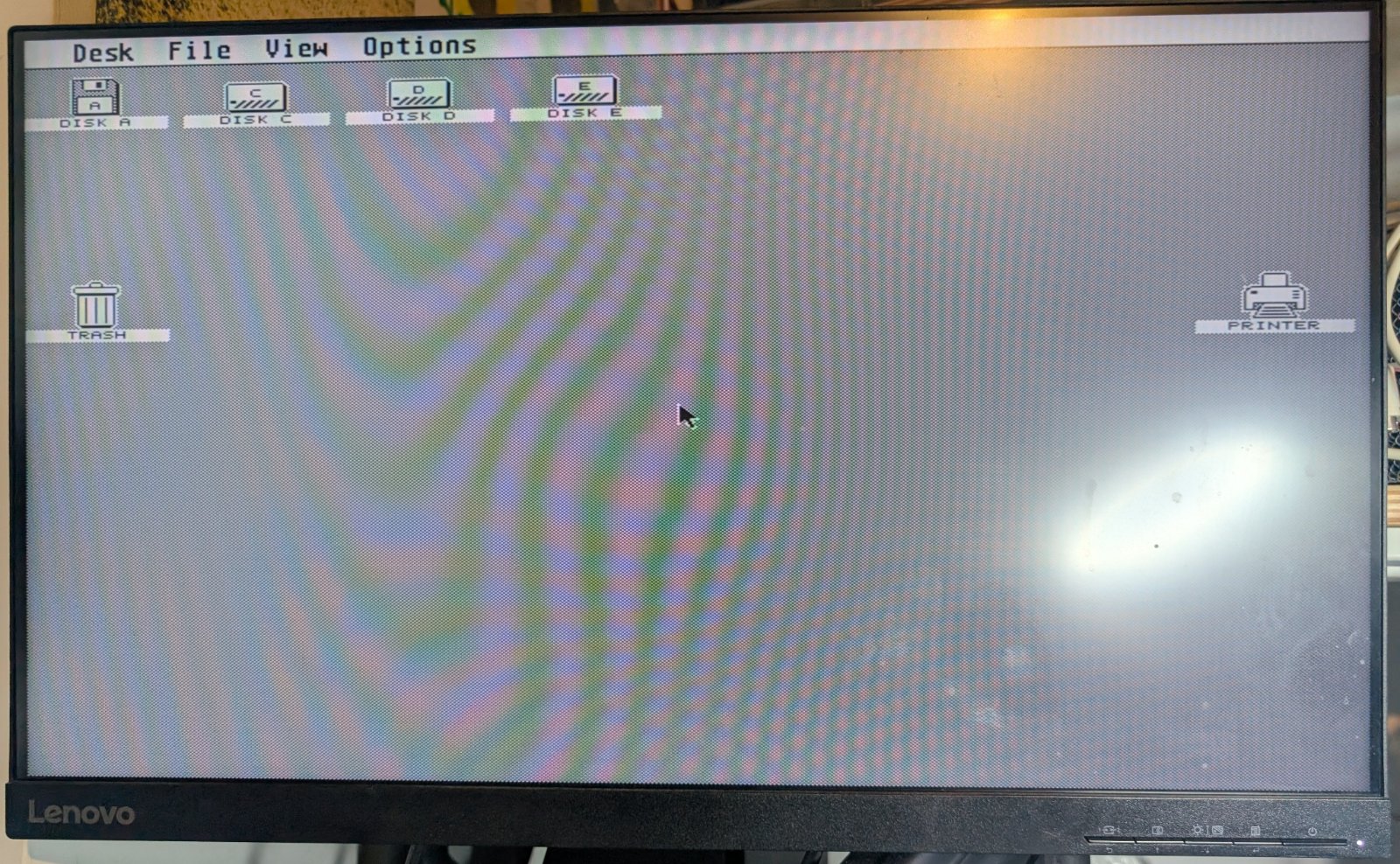

You mentioning frequency made me wonder if the 32mhz was just too slow for all the programmed timings,so I've fitted a 40mhz oscillator. I then set the cpu speed to x2 on J104 & J102 and I now have a proper desktop, although its a bit intermittent, I think the CPU or 68150 are probably crashing but I'll work from here and see if I can work out what's going wrong.
I'll post an update later on.
Thanks for your help so far Anders.

Okay I now have a consistent boot to Desktop but now have to get the Eiffel working. I'm not getting a ps/2 clock and am wondering if it's the way I've programmed it.
I've used a TL866 to program the PIC and left the fuses as per the hex file. Is this the correct way to program it?
Btw, pic of desktop soon to be followed by a working Raven I hope :lol:
Edit: The Mach32 now also works which I'm very happy about obviously :lol:

And thanks to a dodgy ps/2 socket, my keyboard and mouse are now working. I'll have to order a new one but at least I can now get everything like VGA drivers etc all working.
