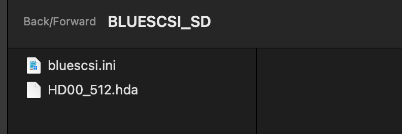

This is all you should see on the SD card when you're done:
Simple as that.
Obviously that is my HDA file, and yours may be slightly differently named as long as it follows the naming convention specified here: BlueSCSI usage
If you've done anything differently then you are wide of the mark.
Simple as that.
