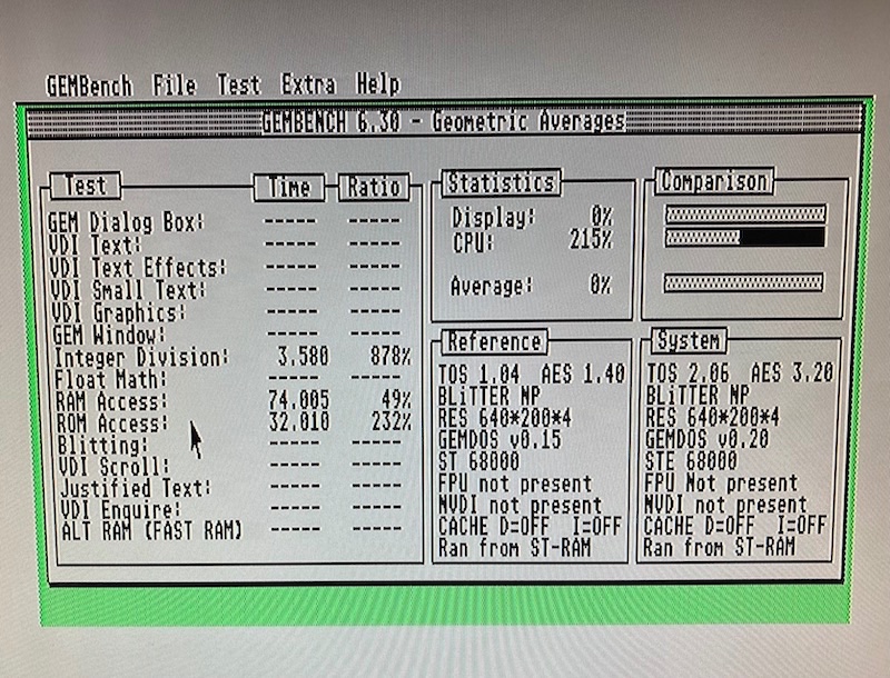

Very unstable ATM and obviously relies on that special EmuTOS. RAM access is very slow because of all those de-optimisations I've employed.
BUT disc access is now working:-
CPU speed is OK. ROM is mapped from the Pi so nice and quick. RAM? There's your problem.
Posts: 29813
Re: PiStorm Chat
Some good progress in any case :thumbup: Half speed RAM is like hello world in CPU land :)
