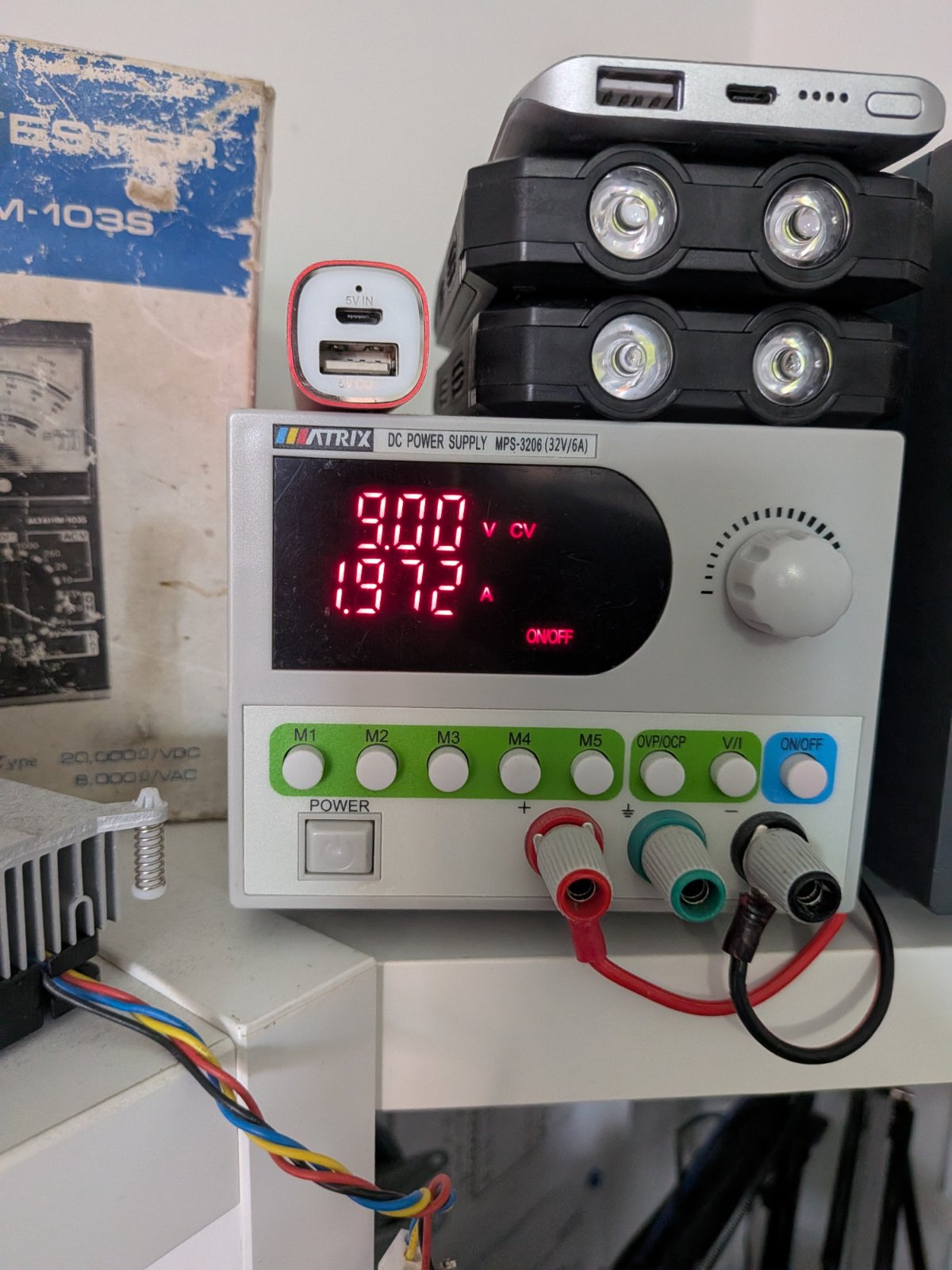

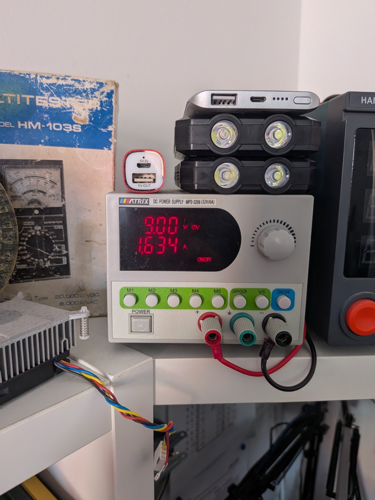

So the Pi Zero v1.3 arrived and power consumption is vastly improved over the 4B:
With the 4B and running the RGB2HDMI and FDD controller & Gotek with the game 'The Abyss':
And with the Pi Zero v1.3 running the RGB2HDMI and FDD controller & Gotek with the game 'The Abyss':
Thats considerably closer to how it was running without the RGB2HDMI and the FDD board before.
So a 300Ma saving. Not only that but the image quality on the program loader where it is colour cycling was a bit fizzy at times has also improved, so it seems the Pi Zero v1.3 is more than up to the job.
