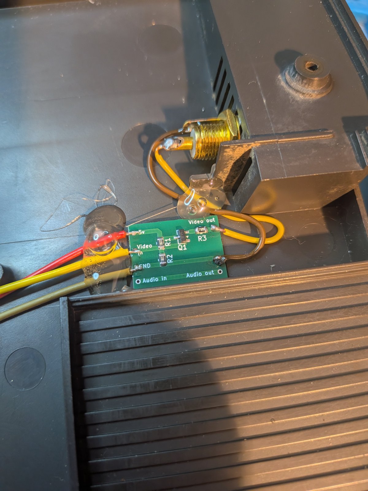

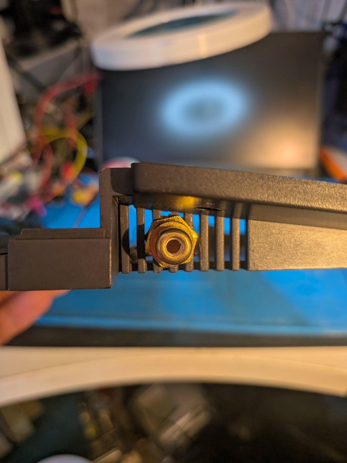

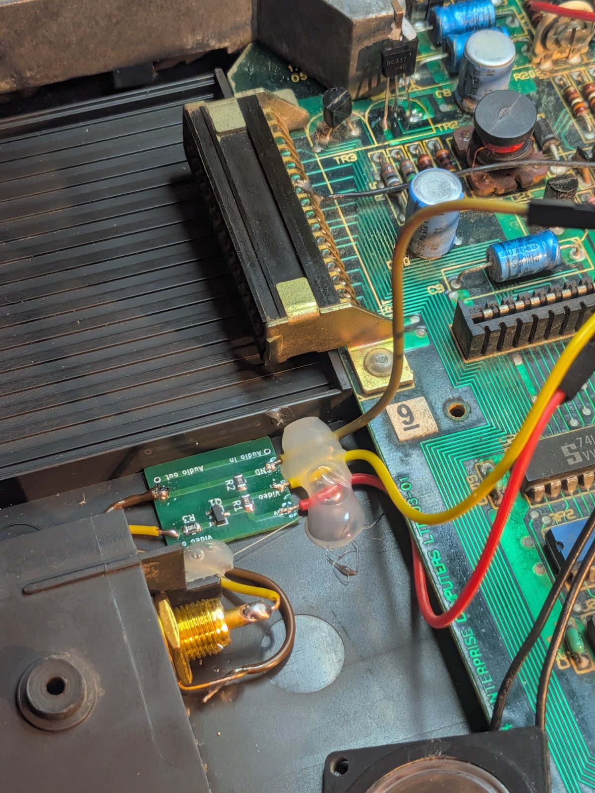

I also added composite out when I buttoned it up:
Picture quality isn't fabulous but it's fine for a quick hook up and at some point in the future I'm planning to try hooking up to an RGB2HDMI.

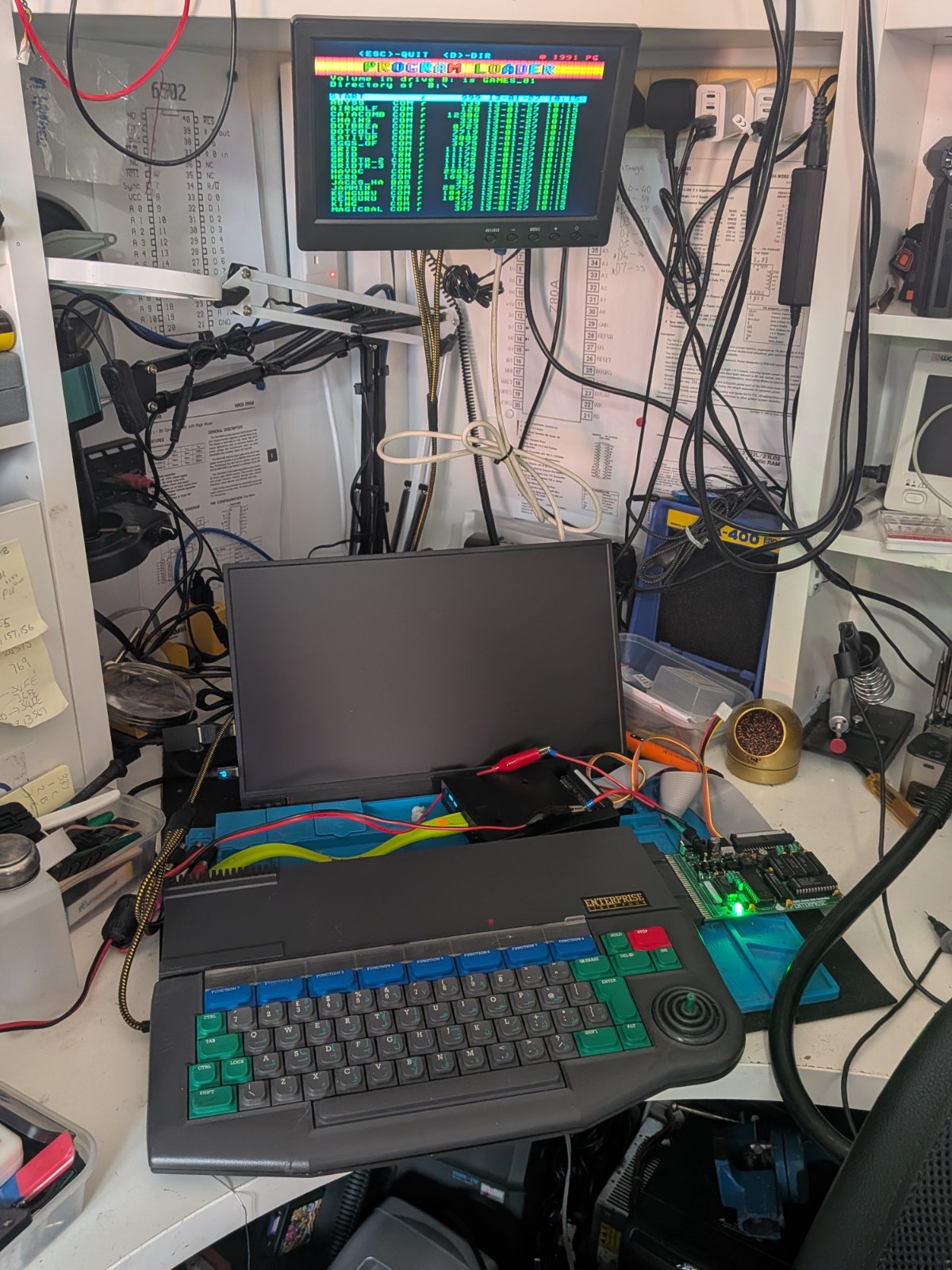

All buttoned up and running a treat:
512KB RAM expansion and Pear EXDOS FDD controller with Gotek. Also added composite out.
Pleased how far this machine has come and I'm considering getting another, its a fab machine.

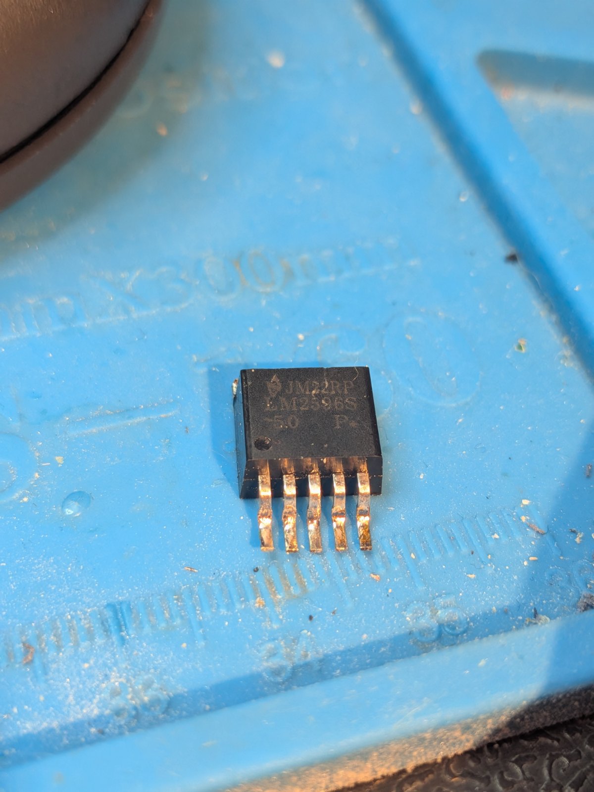

Well this is a bit annoying:
New buck converter fitted, it still doesn't work...
Also there seems to be a short somewhere...
More digging required.
