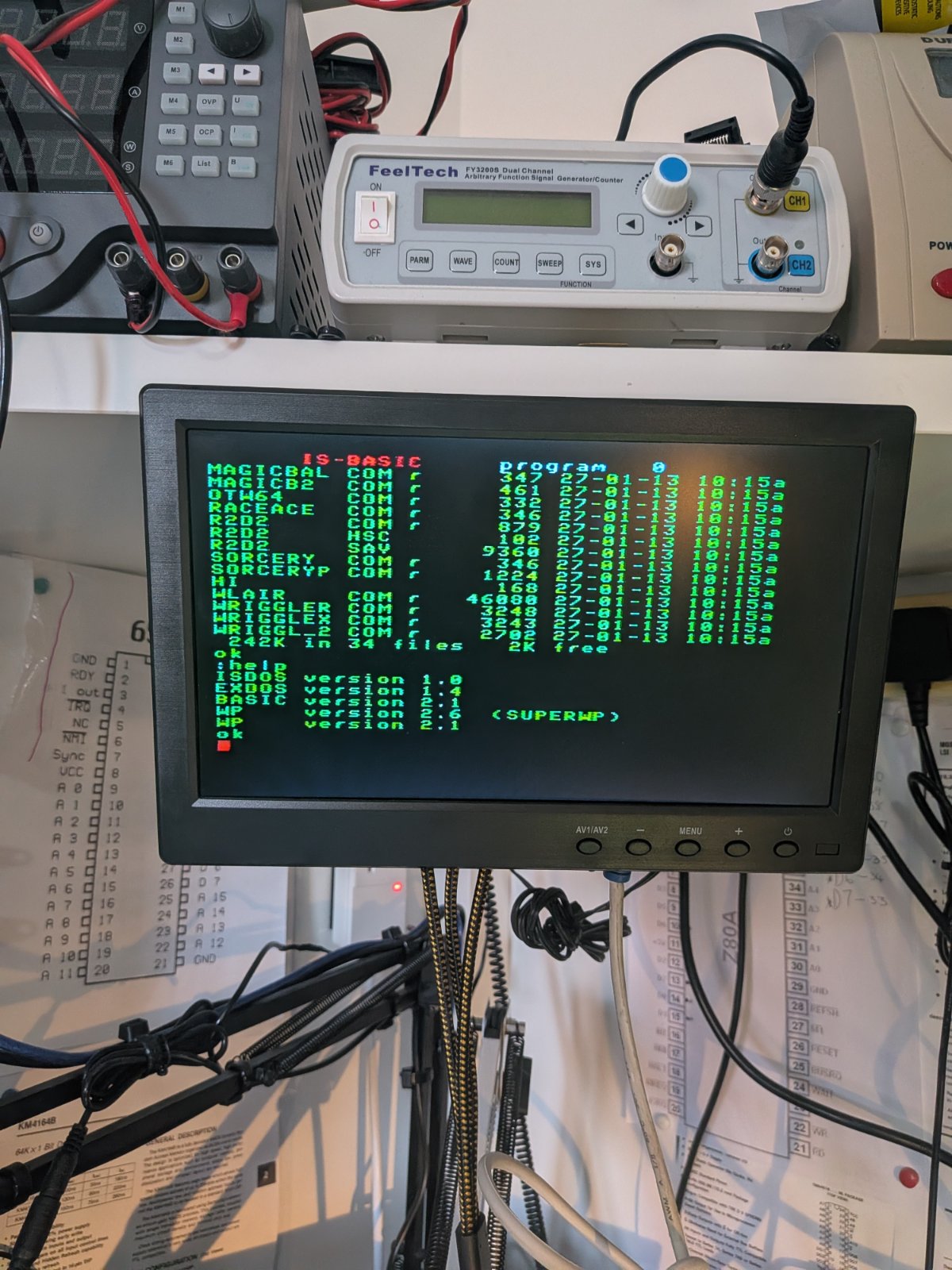

Coincidentally the FDD board now works:
The disk I have in does boot but gives an error and drops me to BASIC where if I hit F1 the loader then works and I can boot happily to the loader and pick games to boot and run.
Big leap forward but will the case fit ok with a socketed CPU? Did yours or did you not use a socket?
