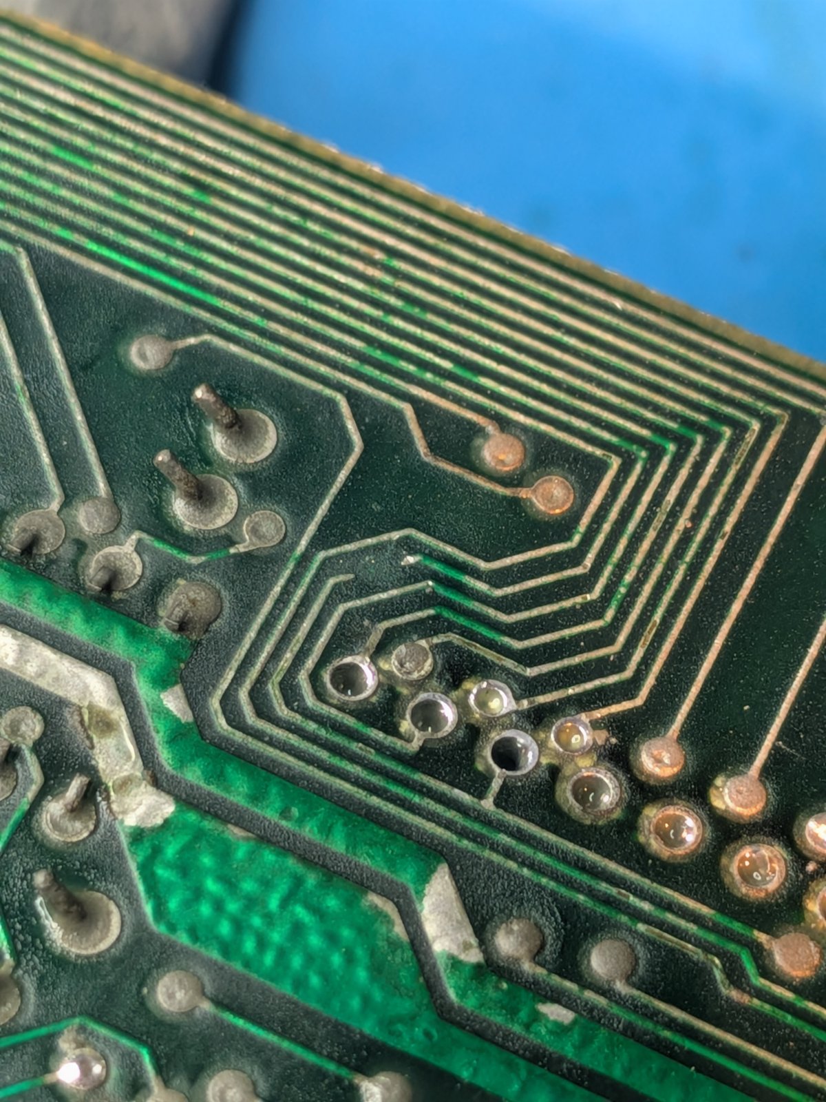

Oh, and I also found this near pin 3 of the CPU on the underside:
Which explains the bodge wire on the topside going from pin 3 to the ROM port. I'll fix that later.
