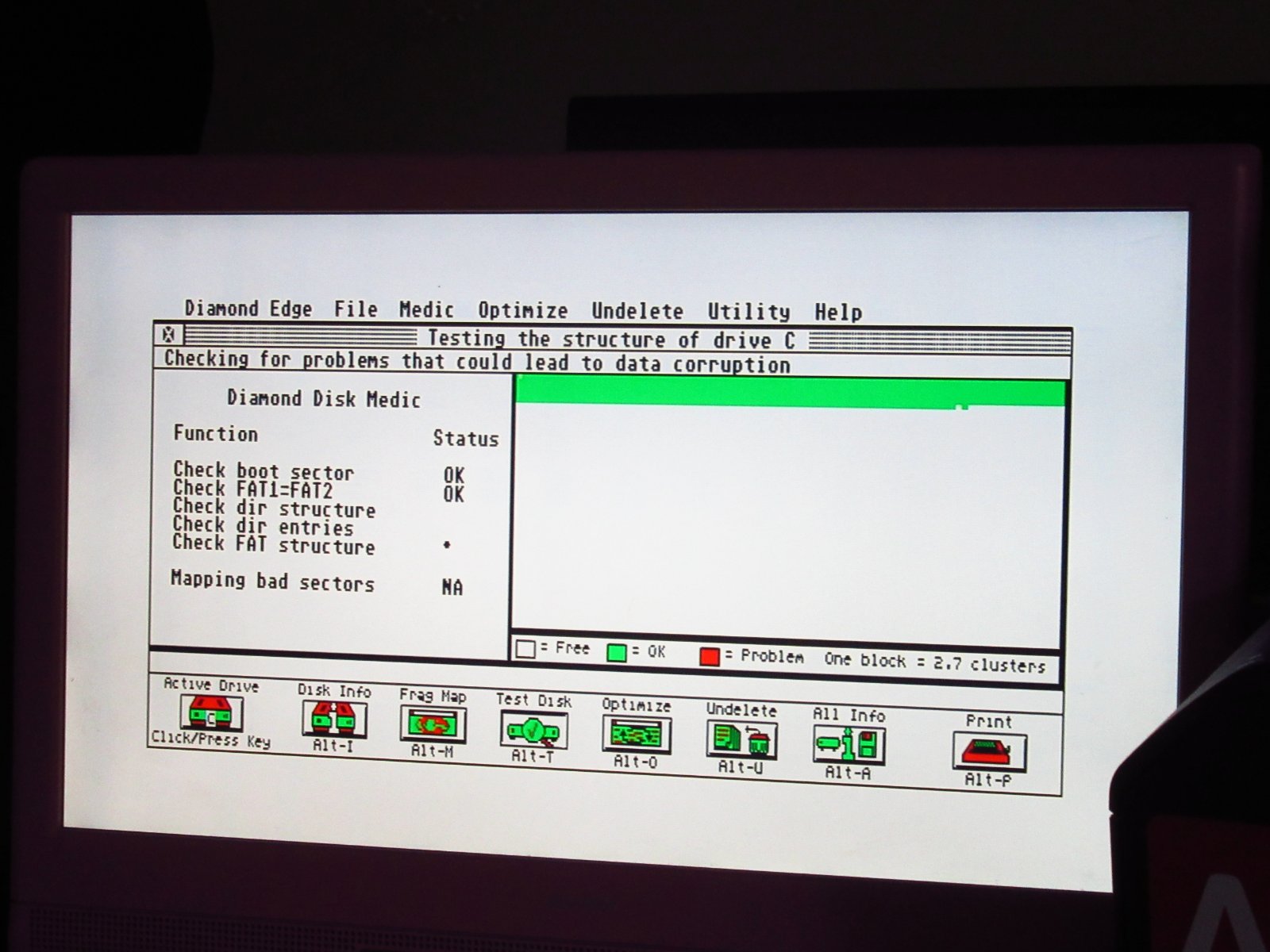

Found EDGE https://sourceforge.net/projects/diamond-edge/
It had me puzzled for a while. Seems it does not like trying to install from hard drive from a folder called EDGE! :lol: :roll:
Hello my old friend.
So this took rather a long time..
I'm not really sure why when I selected "FRAG MAP" Showed all green basically. But when clicking optimise the whole lot went RED for like 100% fragmented :shrug:
Anyway, the HDD LED is pretty much on continuously. So it is getting a good workout!
