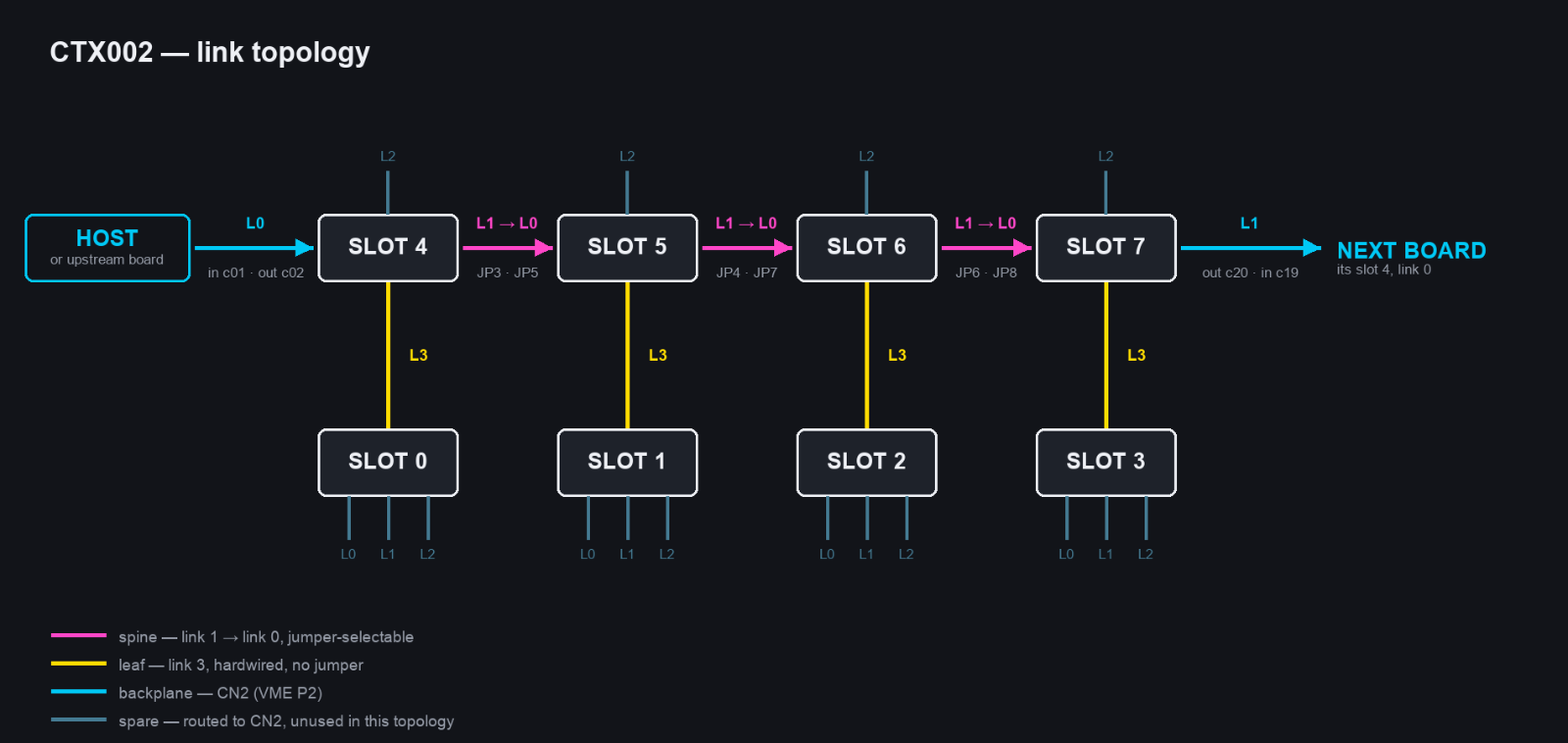

Next stage of de-obfuscation is the discovery of internally hardwired links between some of the Transputer slots.
The yellow paths show directly-tied slot connections tying two Transputers together on LINK3 on a single 'row', without jumpers or buffers. These are fixed topology, not configurable.
The magenta paths show additional direct-connections between 'rows' - but routed via jumpers JP3-JP8. These jumpers have two positions for each side (RX/TX) of the link. One position connects two rows together, the other 'BUS' position maps the links onto the VME bus.
For the non-bus connection, the actual link being tied is indicated on the jumper.
e.g. the jumper is named 'L50' and the non-bus position is 'L61' which ties TRAM slot 5, link #0 -> TRAM slot 6, link #1.
This reveals an internal topology shaped like a 'comb' or spine. 4 rows of 2, with the rows being fixed and the spine being jumper-configurable, on the right side of the board.

So from all of the probing/mapping work we get a Transputer network topology that is partly static, partly configurable.
The 'host' and 'next board' links are implied - not expressed on the board itself. Those links could be picked from any of the exposed paths but for connecting to an ATW800/2, using the L0->L1 spine as an extension of one of the ATW slots seems like a good option.
The JP3-8 jumpers could be opened and the whole thing unrolled into a linear chain - which simplifies programming a bit - but the repeating pairs can be an extension (nearly) of the initial pair on the ATW itself.
One wrinkle is that the EXT link on the ATW board comes from the 2nd slot (i.e. not the 'spine' - which would be the 1st slot) but that's a minor thing which can be fixed in the software or maybe a different link can be taken from slot 1 to keep it consistent....
So this is enough info to start playing with it. The next step is to experiment with a TRAM restored to the board and see if it will respond.
