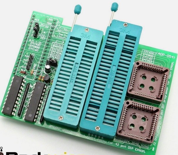

My Adapter should be here tomorrow...rather than buy one for my TL866...I ordered an ADP-054 for my GQ-4x4
It wasn't cheap but it does expand the range of devices I can read/program on account it expands the zif to include a 40 dip and a 48 pin dip plus it has 2 x 44 pin plcc ..presumably for both..eprom and micro.
I just hope the plcc chips I ordered are up to snuff..

The adapter has arrived but of course Im still waiting for those chips...which could be weeks away.
..and no guarantee they are any good...
they are almost certainly used 'pulls' ...but will they be any good ?
Possibly fake..
possibly faulty..
may even have bent pins which is often the case with aggressive treatment.
I dont suppose a forum member has one they could sell me so I can at least try out the ADP054 adapter ?
PLCC 27C4096 UV erasable
Didn't see any for sale on Exxos shop or I would have placed an order immediately.
