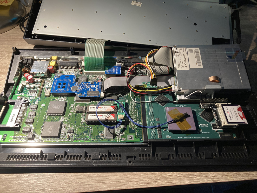

What happens if you test with the keyboard not fitted and the top of the case not installed.?
Can we get a picture of the machine with everything fitted?

Here's a pic of the inside with everything fitted: https://i.postimg.cc/DwghvChT/IMG-7699.jpg
Yes, the RTC works fine if TF1260 is not installed, OR if remove jumper 060-enable on the card. It works also with my TF1230-card.
