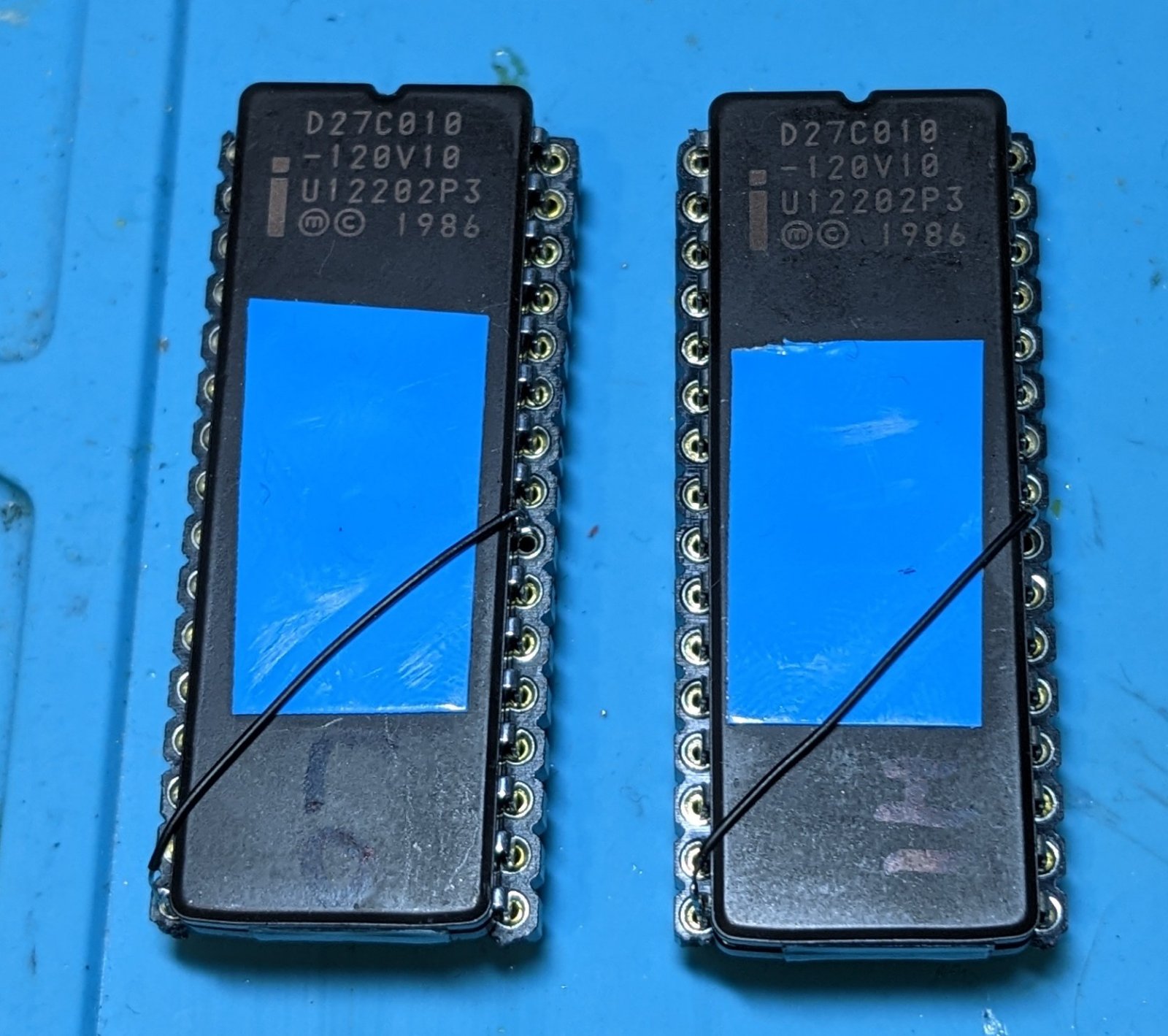

Today I wanted to update the TOS 1.02 to 1.04. I also decided to patch the ROM with WinX (version N) which basically adds all the tweaks and fixes for the OS (so you don't have to use any of Atari's auto program fixes) and it allows you to use the WinX control panel and utilities for a nicer GUI experience if you want (but not required) so I patched the ROM, split it into two files and burned two EPROM's. I then followed @exxos's GUIDE on modifying the EPROM's to fit in the smaller sockets (as they have four more legs)

Everything works great! Now finally ready to send back to @mrbombermillzy. I'm actually quite proud of my work on his machine and think it's some of the best work I've done.
