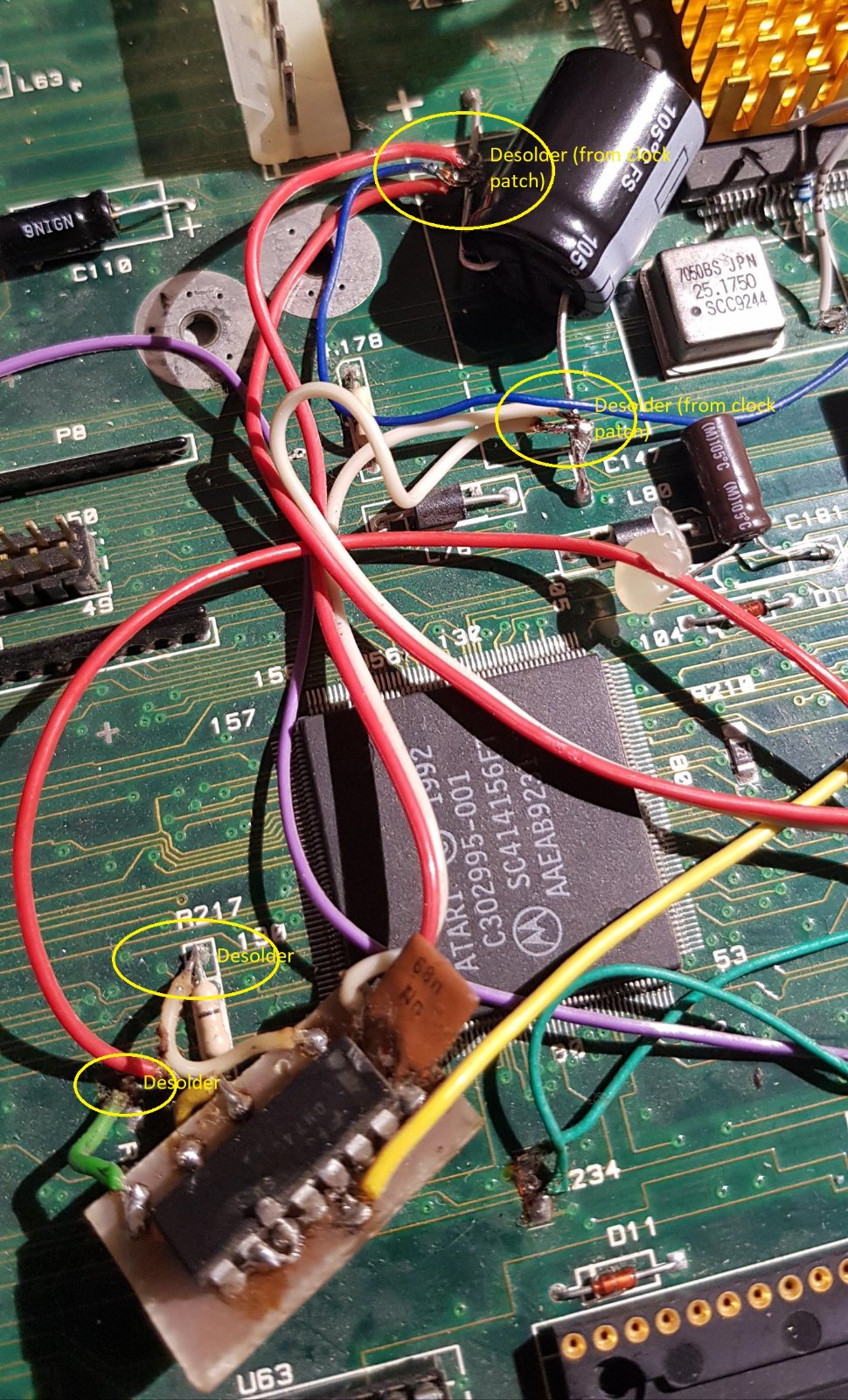

Please upload photos of your clock patch installation, both the patch itself and the SDMA area too :)

Steve wrote: Tue Feb 22, 2022 11:06 am Please upload photos of your clock patch installation, both the patch itself and the SDMA area too :)
Here there are. I have noticed that the in circle ones make contact.

Ok well you haven't 100% finished installing the clock patch yet:
June 1st modification towards the bottom:
https://www.exxosforum.co.uk/atari/last/ ... /index.htm
Example in one of my service blogs:
https://www.exxosforum.co.uk/forum/viewt ... =18&t=4813
Also the soldering does look a bit rough, did you use flux? I would de-solder the patch wires, clean the area with IPA and re-do personally. Your SDMA trace patch looks good though! :)

Wires rechecked and resistor installed. But the noise in SDMATEST remains the same.

Okay only other thing to do is turn the delay OFF on the patch. Just de-solder the solder bridge with some wick (on the patch pcb) Then re-test.
