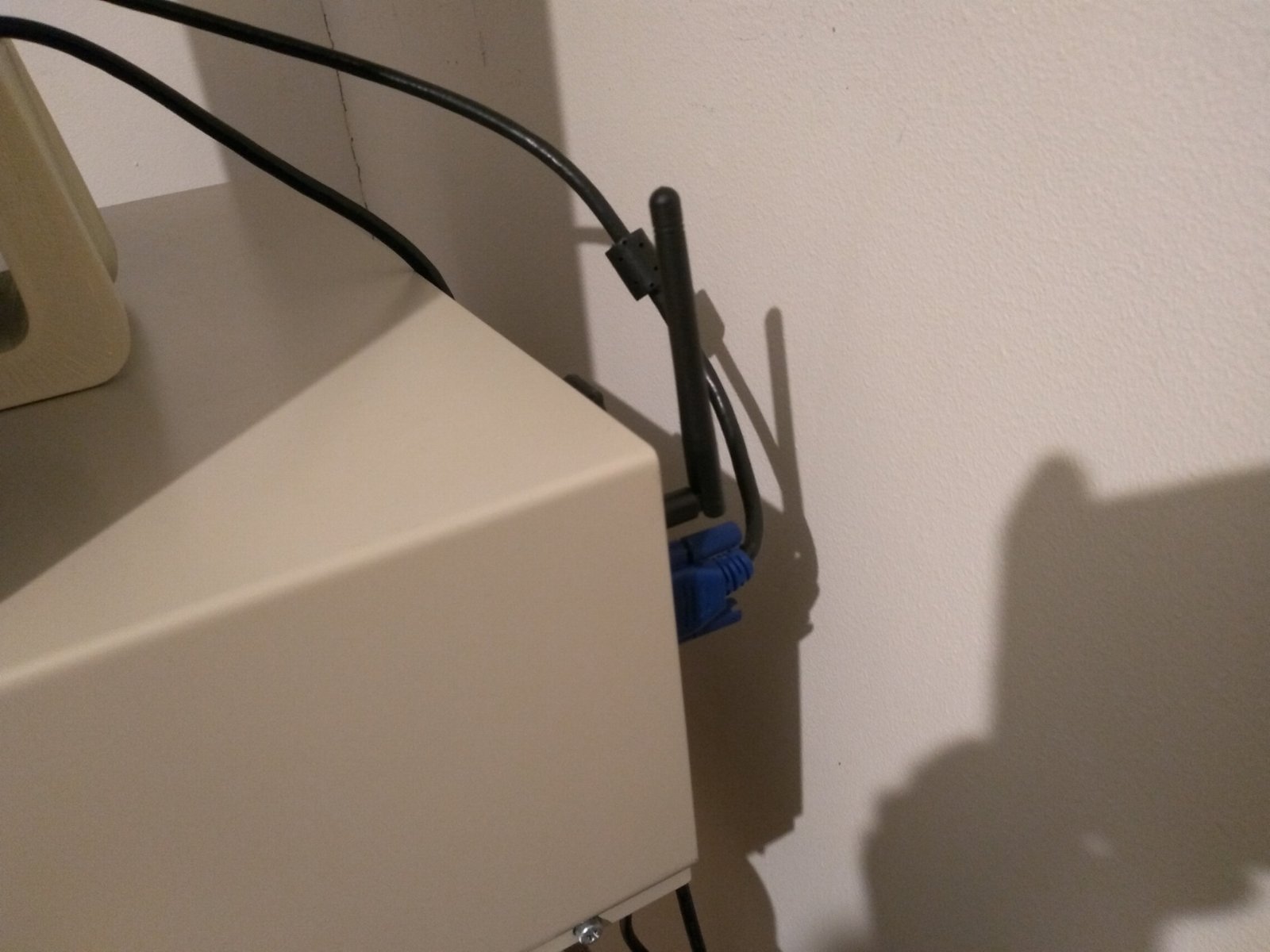

GianDO wrote: Thu Oct 15, 2020 11:31 pm You just confirmed what I understood. It seems like a good reason not to buy it .. Are there other A2000 scandoublers that use the video slot?
I made a card that turns the GBS 8200/8220 into an internal upscaler for the Amiga 2000. It fits both GBS models. It solders directly to the back of the board. A jumper selects RGBS or RGBHV. A 3D printable case aligns it with the back of the case and has a holder for a D1 Mini Pro ESP8266 and antenna for access to GBSControl via WIFI to change settings. It works great. Add a clock generator too for best performance: https://github.com/ramapcsx2/gbs-contro ... e-Hardware
https://www.pcbway.com/project/sharepro ... nally.html
Installed on a GBS8220 that I have experimented and played around with. It's not necesssary to remove the connectors I have removed here.
Great picture quality with options to move, scale and mask.
The final version.
The final version.
I made another one.
I made another one.
