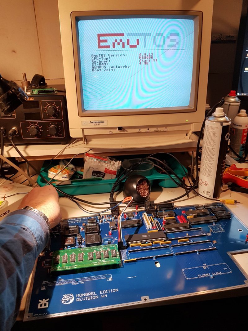

OK, i connected my trusty C=1084s, connected my Lab PSU (current limiting to 1.5A) and fired it up:
- no magic smoke
- solid white screen output
- no little green desktop
- no reaction to reset button
ah! forgot the Falcon RAM board ...
but the same solid white screen. My TOS ROM is the one from the Exxos STE ROM switcher,
with 2.06 and EmuTOS in it.
Will start troubleshoot tomorrow, or monday.
- no magic smoke

Re: will it compute? btl's attempt to build the H4
Oh my!
i just programmed my EPROM, non-byteswapped TOS1.04 and byteswapped EmuTOS.
It didn't change anything, so i started the Troubleshoot according to the H4 Troubleshoot thread.
When i pressed and held reset in order to check the Reset Line, the little green EmuTOS desktop
came on the screen!
So my reset switch is other than expected or my reset IC is doing the opposite as requested.
After switch on, i need to release the reset switch for a second, then hold it for the System to boot.
Therefore, besides my reset curcuit issue, and me using the wrong TOS Chip due to reading too
little of existing info, this was a no troubleshoot, instant booting H4 board.
And yes, i run it with a 64-legged horse in the expansion slot!
Lets connect some keyboard...
greets,
btl
Are you missing the jumper in the Flashy Clock socket area? That may be affecting your reset behaviour.
