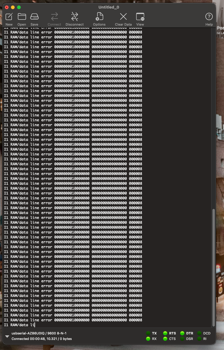

Re: 4MB RAM upgrade for C103414-001 Rev 1.1 (520/1040 STFM)
Connect with another computer via null-modem-cable to get output from diagnostic cartridge. RS232-USB to PC for example also work with a terminal program.9600 baud,8N1 (8 data bits, No parity, 1 stop bit). No flow control

thx! it works, an endless error message...
Looks like bit 7 is wrong. Written a 1 and read as a 0. Since you have nothing on screen it's bank 0. So chip U4, DQ4 (pin 25).
But I don't have schematics for that board so check with a multimeter that it's actually bit 7 on bank 0 that is U4 before you desolder it.
