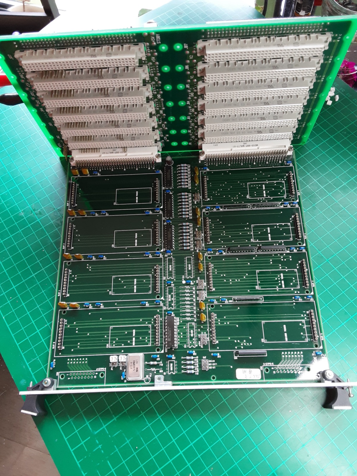

The next incremental step towards desk-flames was to plug the thing into a VME backplane - one that is not designed for it at all - and see if I could find any compatibility problems with pinouts/conflicts. Especially the power hookups.
I beeped out various points and confirmed 5V/GND where it should be expected and nowhere it wasn't expected. I wasn't really exhaustive with that but it was 'good enough' for the next step.
I obviously removed all the TRAMs before taking things further in case of accidents. They were bolted down with extremely annoying nylon bolts with some 1980s version of nail-varnish-threadlock stuff. I got most of them off by applying IPA and cracking the varnish with pliers before attempting to remove them. A few 'died' in the process when I ran out of patience.
I powered the backplane from a 5V bench supply. The backplane has nice chunky power terminals with big bolts. That might come in handy later.
...especially since the backplane alone sucks more than an Amp just for termination.
Anyway nothing blew up yet and I could see power at the correct points on the ICs etc. Good for the next step....

The next small step in the adventure - confirm the local 5MHz oscillator is appearing on the clock pin of all 8 TRAM slots.
...which it is!

Next update in my journey towards a desk-mounted-smoke-generator...
There are a bunch of mysterious things on the board (some more mysterious than others) which need de-confused before I can put this near my Atari.
The PAL chip was the most concerning part because if I do something wrong and blow it up, I can't replace it. It might also be a show-stopper for using the board at all, without cutting lots of traces and using it as a convenient peg-board instead of its intended topology with the VME connections etc.

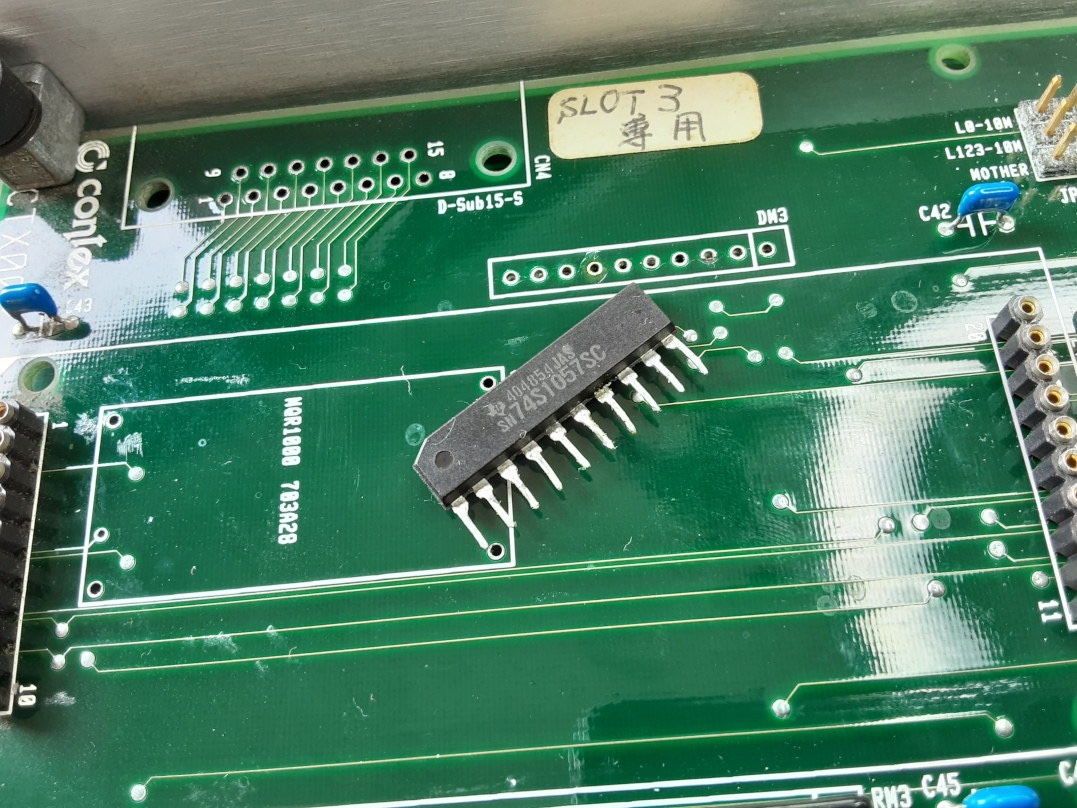

There are also 3 ICs marked DM1/DM2/DM3 which have the part number SN74S1057SC.
Searching for this produced results ranging from 'vague' to 'not even close, thanks'. I managed to trace out what these are connected to but results did not make much obvious sense. It was wired as if operating as a buffer for inputs but seemed to be exposing both buffered and unbuffered versions of the same signals on the external connector.
Will come back to this one later.
There are three 74BCT244 buffers on the board tied to a bank of resistors. With some DMM probing I mapped some of these to the external VME P2 connector and to links on the TRAM slots so those are there to buffer link signals on the bus.
Given the total number of connections on the board I did not probe everything exhaustively but took samples from various places to try to build up a pattern of which things were handling which signals and especially numbering patterns that could allow me to predict the un-probed ones.
I started the process using a wire-wool cleaning sponge as the 'search' probe with the other probe either at GND, VCC or some point of interest. This narrowed things down quickly. I could change the sponge to a 1cm metal brush to sweep pin rows more easily and find where on the row the signal was.
There are several jumpers on the board, all clearly marked. The meaning of some could be (partly) figured out directly from the markings, some pretty vague and I had to guess and probe around a bit.
JP3-JP8 are adjacent to some of the TRAMs and the markings (Lxy) seem to point at making/breaking links between them or exposing them to the VME - which would make sense.
JP9 is ore of a 'global settings' switch to set serial link speed for some links and may configure the board in a master/slave config from the VME perspective.
Next update will show what I found from the probing, what those DM1/2/3 chips are, what the PAL is actually doing and begin to build up a topology....
