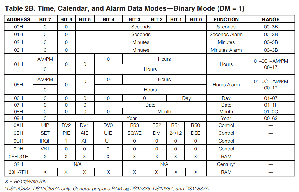

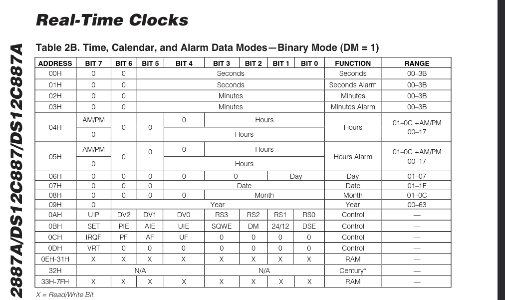

Ok, as the code 'worked' apart from the year, lets start with that.
Looking at the spec sheet you posted:
We need to focus on register offset $9h (although either the sheet has errors, or I have not noticed where it explains why it says 'range 0-63' instead of a 0-127 range - 7 LSB bits seem to be valid entries according to the the right side of the chart(?) and also, we need 7 bits to reach up to the number 99).
Theres a BCD coded register ($32h) which automatically writes a value of 20 for the century, so it looks like we can leave that alone.
Ok, now we have some sort of idea whats being set where and in what format, we can look at the code and see.
Im going to concentrate on the code directly before my first reply, as it seems to be the closest to fully operational.
Bear with me and I will come back to this later on.

@mrbombermillzy AI think ive confused DM=0 with DM=1 now.
My basic code had
POKEW (RTC_ADDRESS&),&B1111111100001011 ' SET ADDRESS 0BH
So bit 2 (DM) = 0 .
AI is just doing the changes and masking the bits properly..
My basic code had
So bit 2 (DM) = 0 .
mrbombermillzy
- Posts: 2445
- Joined: 03 Jun 2018 19:37
Re: Converting HISOFT to 68K ASM "almost" works
Trying to keep up with the edits... :lol:exxos wrote: 09 Feb 2026 18:32 So the 255 add would be to clear the high byte as I assume nothing is connected on that half of the bus, so it returns all 1's. I just added 255 to zero the result.. Lazy I guess more than anything, but should likely all be subtracted I guess.. or just written better.
No, adding 255 does not clear the high byte. It would just be the equivalent of setting a carry flag.
To really clear the top byte, you would have to do something like 'and $00ff,d0' to d0.
exxos wrote: 09 Feb 2026 19:03 @mrbombermillzy AI think ive confused DM=0 with DM=1 now.
My basic code had
So bit 2 (DM) = 0 .
Im not familiar with Hisoft Basic, but it seems you are ANDing the high byte and some of the low byte (bits 0,1 and 3).
Edit: and I dont know what DM is. :)
- Posts: 29881
- Joined: 16 Aug 2017 23:19
- Location: UK
Its the "Decode mode" I think..mrbombermillzy wrote: 09 Feb 2026 19:05 Im not familiar with Hisoft Basic, but it seems you are ANDing the high byte and some of the low byte (bits 0,1 and 3).
I am trying to figure out what mode my RTC setter program actually sets at this point..
mrbombermillzy
- Posts: 2445
I dont think you are setting DM anyway. You seem to be setting SQWE 24/12 and DSE. (Whatever they do!) :lol:
- Posts: 29881
- Location: UK
mrbombermillzy wrote: 09 Feb 2026 19:13 I dont think you are setting DM anyway. You seem to be setting SQWE 24/12 and DSE. (Whatever they do!) :lol:
POKEW (RTC_ADDRESS&),&B1111111100001011 ' SET ADDRESS 0BHbit 0 and 1 , 24 hour clock and daylight savings enabled. rest is turned off.. dont care about it..
- Posts: 29881
- Location: UK
I don't get it, value returned is DM=1 according to the AI code..
mrbombermillzy
- Posts: 2445
Ive just checked (in case the values are reversed) but it seems 0=BCD and 1=Binary mode.
So as far as I can see with the above bitcode pattern: (00001011)
and the table:
DM is set to =0. Despite what AI says. :)
Try setting the bitmask to 00000111 and see what happens.
You may well be trying to set the year value in BCD format.
and the table:
