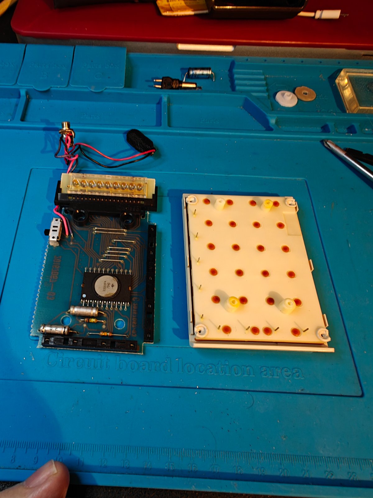

So I pulled it apart and it's a fairly simple single IC model with a few discrete components:
The button matrix seems fairly simple with 4 connectors across and 5 vertically, so checking the necessary pins showed the decimal point button to be working.
What weren't working were the two electrolytic capacitors which were reading low and had turned into a resistor respectively. I'll fit some new ones later.
