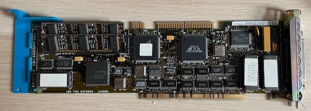

MCA SCSI card containing some cache memory and proprietary internal and external connectors:
