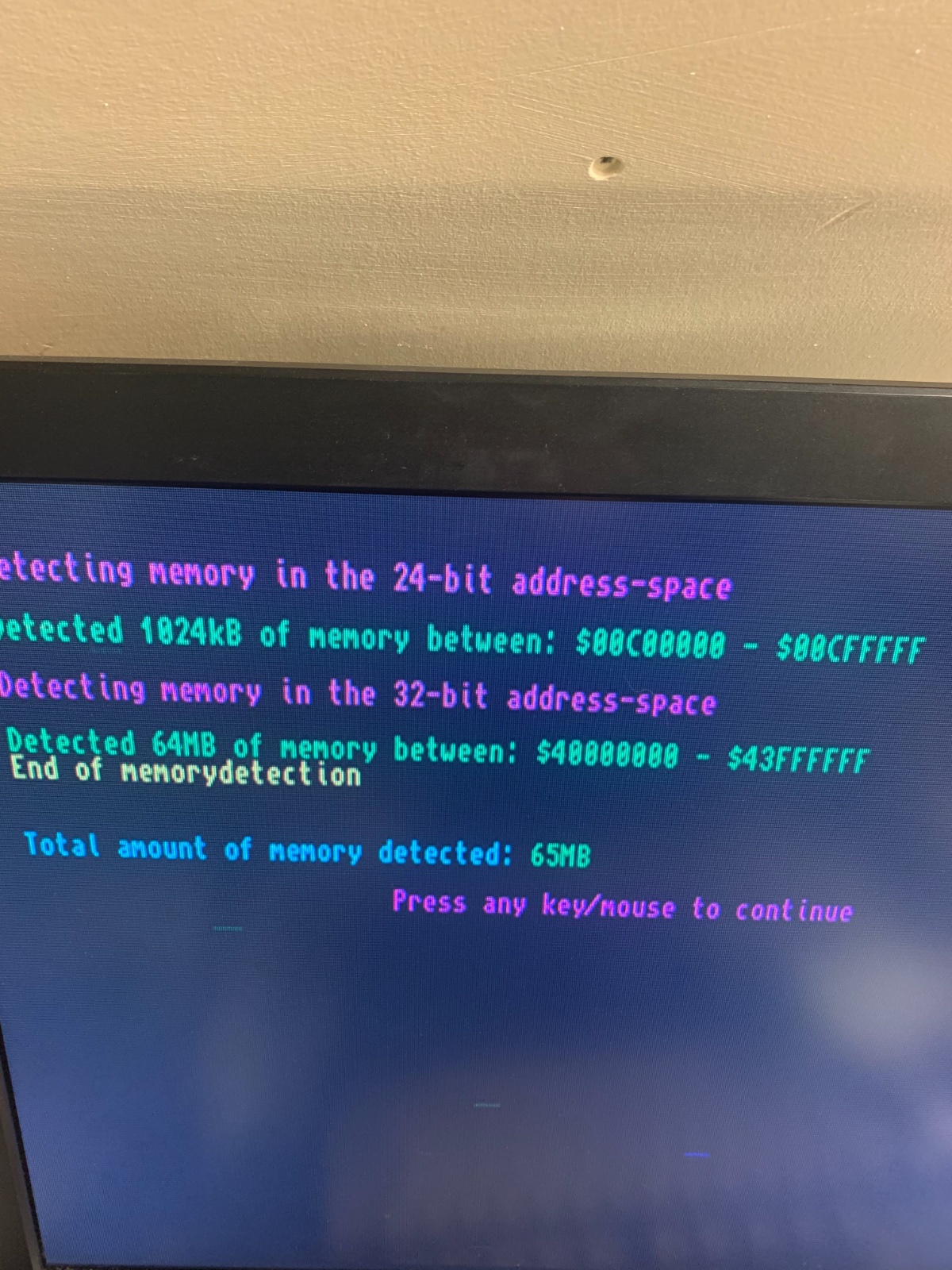

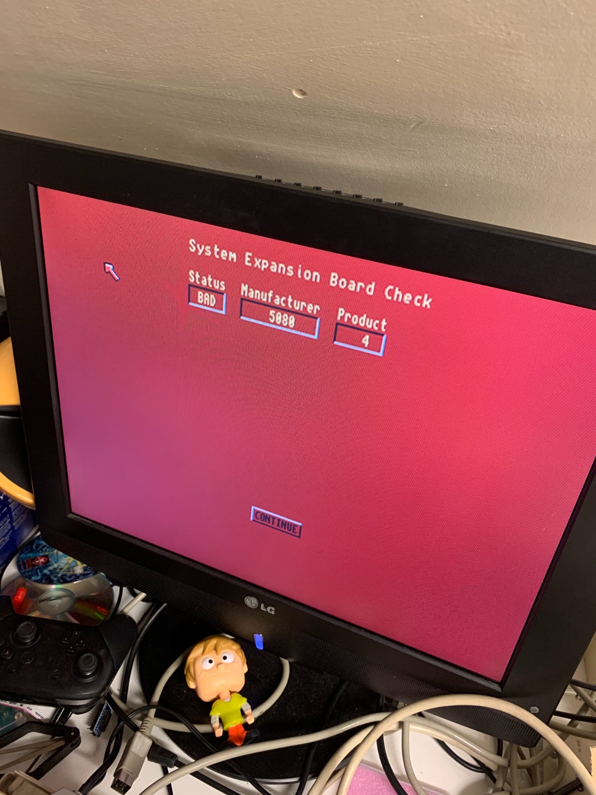

So it’s all finished and kind of working but it’s not right, takes about 15 seconds to boot, lots of artifacts and populous 2 plays about 100 times faster than normal

I’ve just removed the RAM and it’s still the same.
Any suggestions?

It works fine with the original cpu. I’m going to pull one of my other Amigas out and try it

Does this in one of my others

Boots diagrom fine with no artifacts
