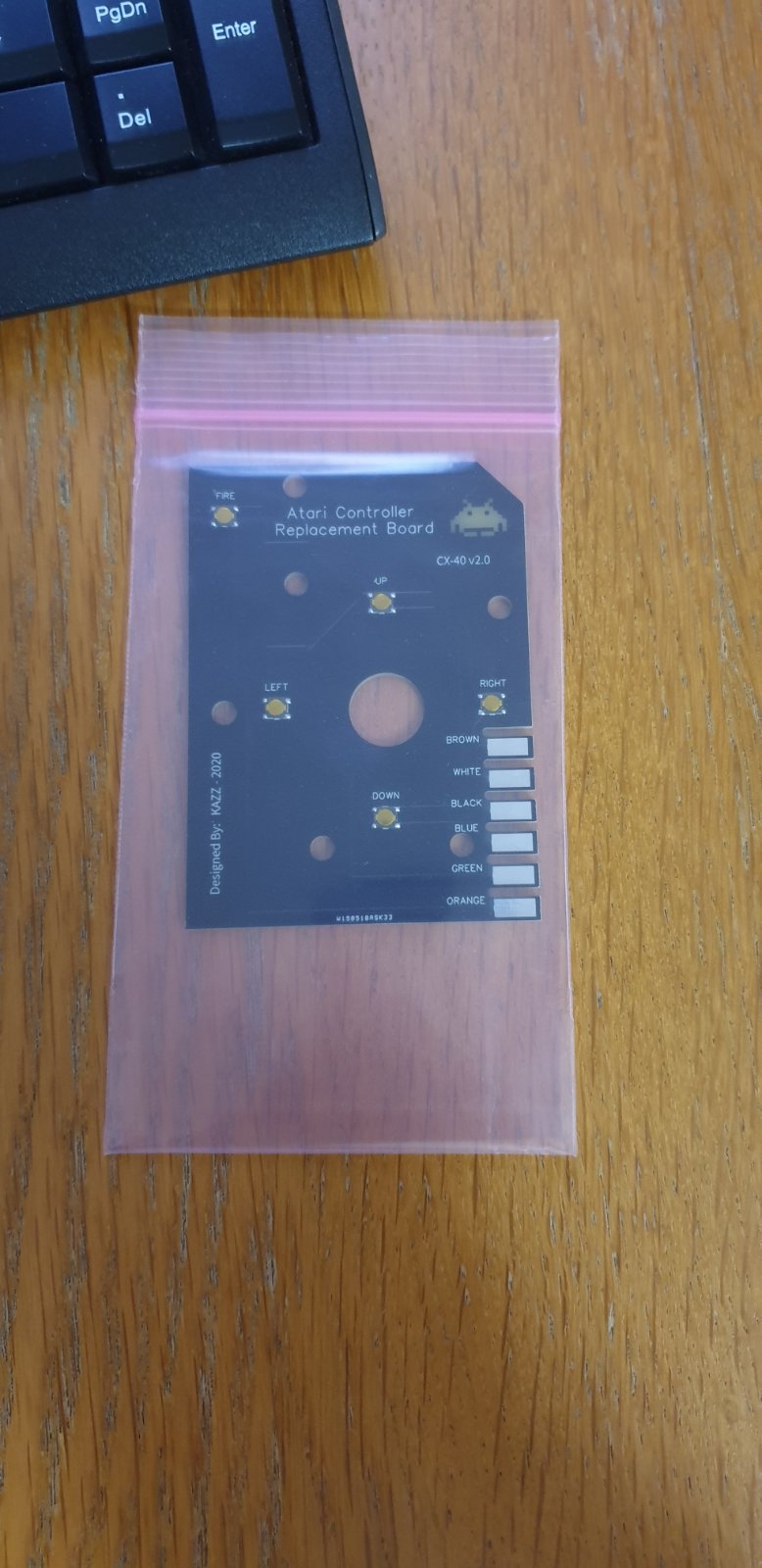

New PCB ordered. So the replica controller is good with the main column replaced with an original spare, and I'm guessing the original controller is good with the PCB (and therefore switches) replaced.

Okay, so this came in January:
Fitting was straightforward enough (though I used pliers as it was sore on the fingers):
However I had problems with the right side not working and tried to see what was happening:
As you can see, with the switches being smaller it's near the edge of the switch.
The other 3 axis are excellent. Very responsive. More so than the original switches which is what I was hoping for.
I spoke to the maker and they seemed to think it was the plastic points on the casing being out and offered me a refund.
I didn't take it as the right side of this controller was problematic to begin with.
Also I tried the 2 types of white stick I have and both had the same result.
