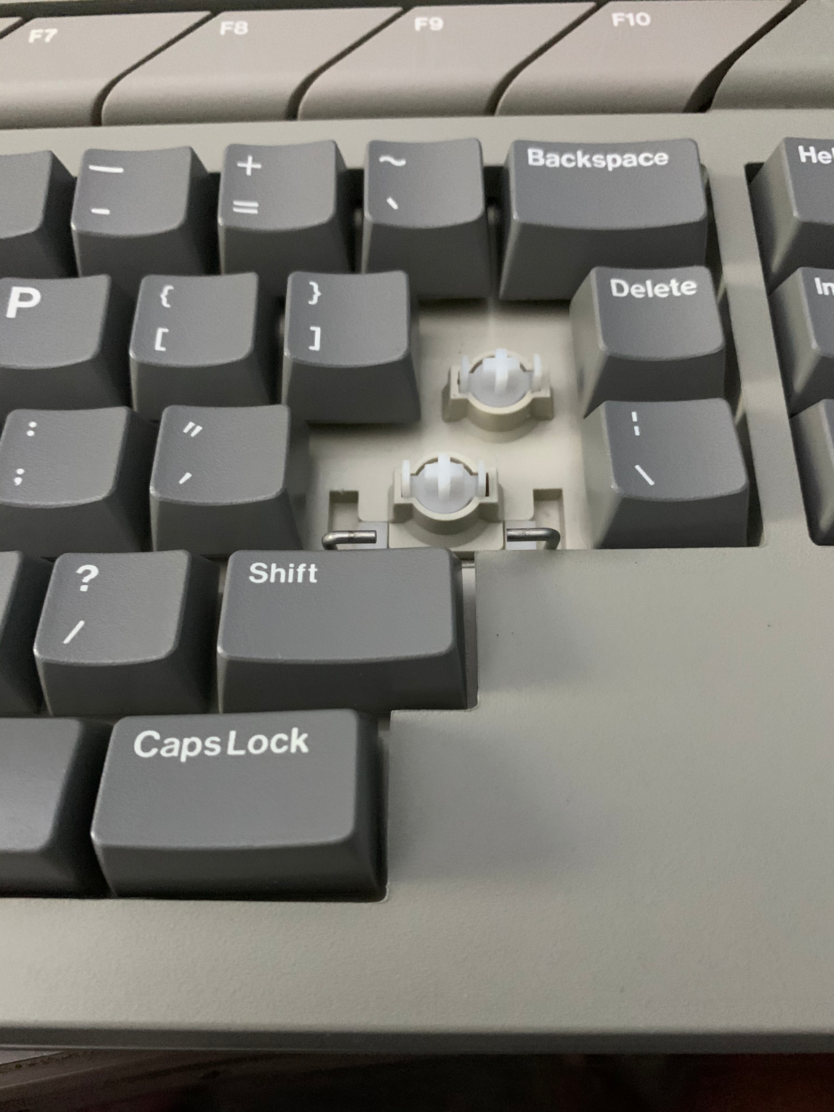

Gyrussfanx wrote: Sat Jul 25, 2020 1:50 pm It has an ST keyboard (it seems)
I'm curious what makes you think it has an ST keyboard? No stock ST keyboard was ever dark gray like that. That is the normal color for a Falcon keyboard and I don't see anything obvious that would make anyone think that it is anything other than a U.S. Falcon keyboard. It seems obvious that the machine probably did not start life as a U.S. Falcon, but I see every reason to believe that the keyboard was swapped for a U.S. version of the Falcon keyboard.

So when I received the item the return key was not attached to it's stabilizer bar so I used a key puller and removed it so I could slide it back underneath. That's when I noticed the keyboard was WHITE not GRAY underneath and also the key itself underneath is white. They are totally painted. They look fantastic though but I don't think this is a real Falcon keyboard. I could be wrong. Checkout the images below. The item number is pictured.

Gyrussfanx wrote: Sat Jul 25, 2020 7:40 pm So when I received the item the return key was not attached to it's stabilizer bar so I used a key puller and removed it so I could slide it back underneath. That's when I noticed the keyboard was WHITE not GRAY underneath and also the key itself underneath is white. They are totally painted. They look fantastic though but I don't think this is a real Falcon keyboard. I could be wrong. Checkout the images below. The item number is pictured.
Hmmmm...
Maybe. It's certainly possible I guess.
Still, why in the world would someone paint the inside wall of the key caps? I mean, I could see painting the outside of the key if they had an ST keyboard and wanted to paint the keys to look like a Falcon keyboard, but why would they go to so much trouble to paint the inside? And those look like real Atari fonts on the keys. If they'd painted the whole key caps, they'd have had to put stickers on the key caps afterwards. My eyes aren't what they used to be, but I don't see any evidence of any of that. It's possible though. If someone painted those, they did one heck of job on them.
I did look up that part number as well. I only found a few references to C070777-002, and they all seem to be point to that being the part number for the German Falcon keyboard. I that's the case, I think you may have a legitimate German Falcon keyboard, but someone painted the keys and relabeled them to match their U.S. version counterparts. I'm assuming that you can use a different country's keyboard and that the key mapping is controlled by TOS like it is in the ST line.
It's definitely an interesting mystery either way.

An original ST keycap is just the opposite: dark plastic on the inside, light plastic on the outside.
I guess a Falcon keycap is just the other way around with light plastic on the inside? I don't think it's painted and you're therefore wrongly "accusing" the seller. Maybe a Falcon owner can confirm by posting a photo of a keycap of his?
