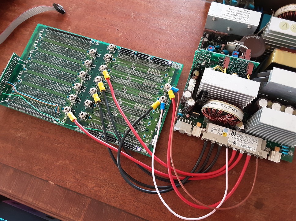

One problem with this is the connector is a big unobtanium thing with metal teeth and a bit too big to solder directly at normal temperatures, without also starting to burn the wire insulation as the copper strands sink the heat very fast.
I decided to use indium-tin solder which melts around 150'c and I was able to keep the iron under 200'c and still make a decent joint.
There will be 3 current-carrying wires for +5V/GND each and two smaller sense wires for feedback, carrying no current.

This morning, power issues have become a historic footnote in the journey of >> The Atari Compute Surface <<

exxos wrote: Sat Sep 05, 2026 10:18 am Its a real project now its got wires dropped over everywhere :P
I do like my spaghetti wires :thumbup:
It's impossible to move now of course because of the short chonky cables but it'll be fine for the next few steps.
