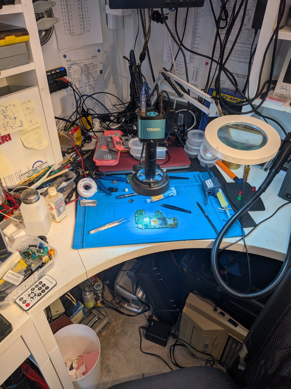

Well.
The SD card slot finally stopped working on my Switch Lite, so I ordered a new one, and now I'm sitting looking at it all and wondering why we need 0201 sized resistors because no matter how hard you try, they seem to just jump off the board at a moments notice...
This is where I'm at...
Just so super small my head hurts... At least they are back on and I can look at the SD card slot again...
