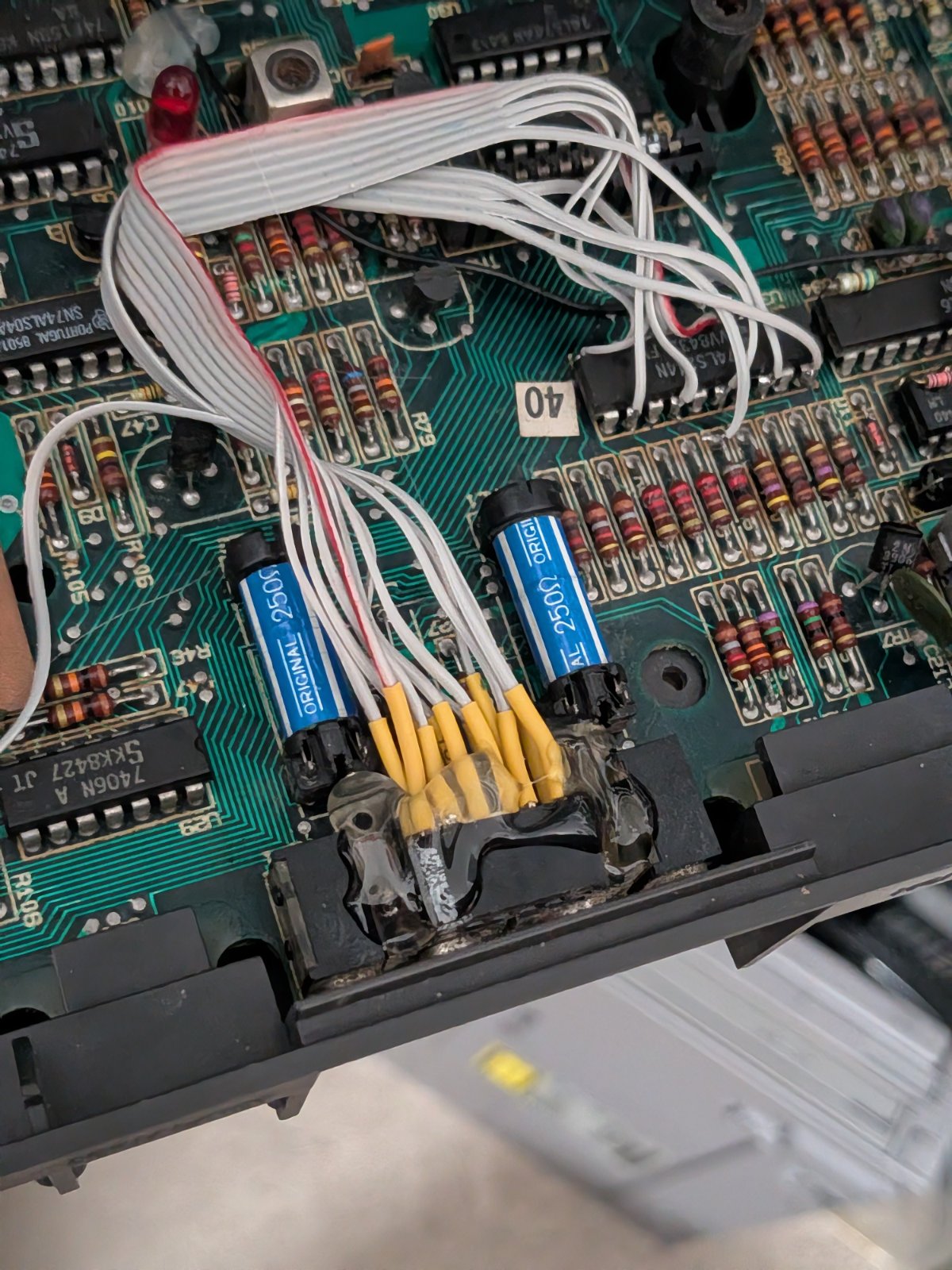

At that point I decided to re-cap the machine and sure enough every cap I removed was out of spec by a huge amount, not to mention that all had very high ESR.
Only problem is that the machine now does nothing. I have power and clock to the CPU but the data and address lines are doing nothing...
The board is poorly marked so I'm wondering if I have a cap the wrong way round...

Ok I've figured out that I did have a couple of caps the wrong way around when I went back to look at my earlier photos.
Looking at the silk screen where there are axial caps, the box has a small triangle in one corner to denote the +ve end of the cap.

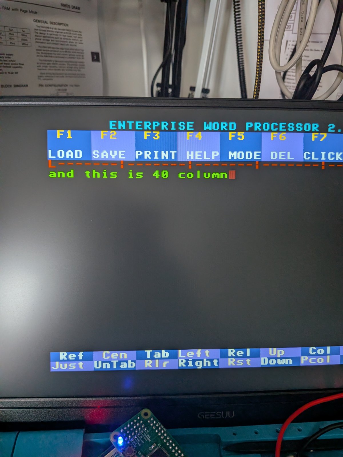

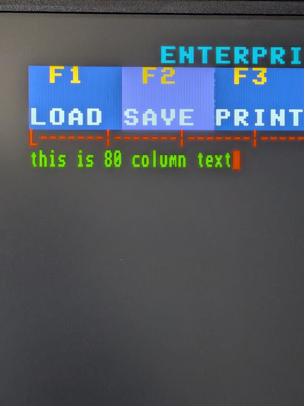

So I've been using the RGB2HDMI a bit now but it also had a shimmer and calibration didn't change anything.
However the calibration specifically states it must be a stationary screen, and neither the boot Enterprise logo, the FDD program loader are and the BASIC first boot screen doesn't have enough on screen for the calibration to be successful it would seem.
So I filled the screen up with characters using a quick basic prog and ran the calibration again. This time it seems to have been successful and the screen is nice and steady now

Nice !
You have a crystal clear screen now.
