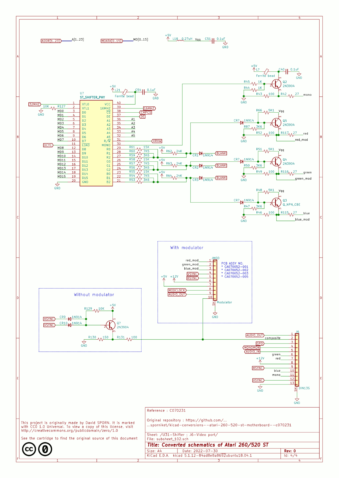

The shifter, composite with or without modulator, and the video port... I almost overlooked that the modulator get red/green/blue directly from the transistors directly, and not after the resistors like the video port.

Going on a little bit. The previous sheet was not complete, with missing numbering and one description missing.
I also reworked the layout in order to visually link Q3~Q5 to their regulated power rail instead of using a label.
