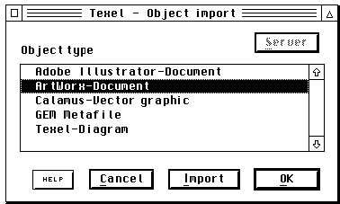

As this concept may not be familiar to all readers, first a possible example of its application: Imagine you are using your text processor and would like to enhance your document with a graphic. After placing your graphic in the text, you decide to alter it slightly. Normally you would have to switch over to your graphics program, perform the desired changes there, switch back to the text processor, discard the old graphic, then import and position the new one. But if both of the applications (i.e. graphics program and text processor) support the OLGA protocol, the solution of this task could look as follows: You switch to the graphics program, modify the graphic there, and after saving it you are finished! Because the text processor automatically recognizes that the graphic has been altered, and itself replaces it in the document!
The above example presupposes a multitasking operating system such as MagiC or MultiTOS. And in fact: Single-TOS systems are not supported by OLGA (since Rev. 1.0 - earlier versions could also be run as desk accessories.) Those wanting to involve themselves closer with the OLGA protocol should take note of the following points:

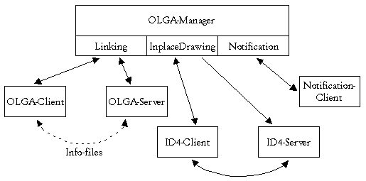

OLGA works in a document centred manner, i.e. the protocol is prepared for one application handling multiple documents (possibly even of different data-types). For controlling the object linking, use is made of a so-called OLGA-Manager (in short: Manager). Communication between the applications is transacted wholly via this Manager (which, by the way, can be present only once in the system).
The illustration below shows a simple model of OLGA communication.
The actual object linking is realized in OLGA with so-called links: these are references from the Client to data objects, or more exactly filenames with absolute path, which are saved by the Client in a document. If now the Server makes changes to an object for which a link exists, then the Client is informed of this (by the Manager), and can then update itself to display the updated object.

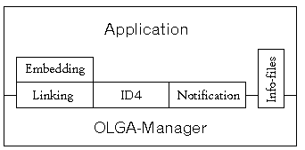

From Rev 1.2 (1996-11-20) onwards, extra functions were added and the OLGA architecture model now looks like this:
The above illustration shows the distribution of services between the OLGA-Manager and the applications using it (i.e. Client or Server). During linking, InplaceDrawing and Notification, the correct balance of communication between Manager and application for the embedding is the sole responsibility of the Client application.
Finally, the Info files are co-ordinated by the Manager but then operate directly between Server and Client applications. Schematically communcations are handled something like this:
