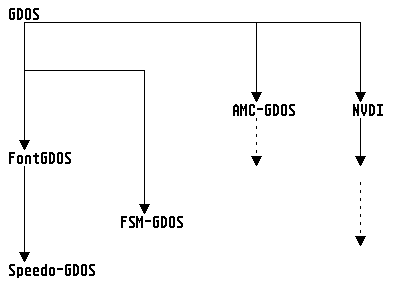

Several functions of the VDI can only be used properly after the installation of a GDOS from the AUTO folder. Basically a GDOS (Graphics Device Operating System) allows the loading of various device drivers and fonts, and then to use them.
The GDOS itself is completely independent of the device used. Only the post-loaded drivers that realize the VDI functions on the correspon- ding device are device-specific. With detailed knowledge of the driver format it is possible to use any - even exotic - output devices as a VDI output device.
With resident GDOS the number of available VDI functions increases, while all other functions remain fully functional or contain extended output capabilities. However this is not the case the other way round, functions that require GDOS lead to a crash of the computer if GDOS is not resident.
Therefore it is important to know in some cases whether a complete GDOS is installed at all. Atari has documented the following procedure for this purpose: The trap-dispatcher alters the input value -2 for register d0 only when a GDOS is installed. Many compilers make the function vq_gdos available, which returns a value of 0 when no GDOS is installed. This functions is based essentially on the following code:

The current (and more efficient) versions of GDOS are SpeedoGDOS and NVDI (as of Version 3.0), that, amid other things, permit handling vector fonts in TrueType, Type-1 or Speedo format. NVDI is also available in a special Macintosh version (NVDIMac), and permits any program that can ouput via GDOS (in conjunction with MagiC Mac) to make its output on Apple printers and in a network as well.

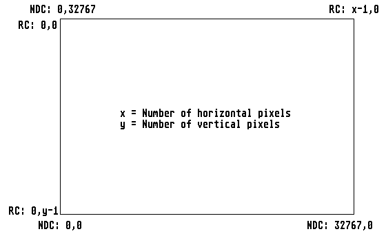

A GDOS driver always operates in a raster-coordinate system; the conversion of values in the ptsin and ptsout fields is taken on by the GDOS. In addition one should bear in mind that not all functions reach the actual driver in exactly the same form as they were sent, since they are partially pre-processed by the GDOS.

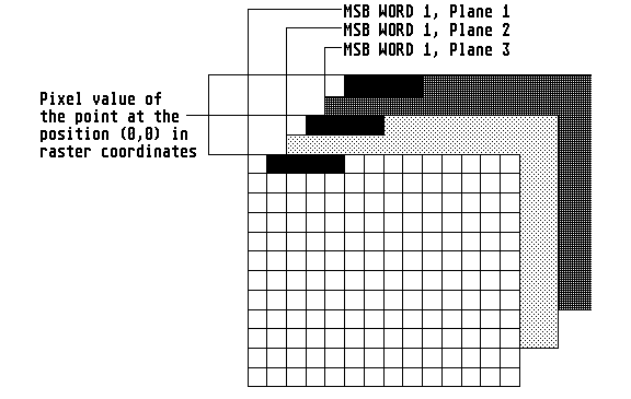

Just as for the screen, vq_scrninfo returns the format of the bitmap for printers as well. As a rule, there are only 3 different formats here:
As formats (1) and (3) will be self-explanatory, we only need to deal with format (2) here: For 8 colours, a coloured bitmap consists of 3 complete planes lying sequentially in memory. So the device-specific raster format corrresponds to the standard format. The allocation of the VDI colour index to pixel values follows the standard arrangement that applies to all VDI drivers.

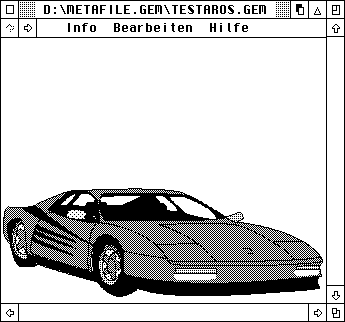

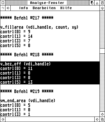

A metafile driver saves all calls directed to it in a @{GEM ignore} metafile which lies in the current directory of the application and has the name GEMFILE.GEM by default.
If one wishes to alter the name, then directly after v_opnwk call the function vm_filename, which can be passed a complete filename with the desired path and name.
So that other programs can depict a metafile sensibly, one should call the functions v_meta_extents, vm_pagesize and vm_coords.

The VDI distinguishes two different types of coordinate systems:
Raster coordinates (RC): When using this system one can
use the exact coordinate system native to the output device. For a
screen this corresponds to the available horizontal and vertical
pixels. The point of origin lies in the top left corner.
The main advantage of raster coordinates is the absolutely exact
positioning, which alone enables precise work with screen rasters
(windows etc).
Normalized coordinates (NDC): This system always has a maximum resolution of 32768*32768 points. When a device driver is called the VDI will automatically recalculate to the device's physical coordinate system. The origin lies in the bottom left corner. For working with the NDC system a GDOS has to have been installed - the screen driver in ROM can not handle NDC coordinates.
The following illustration makes the difference between RC and NDC coordinates particularly clear:
Note: In practice the NDC system is seldom used. Programs that have to offer exact dimensioning (desktop publishing, scientific graphics) must in any case use internally their own - finer - coordinate representation.
The use of the NDC system would mean that the coordinates would have to be converted twice (once from the internal representation in NDC coordinates, then to raster coordinates), which would lead to superfluous speed losses and rounding errors.

For understanding of the metafile format it can be useful to view the contents of a metafile as plain text. The tools required for this can be found in many mailboxes of the Mausnet.
Example: The illustration above shows a window of the graphics software GEM-Look, containing a vector graphic in metafile format.
The software permits, amongst other things, to have the contents of a GEM metafile displayed in plain text, and even to work through this in any desired steps.
In addition one can specify via a dialog exactly which information is to be paid regard to for the analysis, or to be output, and in what format the output should appear.
The plain text information will be displayed in a window, and can be (fully or partly) transferred to other programs via the clipboard.
Due to the fact that all commands of the output window can also be executed individually and in any desired order, it is very easy to reproduce the commands saved in a metafile.

contrl[5] = 100
intin[0] = 12
***** Befehl #15 ***** (Command #15)
vsf_interior (vdi_handle, style)
contrl[0] = 23
contrl[1] = 0
contrl[3] = 1
contrl[5] = 100
intin[0] = 1
***** Befehl #16 ***** (Command #16)
vsf_style (vdi_handle, index)
contrl[0] = 24
contrl[1] = 0
contrl[3] = 1
contrl[5] = 100
intin[0] = 1
***** Befehl #17 ***** (Command #17)
vsf_color (vdi_handle, index)
contrl[0] = 25
contrl[1] = 0
contrl[3] = 1
contrl[5] = 100
intin[0] = 1
***** Befehl #18 ***** (Command #18)
vsf_perimeter (vdi_handle, per_vis)
contrl[0] = 104
contrl[1] = 0
contrl[3] = 1
contrl[5] = 100
intin[0] = 1
***** Befehl #19 ***** (Command #19)
v_write_meta (vdi_handle, num_ints, ints, num_pts, pts)
contrl[0] = 5
contrl[1] = 0
contrl[3] = 7
contrl[5] = 99
intin[0] = 34
intin[1] = 3
intin[2] = 1
intin[3] = 42
intin[4] = 42
intin[5] = 42
intin[6] = 42
***** Befehl #20 ***** (Command #20)
v_bez_on (vdi_handle)
contrl[0] = 11
contrl[1] = 1
contrl[3] = 0
contrl[5] = 13
***** Befehl #21 ***** (Command #21)
contrl[0] = 104
contrl[1] = 0
contrl[3] = 2
contrl[5] = 13
intin[0] = 1
intin[1] = 1
***** Befehl #22 ***** (Command #22)
contrl[0] = 25
contrl[1] = 0
contrl[3] = 1
contrl[5] = 13
intin[0] = 2
***** Befehl #23 ***** (Command #23)
contrl[0] = 23
contrl[1] = 0
contrl[3] = 1
contrl[5] = 13
intin[0] = 0
***** Befehl #24 ***** (Command #24)
contrl[0] = 24
contrl[1] = 0
contrl[3] = 1
contrl[5] = 13
intin[0] = 0
***** Befehl #25 ***** (Command #25)
vsl_color (vdi_handle, index)
contrl[0] = 17
contrl[1] = 0
contrl[3] = 1
contrl[5] = 13
intin[0] = 3
***** Befehl #26 ***** (Command #26)
vsl_width (vdi_handle, width)
contrl[0] = 16
contrl[1] = 1
contrl[3] = 0
contrl[5] = 13
ptsin[0] = x = 1
ptsin[1] = y = 0
***** Befehl #27 ***** (Command #27)
contrl[0] = 104
contrl[1] = 0
contrl[3] = 2
contrl[5] = 13
intin[0] = 1
intin[1] = 1
***** Befehl #28 ***** (Command #28)
vsl_ends (vdi_handle, beg_style, end_style)
contrl[0] = 108
contrl[1] = 0
contrl[3] = 2
contrl[5] = 13
intin[0] = 0
intin[1] = 0
***** Befehl #29 ***** (Command #29)
v_bez (vdi_handle, count, xyarr, bezarr, minmax, npts, nmove)
contrl[0] = 6
contrl[1] = 17
contrl[3] = 9
contrl[5] = 13
ptsin[0] = x = -2125
ptsin[1] = y = 100
ptsin[2] = x = -708
ptsin[3] = y = -441
ptsin[4] = x = 237
ptsin[5] = y = 640
ptsin[6] = x = 1654
ptsin[7] = y = -981
ptsin[8] = x = 237
ptsin[9] = y = 640
ptsin[10] = x = -1180
ptsin[11] = y = 2261
ptsin[12] = x = 2127
ptsin[13] = y = 1723
ptsin[14] = x = 2127
ptsin[15] = y = 100
ptsin[16] = x = 2127
ptsin[17] = y = -1522
ptsin[18] = x = -708
ptsin[19] = y = 100
ptsin[20] = x = 237
ptsin[21] = y = -981
ptsin[22] = x = 1182
ptsin[23] = y = -2062
ptsin[24] = x = -2124
ptsin[25] = y = -2601
ptsin[26] = x = -2597
ptsin[27] = y = -1522
ptsin[28] = x = -3070
ptsin[29] = y = -441
ptsin[30] = x = -1653
ptsin[31] = y = -440
ptsin[32] = x = -2125
ptsin[33] = y = 100
intin[0] = 2344
intin[1] = 4112
intin[2] = 4105
intin[3] = 2320
intin[4] = 4112
intin[5] = 4105
intin[6] = 2320
intin[7] = 4112
intin[8] = 12
***** Befehl #30 ***** (Command #30)
v_bez_off (vdi_handle)
contrl[0] = 11
contrl[1] = 0
contrl[3] = 0
contrl[5] = 13
***** Befehl #31 ***** (Command #31)
contrl[0] = 104
contrl[1] = 0
contrl[3] = 2
contrl[5] = 13
intin[0] = 0
intin[1] = 0
// Ende der Analyse
// GEM-Look, (c) 1994/95 by Rolf Kotzian

The VDI standard format is defines as follows:
The format is plane-oriented. Each image plane occupies a contiguous block of memory, and has the same number of image points.
The highest bit of a 16-bit WORD represents the furthest left pixel
Sequential words in video memory form the individual lines. The first WORD of such a line lies at the left image border; the first line of the plane codes the topmost pixel line.
The following figure shows an example for the device-independent standard format with 3 colour planes, where each small square represents a pixel:
Warning: In the monochrome graphics modes of the ST and TT030, the device-dependent format happens to (!) correspond to the device- independent one (i.e. the standard format). This does not mean, of course, that one may therefore dispense with the use of the vr_trnfm function. As one normally has no information about the device-specific format, this reason alone forbids any direct manipulation of the video memory.
