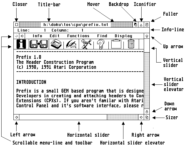

8.9.4 wind_create
Name: »Window create« - Initializes a new window
Opcode: 100
Syntax: int16_t wind_create ( int16_t wi_crkind, int16_t wi_crwx, int16_t wi_crwy, int16_t wi_crww, int16_t wi_crwh );
Description: The call wind_create attempts to initialize a new window structure with the AES and at the same time determines its appearance and maximum size; it also allocates the memory required for it. Note that this call does not actually display the window on-screen - you need to follow it with a wind_open call for this.
wi_crwx, wi_crwy, wi_crww, wi_crwh set the maximum extent of the window.
wi_crkind describes the components as a bit-vector:
Element Value Meaning
NAME 0x0001 Title-bar
CLOSER 0x0002 Close-box
FULLER 0x0004 Fuller-box
MOVER 0x0008 Window may be moved by user
INFO 0x0010 Info-line
SIZER 0x0020 Sizer-box
UPARROW 0x0040 Up-arrow
DNARROW 0x0080 Down-arrow
VSLIDE 0x0100 Vertical slider
LFARROW 0x0200 Left arrow
RTARROW 0x0400 Right arrow
HSLIDE 0x0800 Horizontal slider
HOTCLOSEBOX 0x1000 Close-box with auto-repeat
MENUBAR 0x1000 Menu bar (XaAES)
BACKDROP 0x2000 Background-box
ICONIFIER 0x4000 Iconify-button
BORDER 0x8000 Border sizing
Notes: HOTCLOSEBOX is only available as of PC-GEM or MagiC Version 2.0 (in each case). Window borders that are not needed (e.g. bottom border) will be omitted as of AES Version 4.x or MagiC 3; this makes available a few more pixels of usable area.
MENUBAR is only available in XaAES. It reserves room for a menu bar widget in the window. The menu bar itself is attached to the window by wind_set.
Setting BORDER will make XaAES allow for window border sizing without the SIZER widget being used.
ICONIFIER is available only as of AES Version 4.1.
The presence of newer components such as the iconify button, for instance, is best inquired for by using appl_getinfo (opcode 11).
Return value: The function returns a non-negative handle if the AES still has a free window handle available. A return value smaller than 0 (i.e. negative) signals an error or no more free handles available.

WF_COLOR (18) This mode alters the colour of a window component. For this the index of the component is specified in wi_sw1:
Element (Value) Description
W_BOTTOMER (20) Backdrop button
W_BOX (0) Window's root object
W_CLOSER (2) Close-box
W_DATA (6) Parent object of the remaining components
W_DNARROW (11) Downward arrow
W_FULLER (4) Zoom-box
W_HBAR (14) Parent object of the vertical slider components
W_HELEV (18) Horizontal slider
W_HSLIDE (17) Background of the horizontal slider
W_INFO (5) Info-line
W_LFARROW (15) Leftward arrow
W_NAME (3) Move bar
W_RTARROW (16) Rightward arrow
W_SIZER (8) Size-box
W_SMALLER (19) Iconifier button
W_TITLE (1) Parent object of the close & zoom boxes, also the name
W_UPARROW (10) Upward arrow
W_VBAR (9) Parent object of the vertical slider components
W_VELEV (13) Vertical slider
W_VSLIDE (12) Background of the vertical slider
W_WORK (7) Working area
The colour for the object type of the window component is passed in parameter wi_sw2 if the window is topped, in wi_sw3 if it is inactive. A value of -1 retains the current colour setting.

8.9.15 The components of a window
The following illustration shows the window of a GEM text editor, and describes the most important components of this window.
Note that the clickable 'buttons' use characters from the system font, and may look different if a substitute system font is in use.
When the Closer of an application window is clicked on, the window will close and its contents will be discarded; if it allows user input (text editors, graphics programs, spreadsheets ...), any changes made to the contents since the last 'Save' operation are lost. Most well- behaved applications warn the user with an alert about this and give a final opportunity to save the changed contents.
When the Closer of a desktop window is clicked on in TOS, it will display the next-higher directory level, or, if already showing the root directory, close the window; some alternative desktops such as MAGXDESK, Jinnee and Thing offer the option to either behave in the same way, or can be set for the Closer to shut the window immediately from any directory level - they use a 'parent' widget at the top of the window to move to the next-higher level.
The Title-bar shows the full path to the current directory (in a desktop window) or to the current file (in an application's window). It may also show other details, such as the current cursor position etc. (if the window does not have an info-line).
The Mover allows the whole window to be moved by clicking and holding down the left mouse button while dragging the outline of the window to a new position.
The Backdrop button is only present in MagiC and similar system extensions. If several windows are open, clicking on it places the window at the bottom of the 'stack', permitting rapid cycling through the windows.
The Iconifier button is only present as of AES Version 4.1 and later MagiC versions. When clicked on, the window is shrunk to a large icon at the bottom left of the screen, carrying a suitable identity label. If several windows are iconified, their icons will be ranged next to each other. A double-click on the icon will restore the window to its former position and size.
Clicking on the Fuller enlarges the window to fill the screen. A second click restores the former size.
The Info-line provides various items of information about the window's contents. In applications it is optional and must be provided by the running program. This also applies to the menu-line (may be scrollable if too long to fit the window) and the toolbar.
When one of the four arrows is clicked on, it scrolls the contents in the appropriate direction by one line or column if the contents exceed the current width and/or height of the window. This action repeats if the mouse button is held down.
The width of the sliders indicate what portion of the total contents is being displayed on the screen in comparison with the shaded area in the two elevators representing the off-screen portions. Holding down the left mouse button and dragging the slider allows the window's contents to be scrolled quickly in the relevant direction.
Clicking in the elevator area scrolls the contents by one screen height or width; this too repeats if the button is held down.
Clicking on the Sizer and holding down the left mouse button allows dragging the window to a new size. During this the outline of the window appears dotted as an aid to placement. The top left corner remains in position.
See also: Window library
