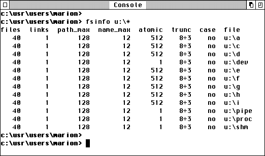

To obtain information about the underlying file-system, one should use the GEMDOS function Dpathconf.
The above illustration shows the limitations of a pure TOS file system for the various drives. The column files specifies the maximum number of files that may be opened per process (apart from process-internal limits). Under links one can see the maximum number of links to a file that may exist. path_max shows how long complete filenames (including the path) may be on the file-system. The column name_max shows the maximum length of a filename, and under atomic is specified how many bytes may be written per write operation. The column trunc is specially important, showing how over-length filenames will be truncated. Finally, under case one can tell whether and how filenames with mixed capitals and lower case will be supported.
The rule of thumb is: Always continue using filenames and paths exactly as they were presented by the operating system; basically, write filenames in lower case, as even on systems with mixed capitals and lower case, filenames in capitals are rather the exception!
