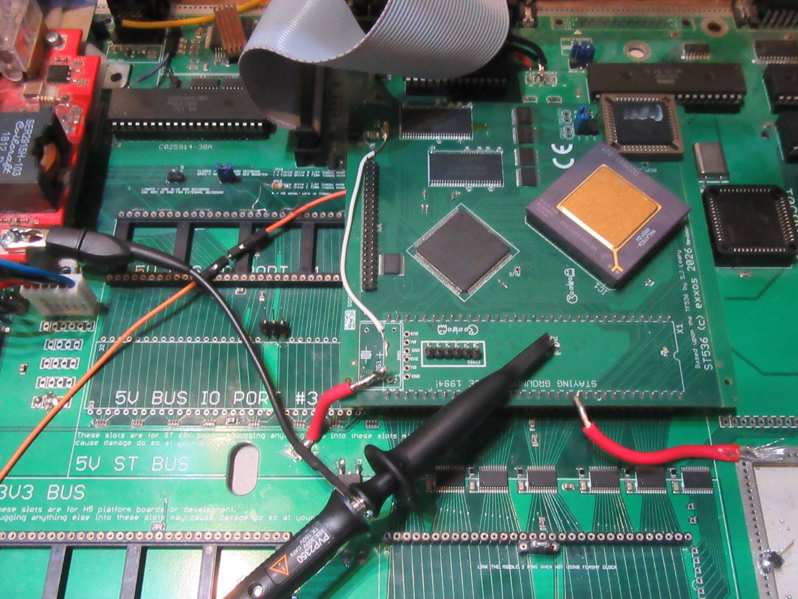

Meanwhile, the only thing I could do was try and solder some wires to improve the grounding which isn't really easy.. The length of the new ground wires is a order of magnitude longer than the path from the headers to ground.. but oh well..
But the interesting thing is, while the spikes are only like 0.1V less, the ringing is a LOT less now.

Had a thought.. (Yes is was painful) That the bus enable is happening at the worst time really. So I've added a 150ns delay on it as it doesn't matter for 8mhz anyway. So It now shifts that oscilation further away from the main bus transition oscilation. It was pushed to do 5 full GB6 passes before. Now it's just ticked over to pass 34.. Will leave it on overnight.. I don't expect it to keep going but it seems to be a step in the right direction.
I've added series resistors onto the next revision of the PCB. Not sure what value I'll use yet. The resistor PCB I think had 100R on there. So should be a good starting point. All signals have the resistor. So like 60 signals now with 100R in series.. That's gotta be significantly lower gnd bounce... Be interesting to see what the bounce will look like after that lot.. Even a 50% reduction would be great.

Need my JLC boards to come next so I can see about reducing gnd bounce. Ironically, the adapter PCB will make the gnd length several times longer than it is now. So they will aggregate the issue.. But I hope the peek gnd current will be significantly lower and counteract that..
