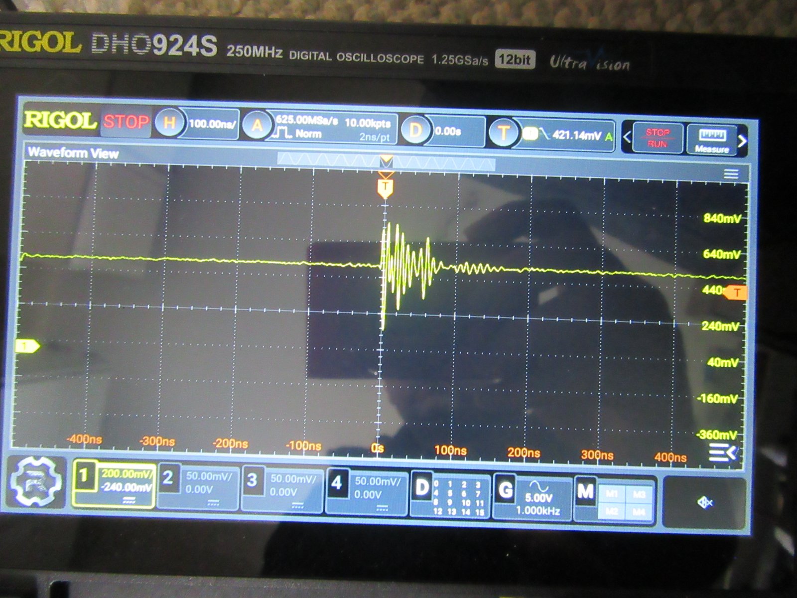

Was watching the scope like a hawk during various tests trying to see if ground bounce was in the mix. Indeed am seeing like 0.5v spikes which is a little worrying. Probably the 2 GND pins on a 68K socket isn't the best. The nothing much can be really improved because the H5 and ST536 has solid ground planes anyway.
What was a little surprising was that the noise was significantly less during STram, TTram cycles. It seemed to be worse during VDI enquire test but it was a really terrible anyway.
The other thing is it seems to have a "solid high" on the reset line then intermittently goes into noise pulses about ever 1-2uS then rings around 80mhz. But those 1uS pulses are not always there. When they are, the ringing isn't generally that bad anyway. But maybe there's some weird resonance going on between the H5 and ST536.
I'm going to add a few more caps on the 5V rail on the next gen boards to try and clamp the HF ringing better, though not much else can be done. Likely legislation would be better grounding between the 536 and motherboard, So I may add some exposed copper for soldering GND wires on like I did on the STE536 just in case..

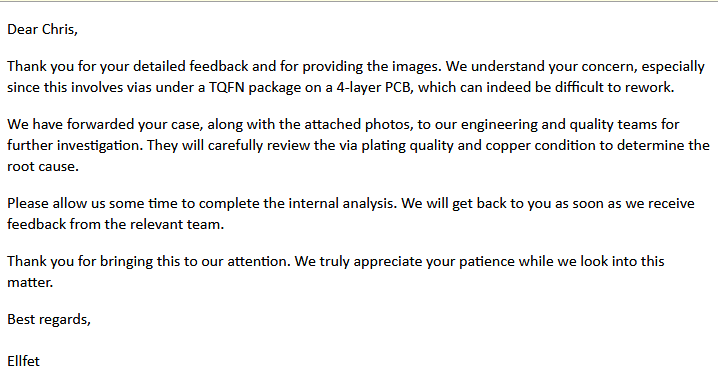

Did not take long to find a problem with one of my R5.62 boards..
The highlighted trace is A1. It traces from the 536 ROM, to the CPU, to the PLD, then nothing to A1 on the 68K header pins.. My money is on that via !
Scratch the way the solder resist and there is continuity between the header and at least that part of the via. Though I basically lose it underneath the PLD at that point :(
Time for some bodge wire...
:girldance: :girldance:
So JLC strikes again with bad vias :roll: I'm going to have to moan at them about all this! But probably be pointless anyway. :roll:

JLC email away....

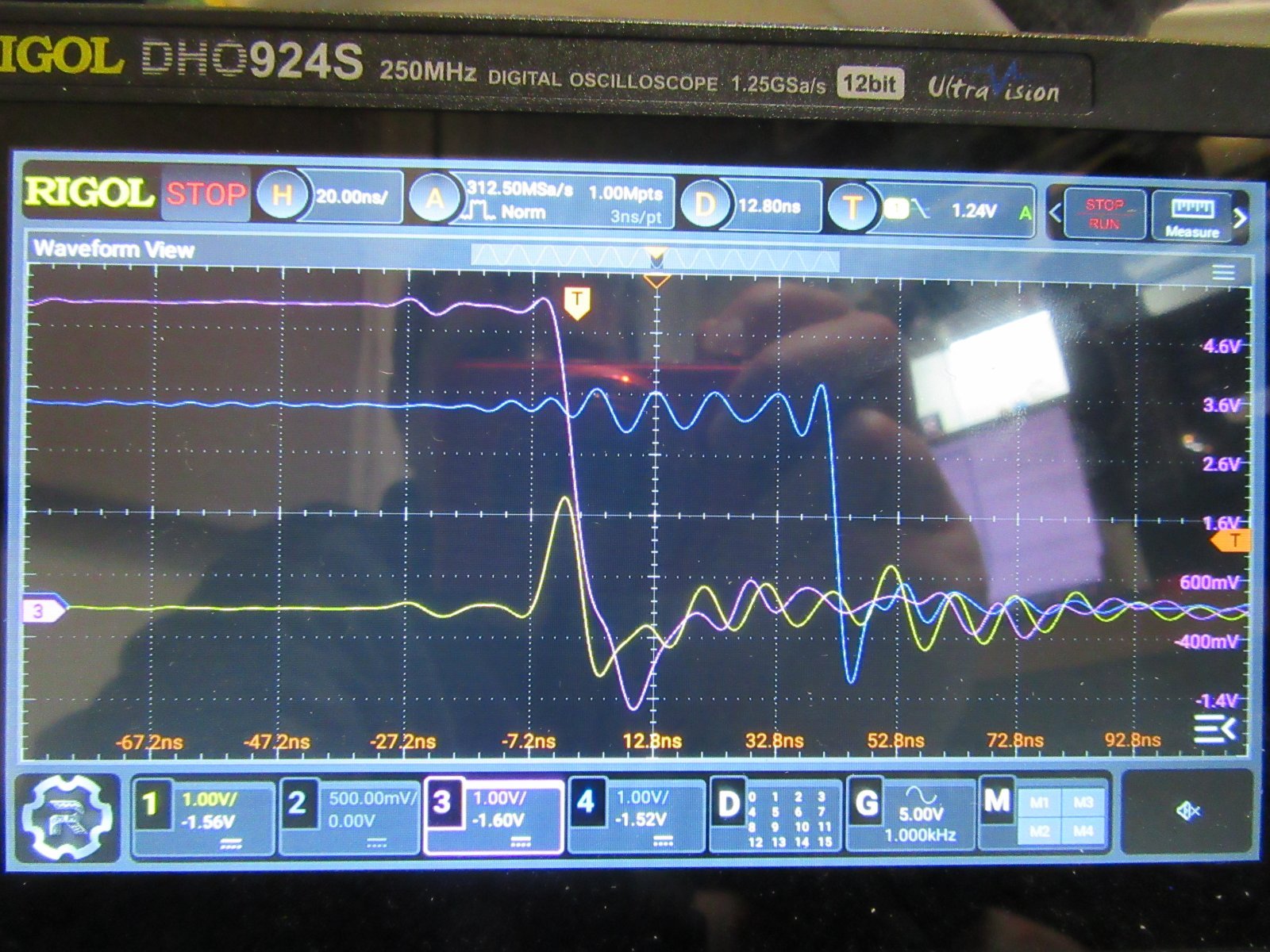

Made another discovery. Seems there is very bad ground bounce in particular when address or data line switch :roll:
PINK Data bus H5
YELLOW - GND
BLUE - BUS EN
Grounds were measured between the H5 PSU GND and ST536 GND. Incidentally the original TF536 actually has it worse. There is not much socket wise in the current stackup either.
It reminds me of problems I had right at the beginning on my 68000 boosters. Where under the PLCC 68K CPU was 2V ground bounce between CPU GND pins !
The redline just basically shows the ground current path between CPU pins.. That was literally all it took!
The DIP 68K pinout simply does not have enough grounds :roll:
The only workaround is to pass the whole data and address bus through something like 100R resistors to reduce the current through the GND. So I think there will be no more progress on this project for a few weeks because I have to design a patch board and wait for it to be manufactured and then repeat tests. :roll:
