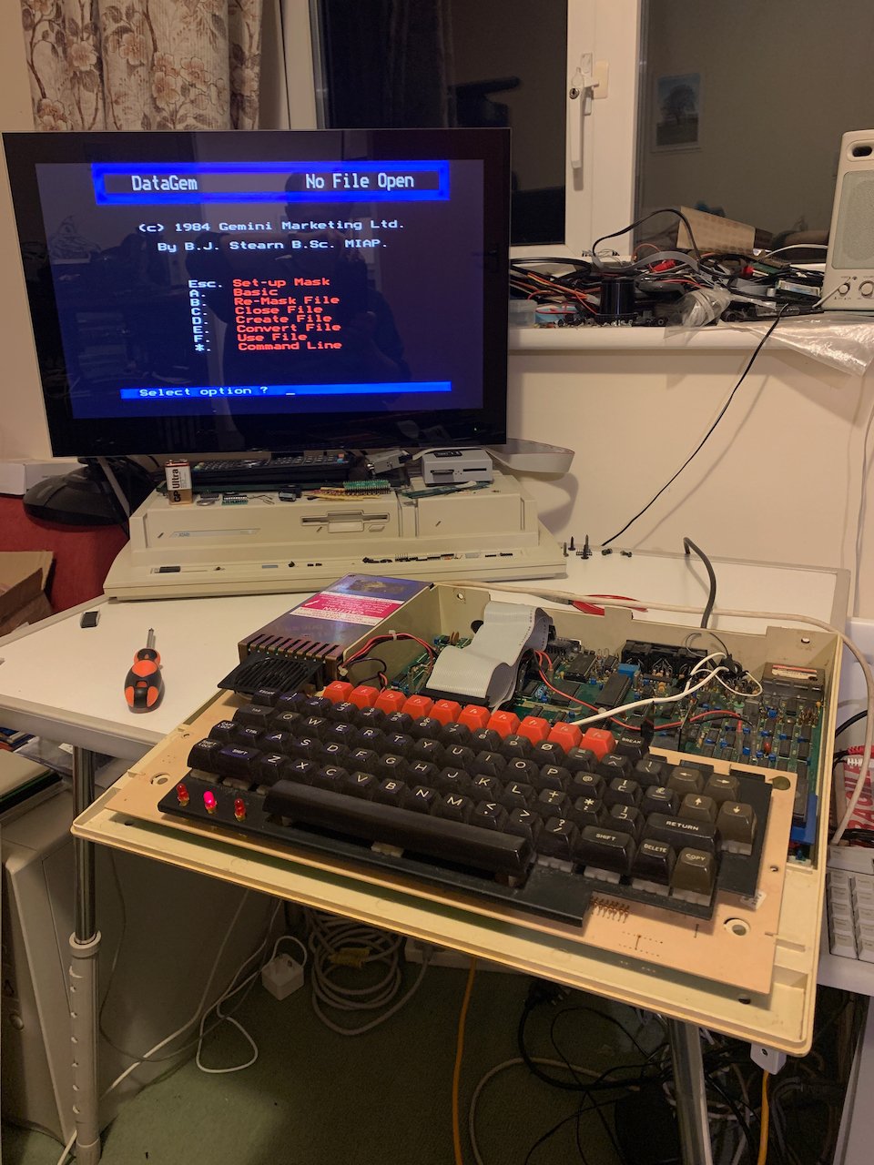

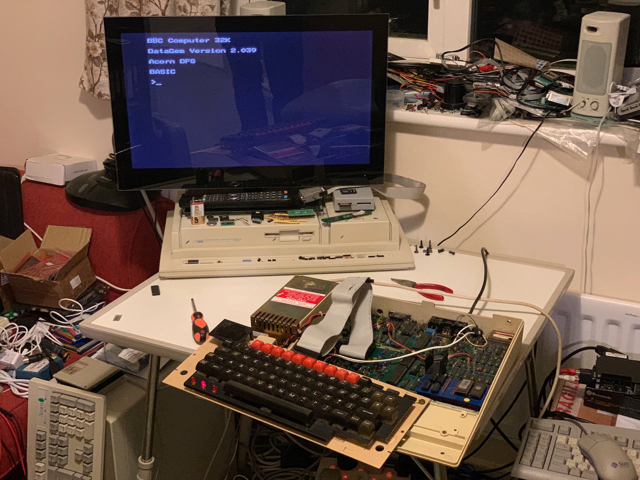

I had a bit of energy this evening and so thought about going back to something I've had in the background for years.
Probably about 10 years ago, whilst renovating a BBC Micro which had the "DataGem" database ROM installed I accidentally installed the DataGem PCB into the ROM socket backwards as there was no orientation marked upon it. When I turned on the Beeb, well, you get the picture.
At the time I left it for dead and put it on a shelf. During lockdown I saw the PCB and thought I'd have a look at it. I first removed the EPROMs and tested that I could read them (there are two plus four other chips), they worked.
So, now to the other logic chips. The software company had sanded the markings off all four of them but I was able to make out enough on three of the chips that they were 74LS133, 74LS02 and a 74LS00. The fourth chip was completely blank. I desoldered them all and tested all the chips I could identify and they all checked out. This meant that the one chip I couldn't identify was obviously the one which was killed! Typical!
Anyway, tonight I thought I'd take another look and try to work out what this other chip could be using the traces on the single-sided PCB. The more I looked the more it looked like triplets of inputs/outputs, very similar to the 74LS00. Of course I couldn't guarantee that it was a quad NAND gate.
So, I stuck it into the 266 EPROM programmer and tested the chip against every 14 pin 72LS chip in the database. The closest match, with one error, was the 74LS00. It looked like channel 1 was constantly high.
Searching my chip stock (how have I got so many 244s and 245s?!) I found some LS00s, just a few... Phew!
I soldered sockets in and put the three known good original chips in and a new 74LS00.
I got my original, trusty Beeb down from its place on the back of the sofa-bed, tested that it still worked, fitted the PCB and switched on... Boo-Bip! Yay!
Not only that but...
And it does indeed work!
Anyway, I'm not sure what I'm going to do with it, but I do know that it's operational now.
