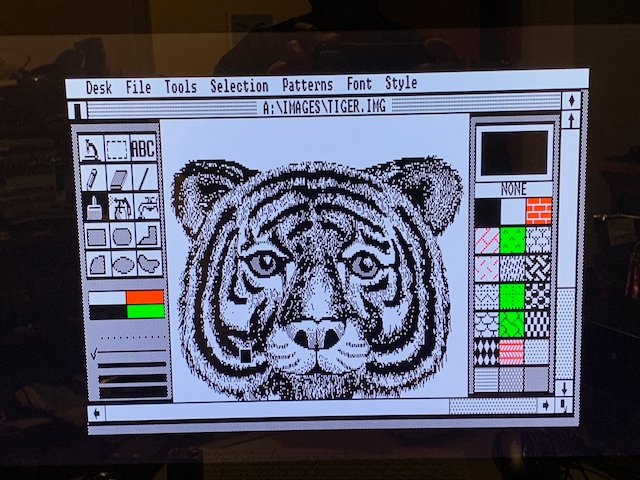

Of course it's traditional to load GEM Paint and TIGER.IMG
